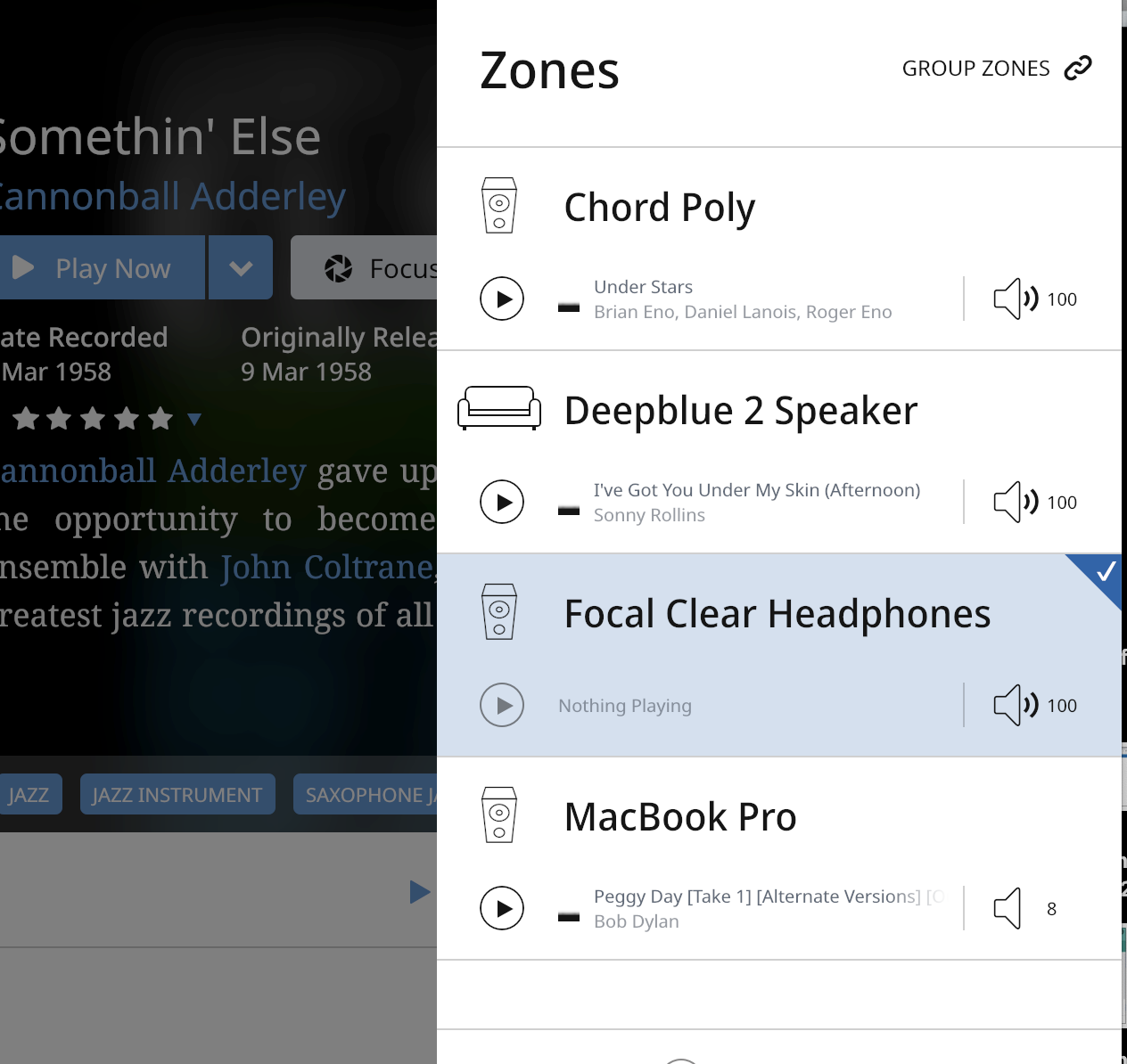

Can’t say that I follow all of the guidance. Mojo was enabled and I have successfully used that (my main listening scenario). I renamed and enabled the headphones (it was not enabled before). After doing so, the new Focal Clear is grayed (may be hard to see it in the attached) out and I am unable to select it.
I’m not certain what is the “System Output” zone. I assume that it is another zone in addition to those that are in current use.
Please advise.
The zone that you have labeled “Chord Poly” is the System Output zone on the Mac. You can confirm that by clicking on the gear icon and then selecting device set setup. If you set that zone in Roon, you should be able to play from on board Mac speakers or headphones.
That is so wild, and not as intuitive as I would have thought (BTW, it works!).
I would not have thought to select the system output to the Poly, especially when I was not using the Poly. That is why I initially selected the Mac, figuring that the Mac is the output (which it is for the Mac speakers) and the headphones connected to the Mac.

BTW, you can change the labels on the devices by clicking on the pencil icon.
Hi @David_Weinberg,
As @Peter_Deschamps noted, you can change the zone name by clicking on the Pencil icon, I suspect you might have accidentally changed that zone name in the past from the default of “System Output”. In any case, happy to hear you sorted the issue out!
That clears things up. After I followed Peter’s guidance, I then saw two Chord Polys under Settings / Audio. It was also why I was confused that selecting the Poly would allow me to use the Mac headphone output (when the Poly was not in use). But, to Peter’s credit as I said yesterday, it worked.
Once you suggested that I may have edited the zone name from System Output to Poly (the one under the MacBook, not the Roon Ready Poly) then I understood why I have two Poly settings and why the top Poly worked regardless if the Poly was in use.
I changed it back to System Output and will use that as my non-Poly default.
