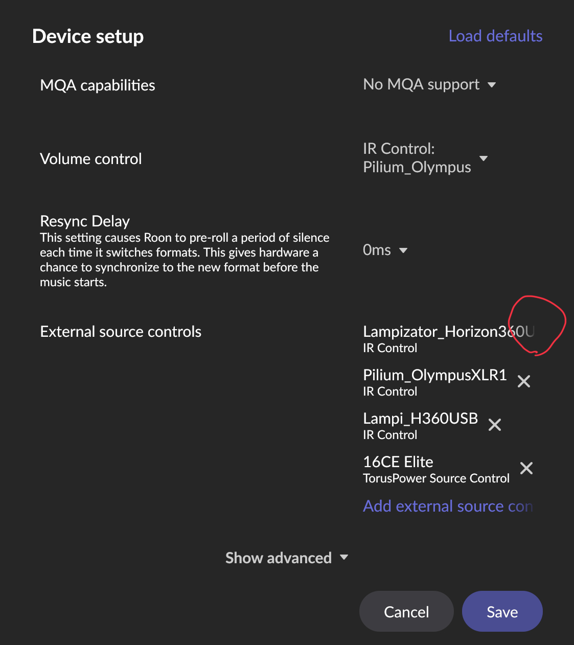

I have created an extension with source control. Later I have realized that the name was too long, so I changed it. However in the zones where I have already assigned it with long name I am not able to remove it. The UI is hiding the X button. This source control is no longer registered in Roon, but it still appears on the impacted zones. Is there some way to delete this ‘zombie’ source control?

Thanks Benjamin, you were right spot on. I just adjust a a bit the procedure and did not delete all the files in Registry/Core, but only the ones that mentioned the long name of the source control.
This way I did not have to re-enter credentials.
The zombie source control is now gone.
