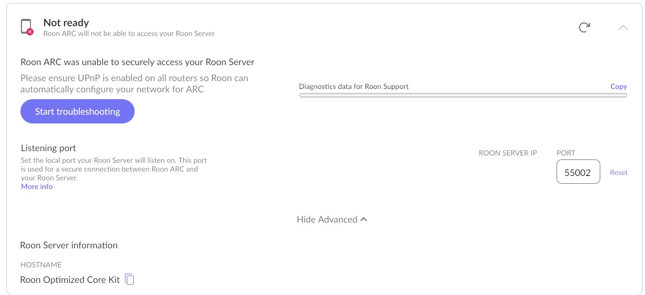

· I am having issues doing my initial setup for Roon ARC. I am getting “Not Ready”, “Roon ARC was unable to securely access your Roon Server” messages in my Roon ARC settings page. Some background:
My ISP is Verizon. I run a Verizon router in bridge mode as my internet connection point with a TP-Link BE 19000 router sitting behind the Verizon box serving as my router and providing NAT services. UPnP is “not” enabled on my router/network and I prefer not changing that setup. I have manually setup a port forward rule on the TP-Link to forward port 55XXX which matches the Listening Port setup in my Roon Settings. All protocols are allowed via 55XXX.
Note: I would go through the additional Diagnostic Data but when I try to copy that the operation fails with a “Failed to copy to clipboard” message. I am not sure how to address that problem and/or if there is an alternative method for viewing Log/Diagnostic data.

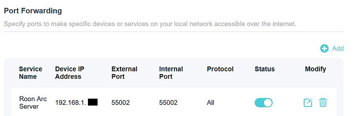

Here’s a screen shot of the port forwarding rule I added in my Router:
I usually see the same (empty) diagnostics data as you show here – because I disabled port forwarding in Roon. Maybe it’s the same reason for you? Click on Reset behind the port number input field to enable port forwarding in Roon again.
Note: You may have to set the correct port number for you again after the reset. Please check.
Thks…Tried several Roon resets…port didn’t change…and didn’t fix the issue.

Hi @Michael_Ashwell,
Are you having any difficulty connecting to this ROCK in the Roon app itself? What about reaching ARC on WiFi, not cellular?
Your initial screenshot shows that the Roon Server IP address hasn’t populated in the Settings → ARC page. That might be a transient startup state (if it eventually populates later), but it’s probably the reason that the dialog snippet is blank and the copy subsequently fails. In fact, if ROCK hasn’t successfully bound to the IP interface, this would cause the problem in the first place.
Please try rebooting the ROCK and closing/opening ARC itself.
