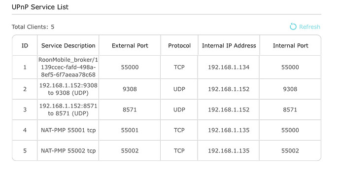

I attached a screenshot of the clients listed on the UPnP page of my router. The 5th one on port 55002 appeared once I changed the port. I’m pretty sure the 2nd and 3rd clients are my NAS drives but I am not sure what 1 and 2 are. Does this illuminate the situation at all?

In your screenshot, it appears that both NAT-PMP and UPnP are both enabled in your router. I suspect before you “Reset” the autoconfiguration, these services were competing for the same port range. Both UPnP and NAT-PMP are pre-installed router services that assist with autoconfiguration of port forwarding, but you won’t need both activated. Since you’ve mentioned Port 55002 gave the successful “Ready” result in Settings → ARC, I recommend keeping that enabled for now.

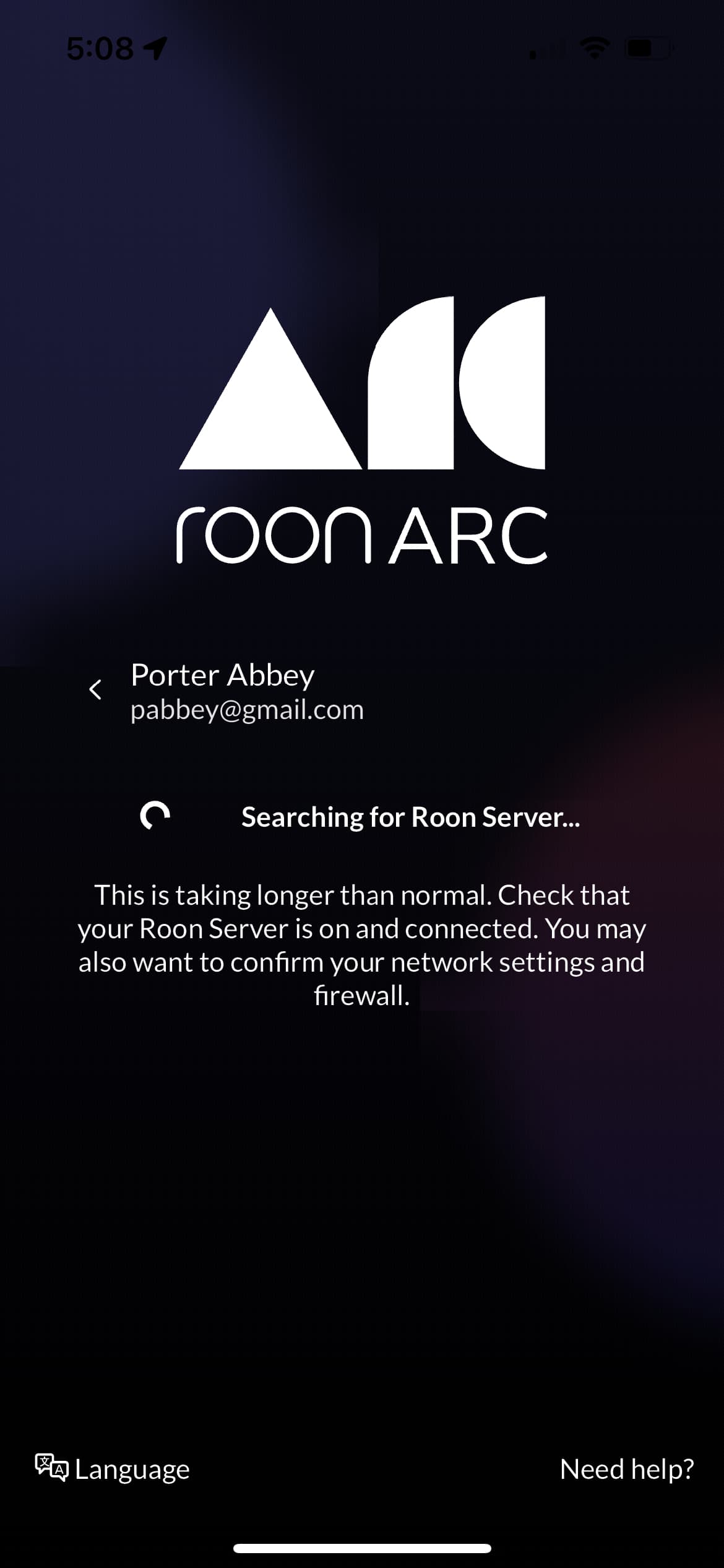

Thanks for that, Connor. I can connect to the RoonServer machine on WiFi with the Roon Remote app. When I try to connect to ARC on my phone, it never gets past the “Searching for Roon Server…” screen as shown in the screenshot.

I deleted and reinstalled ARC on my phone and it now works! Thank you all for your help.
