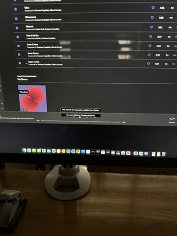

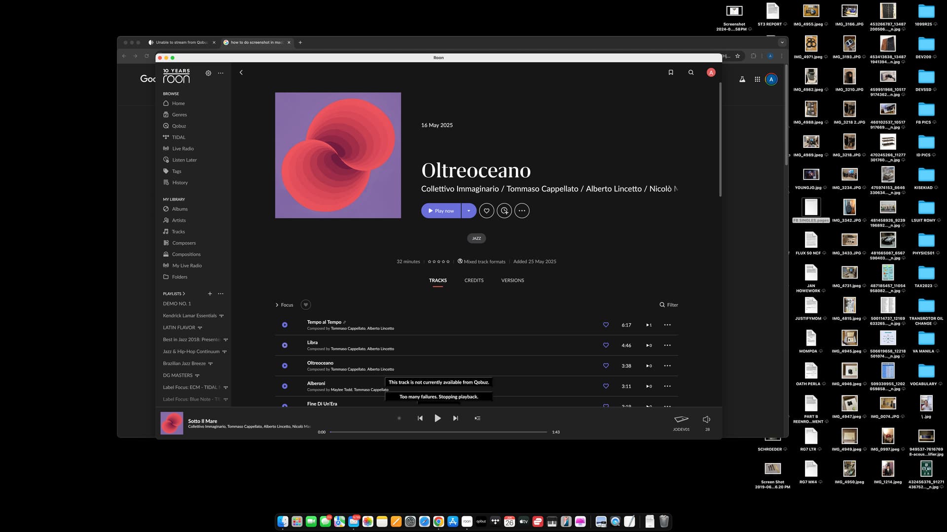

I'm unable to stream any title or content from Qobuz. Tidal is fine. I just updated my firmware to Version 2.52, Build 1538. Please help. No music, no life.
Roon Nucleus Plus connected or wired directly to a Devialet Expert 200, Huawei Router/Modem. Everything was fine before the latest update (Version 2.52, Build 1538). Please help. No music, no life. My Qobuz subscription is current and I'm able to play or stream any Qobuz title on my laptop and mobile phone. The glitch is obviously within the Roon firmware.
I can’t read what the error message says on your screenshot. It is completely unreadable here even when zooming in all the way with ctrl + scrolling. How did you upload this image, as when I try to open in it in a new tab window it wants me to save the file locally?

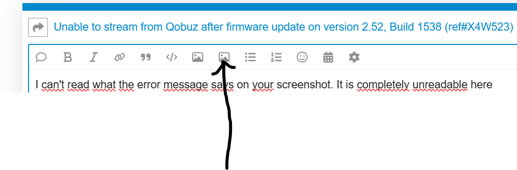

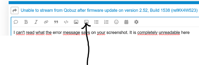

The easiest way to attach screenshots is by using this button when you’re in the message editing window.
It makes the image clickable and much easier to see what’s on it :slight_smile:

I highly appreciate your assistance to resolve this matter. Every time I try to stream or play any song from Qobuz in Roon, the following messages pop-up; “This track is not available from Qobuz.” and “”Too many failures. stopping playback.” I have tried the following to no avail: turned off and on Nucleus Plus, logged out of and logged back in Qobuz in Roon, turned off and on router. None of these actions fixed the problem. Still unable to stream any song or content from Qobuz.

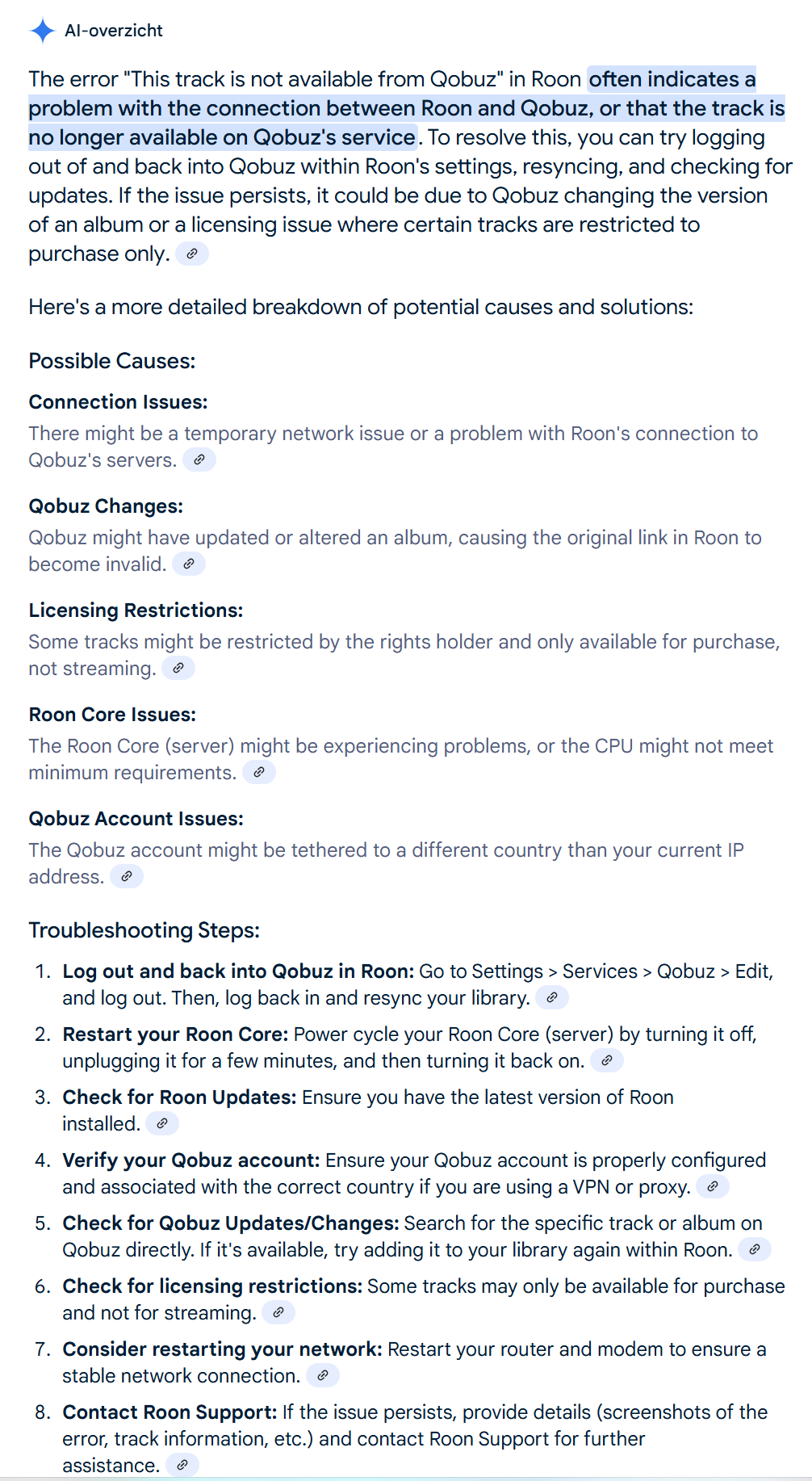

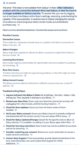

I’ve received this as an AI answer after asking Google “this track is not available from qobuz message in roon”

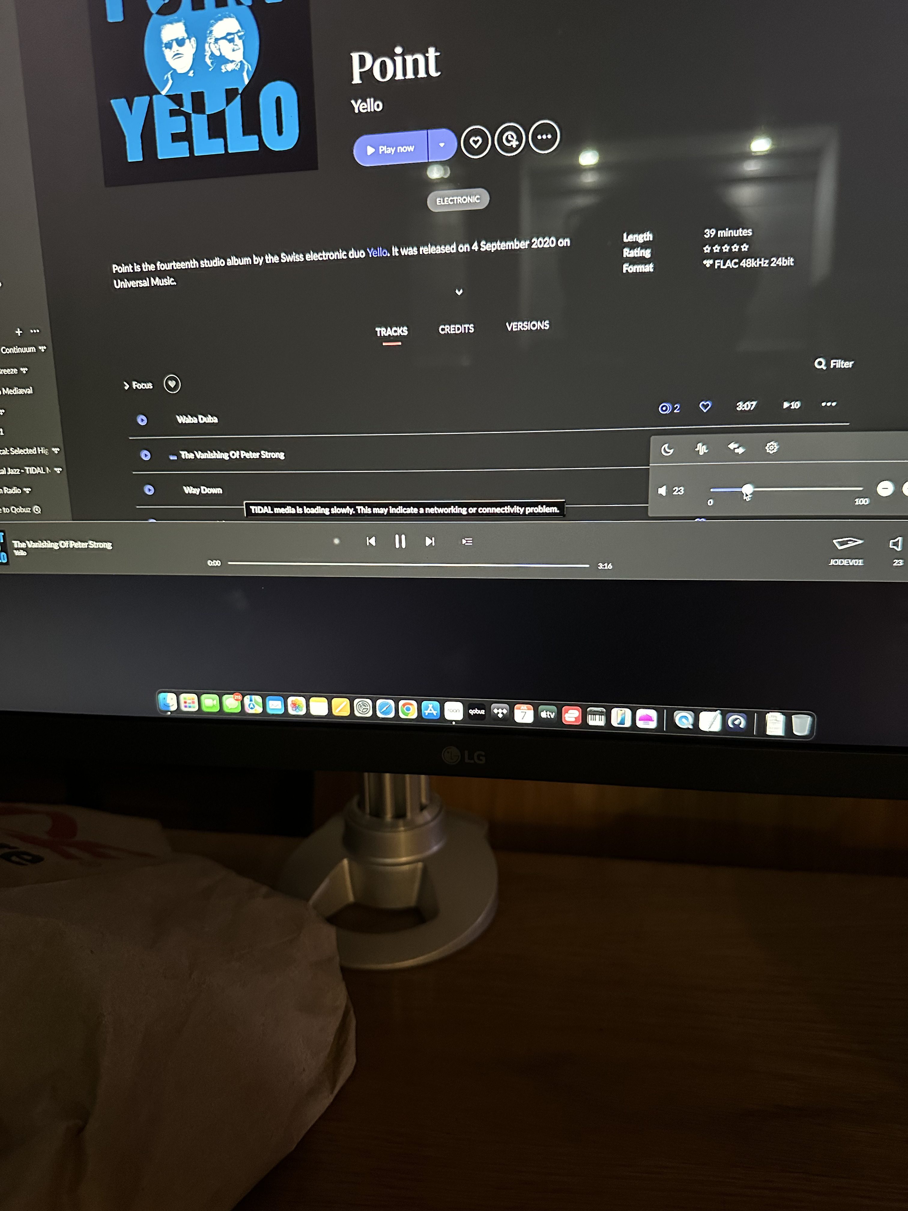

I am about to lose my $#@&! The problem with Qobuz persists. Now, I’m having problems with Tidal! Could not even finish a song without the following message popping up: “TIDAL media is loading slowly. This may indicate a networking or connectivity problem”. There is no connectivity problem, Qobuz and Tidal apps play fine by themselves. No Qobuz, no Tidal! Arrrggghhhh! Please help. Regards, Agustin
Here’s the screen shot with the pop up message.

Sorry to hear about the ongoing issues. I tried to activate diagnostics on the unit but it doesn’t seem to be responding to diagnostic requests at the moment. Is the unit still online? Or if not, can you please let us know the next time you use it so that we can check the logs for clues?
Have you had any luck changing the DNS server? Does the same issue occur if you try to use your Laptop as a Roon Server, or does the issue only happen with the Nucleus? Please let us know so that we can focus our troubleshooting efforts better, thank you!
