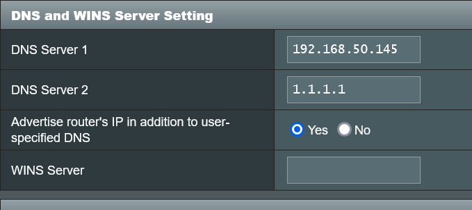

For this particular issue, could the DNS cache for the NUC be corrupted?

I recently rebuilt my PiHole/DNS Server (after Roon radio quit streaming and not because of the Roon issue). The PiHole has a static address. There were a couple times since then the internet quit loading/streaming and an error message came up that the private DNS server failed. I updated the Pi OS and the PiHole software, have not seen that issue since. I do have a secondary DNS configured
DNS and WINS Server
, see attached.
My personal opinion has been something in the ROCK would be corrupted but I do not have enough technical expertise to know what.
