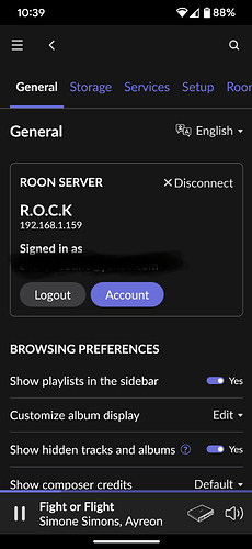

Go to settings:general and first entry is your current server
If it’s not the one you want just hit disconnect, ignore any warnings.
Then it will present you with any available servers Roon sees in your network, choose the one you want to use.

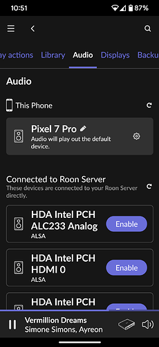

Settings: audio and it will show you all available endpoints Roon sees, it may need to be enabled of course.

It did not resolve the issue. First of all the BDP2 is a music server. I play all my music files and use Tidal through it. The Bryston DAC is a BDA. I tried what he suggested, go to Settings/General/Roon Server.The server it shows is “This PC”. I press “Disconnect”. Then it says Choose your Roon Server.It shows “This PC”. It does not show a list of servers. It says “Connect”. When I press “Connect” it shows three options:
