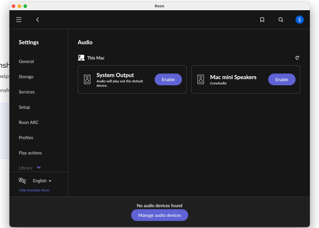

I just restarted Roon Core via the Mac Mini interface and noted the time as 12.07 pm UK 22nd June. The app started in good time. I can see all my albums etc and response times when navigating are normal. There are no audio devices being picked up however
Following that 12.09 pm I tried to access Roon from my iphone and just getting the ‘Waiting for the your Roon Server’ message. Its not able to connect and this is the other side of the equation

From that screen-shot no audio devices are found because you have none enabled. Did you try clicking the blue “enable” buttons.
Hi Tony thanks for the suggestion. No sadly that doesn’t change anything there is nothing to enable beyond the mac mini speaker and clicking on manage audio devices produces no result. There should be a whole bunch of active devices spread all round the house and they were being picked up by Roon until I started seeing this issue

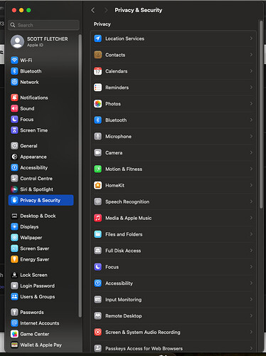

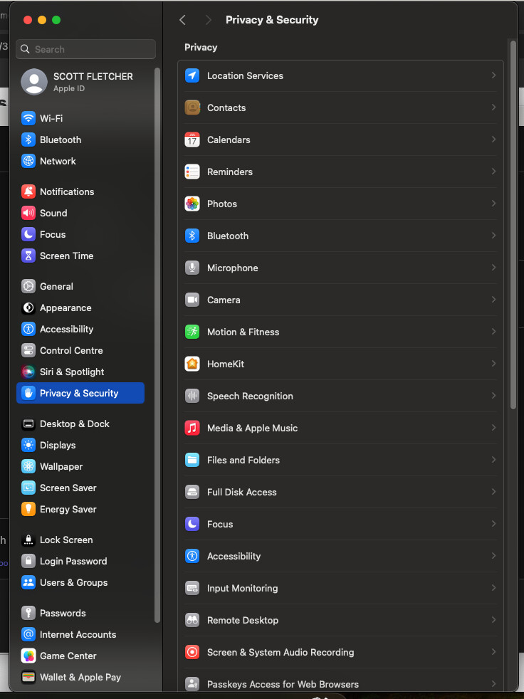

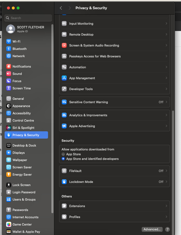

Hi Benjamin
After checking apple mac system settings, privacy and security. There is no Local Network option

Hey @Scott_Fletcher,
You have my apologies here, I mis-read what macOS you were running. The Local Network privacy toggle doesn’t exist as a dedicated pane on Sonoma, Apple only introduced the standalone Privacy & Security → Local Network list in macOS 15 (Sequoia).

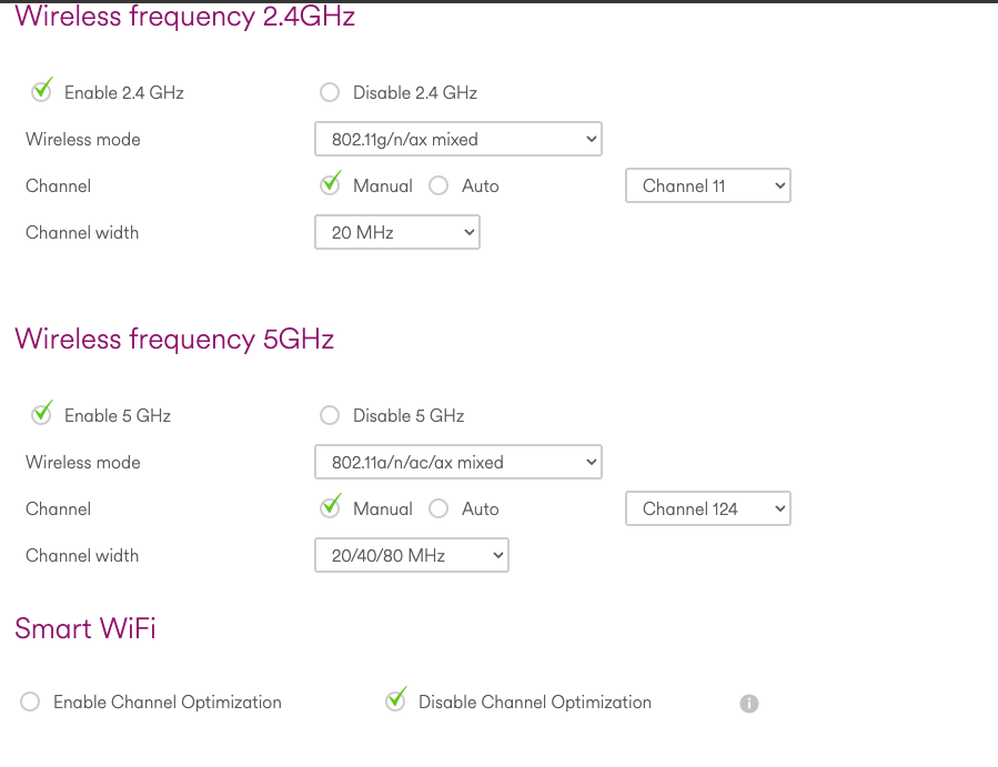

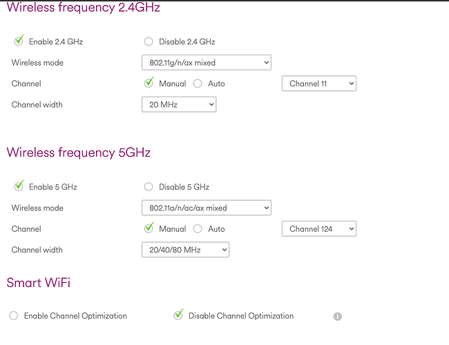

  1. I couldn’t find anything in the Virgin router menu’s that mentions IGMP snooping or multicast. WIthin WIreless Signal I’ve included a screenshot. There is the option for Smart WIFI and I’ve disabled CHannel optimisation. Not sure if this is the right thing to do. It doesn’t seem to be impacting things either way

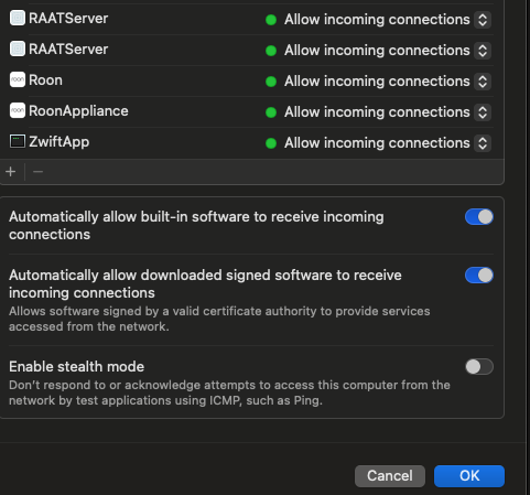

  3. The Firewall is turned on and Roon Server connections are allowed to be accepted. Screenshot also included below. As soon as I turn off the FW however then all devices are visible and I can connect over the Iphone. It seems like this is for sure part of the issue
WHat would you suggest as I assume I shouldn’t be permanently disabling the Firewall to allow Roon to operate and especially given the incoming connections are allowed?
That’s a really useful result, thank you. It confirms the firewall is the culprit, and the fact that it’s still blocking Roon even though Roon Server is listed as allowed usually means the allowed entry is pointing at a stale binary (common after an update or reinstall), so the process that’s actually running no longer matches the rule. Let’s rebuild those exceptions from scratch rather than leave the firewall off.
Please try the following:
  1. Go to System Settings → Network → Firewall → Options. Remove the existing entries for Roon and Roon Server entirely (select each and click the minus button).
  2. Make sure “Block all incoming connections” is turned OFF. If that’s on, it overrides any per-app allowance.
  3. Turn OFF “Enable stealth mode” while we test. Stealth mode silently drops the multicast/discovery traffic Roon uses to find your endpoints, which fits the pattern of devices vanishing.
  4. Fully quit Roon Server from the menu bar, then reboot the Mac mini.
  5. After reboot, relaunch Roon. macOS should prompt you to allow incoming connections, accept it. Then go back into Firewall → Options and confirm that Roon, Roon Server, and RAATServer are all present and set to “Allow incoming connections.” A missing RAATServer entry in particular would explain why your library loads fine but no audio devices appear.
Once those are re-added cleanly, please test again with the firewall ON and let me know whether your endpoints reappear and the iPhone connects.
