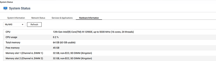

It’s the same library that I have always had, but maybe the OS update could have triggered additional background work / scanning to occur. I have not come across something like a spinning wheels, or progress bar. Is there a way that I could check?
The CPU currently shows almost no usage :
I did not try running it under Container Station. Prior to the Roon update, I believed that controlling my local files (play, stop, pause, track skip) was faster than any streaming service.
