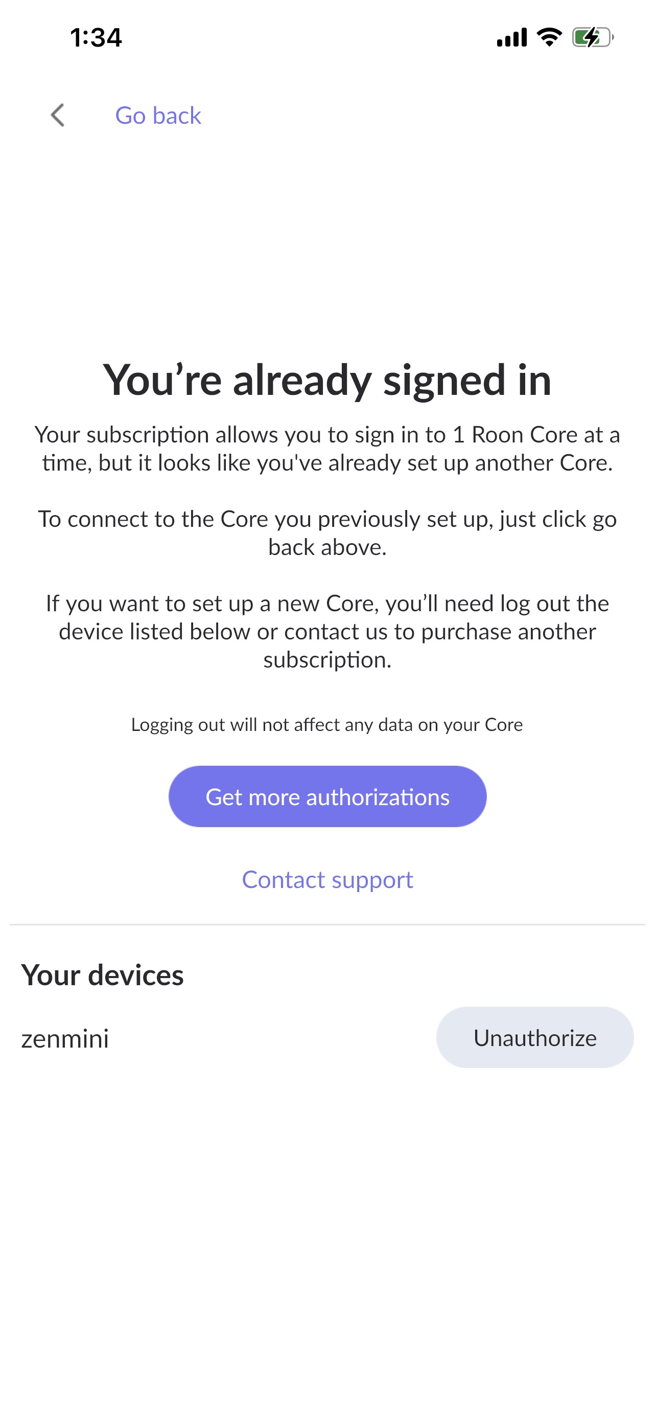

  1. Old Roon app shows that my Zen Mini is ready, but when I press connect I need to Login and get the message “You are already signed in”. under “Your devices” it shows me the connected Zenmini (Shall I try to unauthorised it??)

Do you have a new core you are using with Roon? If so, then yes you will need to deauthorize the previous devices you were using as your core. You do not need to deauthorize anything in regard to using Roon Arc.
