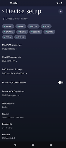

USB DAC is detected by the app:
Formats supported by the DAC are detected and lossless DSD playback can proceed:
