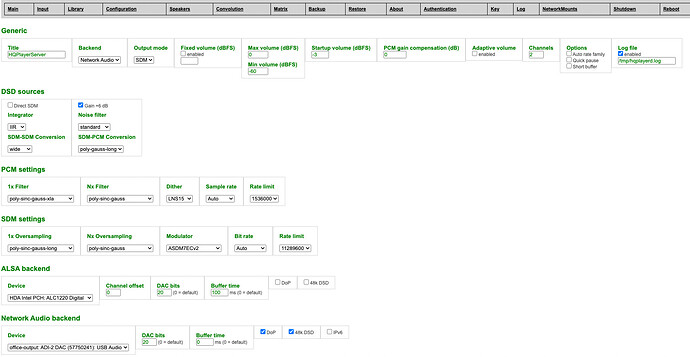

Can you share screenshot of your current Config page?
Don’t forget I need you to try to reproduce a problem I had , assuming everything is working reliably for you now :slight_smile:
Right! Will now move on to testing your other request. Config page below…
Thanks. So:
  1. Enable Auto rate family
  2. Change DSD rate limit to 12288000 Hz
This won’t be a problem with Roon input obviously
It’s iOS → Upboard that I’m keen to know.
Especially when music changes from 44.1k to 48/96/192k and back to 44.1k
Leave your filter settings as is - gauss-long and gauss.

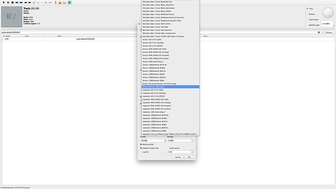

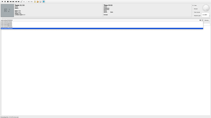

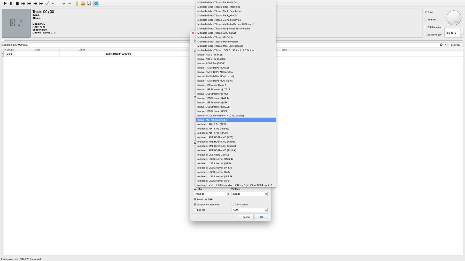

Thank you again Jussi! So did hook up my little Yamaha MG UX12 to my Ubuntu Server running NAA right now instead of HQP Desktop. Using HQP Desktop at iMac now for test purposes. Right now getting sound via NAA backend “lenovo: XGU USB” at iMac HQPDesktop , so using classic USB interface where you have to select Audio Sampelrate at HQP. Funnywise it does not matter which samplerate i pick, it plays on >>all rates i pick (right now feeding analog input only to yamaha mixer please. no digital input at the moment. but this could be used for “old” synthies or other fantastic devices with analog output. Yamaha is doing AD with up to 192/24…do not know the chip. NI ist using Cirrus Logic CS4385 at MK3 audio-interface…) Myself does not know, how to start playback with HQP Desktop when selecting USB Class 2.0 as input… Which button to press to start playback I mean please…
Current setup, standard Audio Interface only - no “lenovo: Class 2” right now…
All samplerates play for the same stream.Blackhole and Hifiberry super sensitive on this…funny…But still do not know how start playback on HQP Desktop for USB Class 2 input… :expressionless:
Edit: Like the sound from analog input via Yamaha to HQP :smiling_face_with_three_hearts: Prob. have some DSP stuff running…lol…
Edit02: Feeding digital 44.1 from Ubuntu itself to Mixer via classic audio can still use in HQP 44.1 or 48 audio playback. But starting with 88.4 sounds terrible for 44.1 digital input stream. Anyway like the sound already, I am getting for 44.1!!! So via this way all stuff from Linux can be fed to HQP, e.g.Clementine(?), VLC, whatever / not tested by myself), this should all work with Pi too as it is Linux (not checked so far)…>>But still no automatic samplerate switching as still not using Class 2 as NAA backend…except HQP not sensitive for 44.1 or 48 select for digital input at sample rate. analog input works whatever sample rate you select in HQP? Funny…Maybe specific to the Yamaha mixer here. ++ Anyway still hunting for complete auto sample rate switching for digital input…

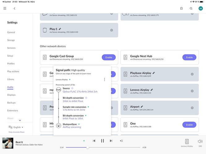

Ok, here is an update please on this. I managed to feed HQP now from Shairport-Sync using the Yamaha Mixer. Shairport-Sync is the best Airplay endpoint implementation I know so far. There are reasons, why e.g. Sonore is using it and others as well. Shairport offers a zillion of options for Airplay. Take a look at github better at the excellent config file itself. Partly Shairport options are overlapping with HQP. Just for fun, I did switch Shairport Samplerate to 88200. guess using SoX (Jussi will laugh about me for sure. But just as a test for the options, if they are working with my Shairport-Sync running on Ubuntu Server. And yes, they do!) Shairport-Sync supports spatial audio. You can switcht the ALAC decoder algorithms, many many many more. Feeding HQP now from Shairport-Sync is a personal dream setup for me :smiling_face_with_three_hearts: Let´s see how stable it will run now! PS There is a Airplay 2 version too for Shairport-Sync if you want to have that for multi-room.
Here I am feeding Shairport-Sync from Roon. Shairport-Sync is hooked up to HQP afterwards, what you can not see at the Screenshot. Ok. Only problem left, how do I get HQP Output back to Roon :rofl:
