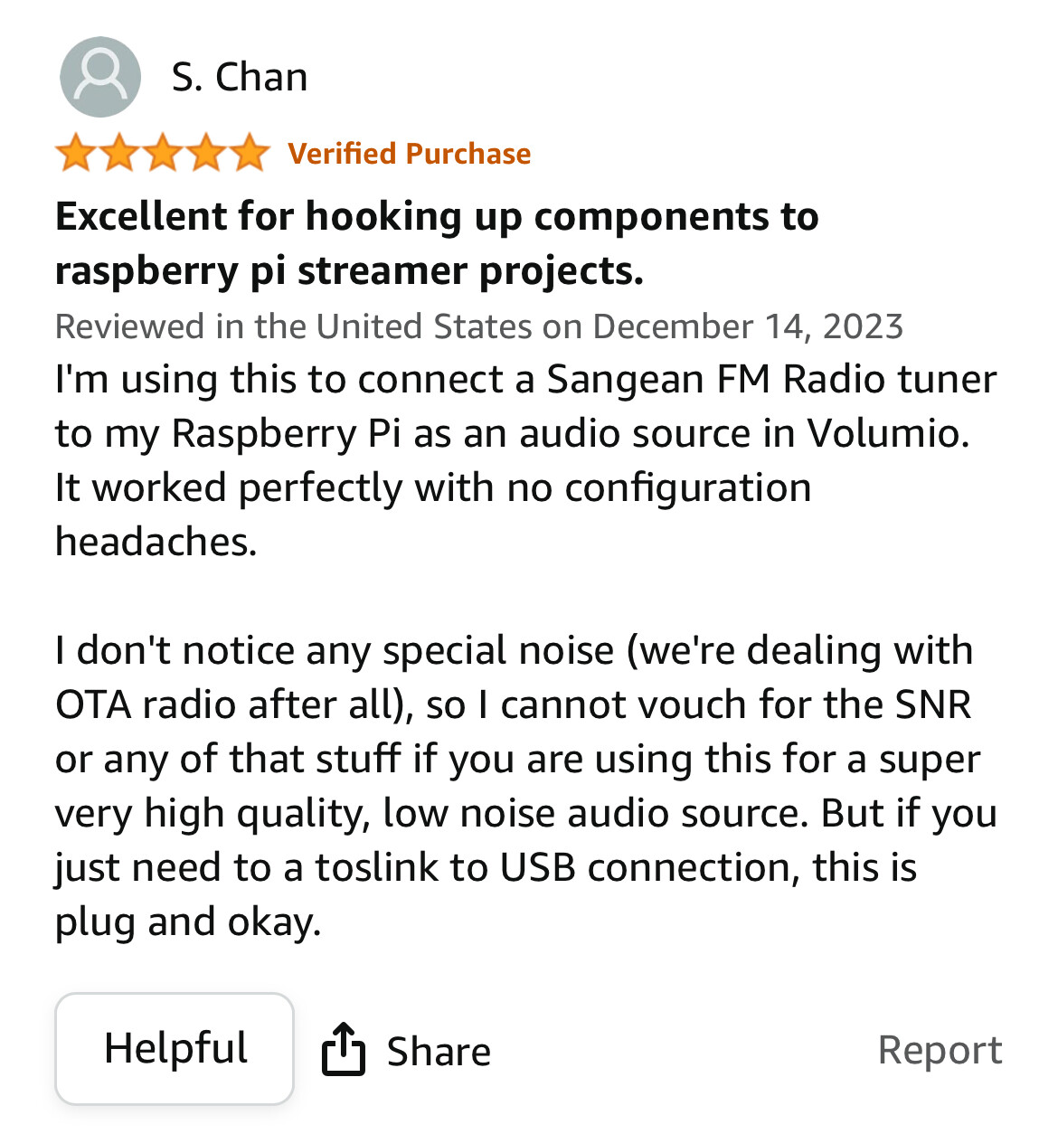

The review from Amazon

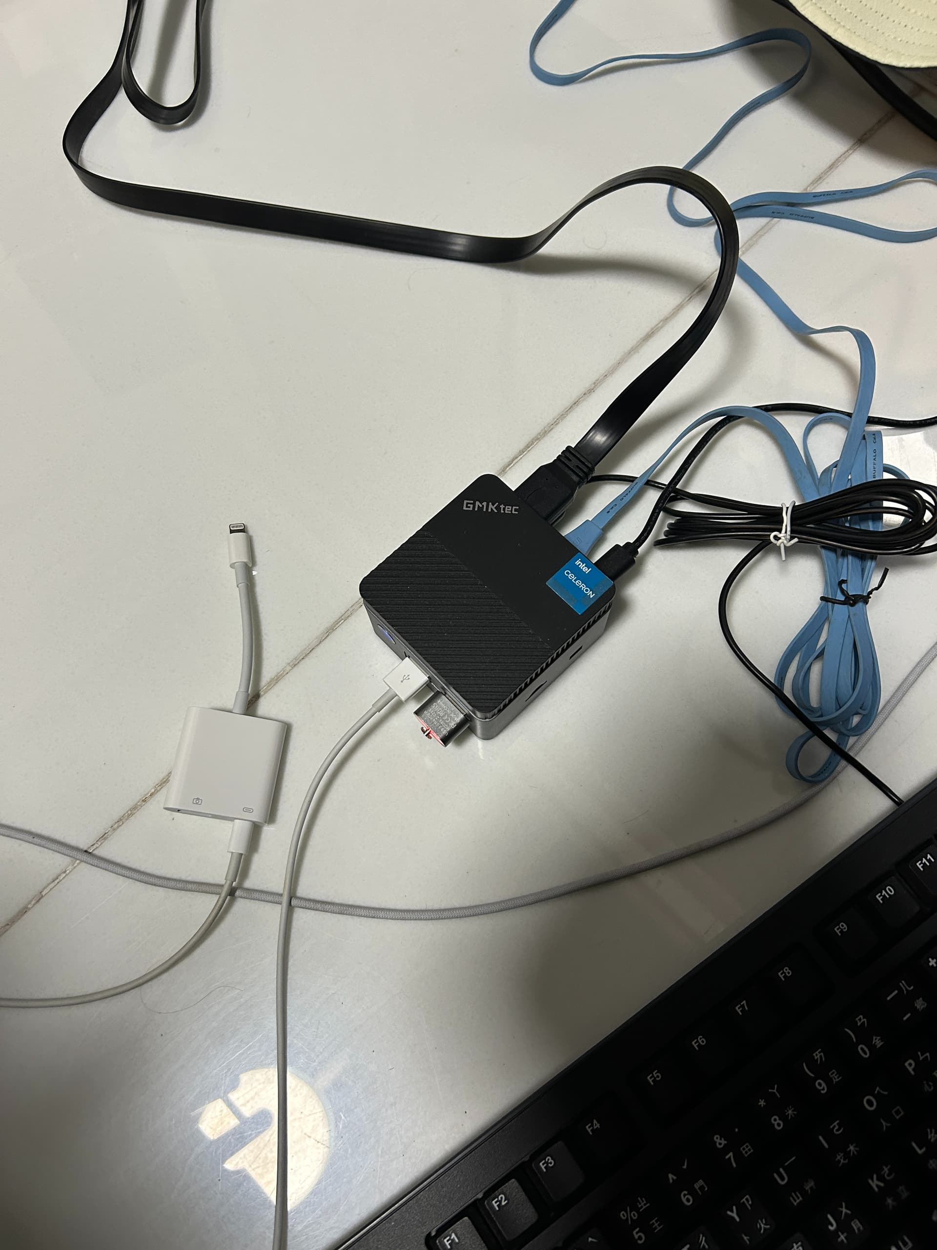

Is this correct:
iPhone playing Tidal source connected to shown cable.
Input NAA:

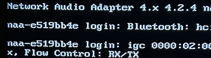

I’m testing using a miniPC as NAA (naa-e519bbe) with cable shown connected to the previous iPhone
On desktop Hqplayer settings.xml I added the input with the NAA "naa-e519bbe:

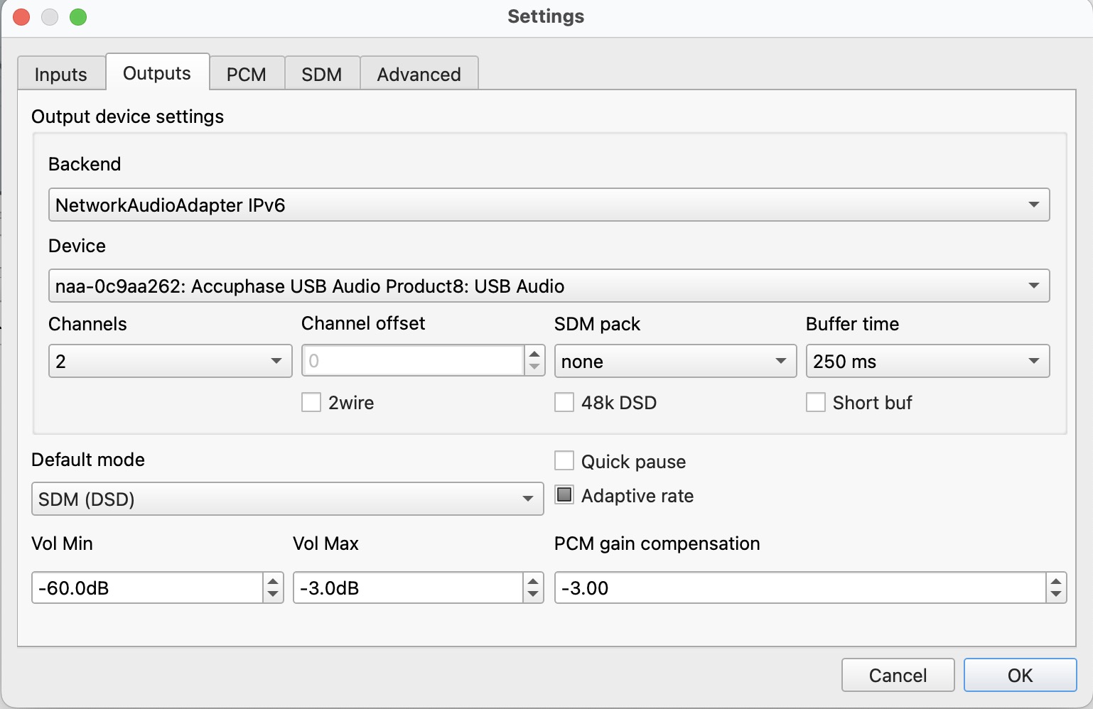

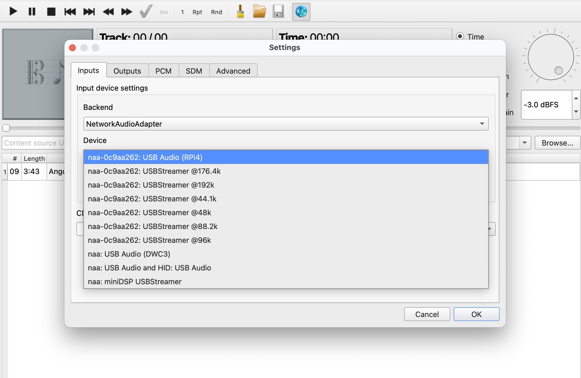

Looking at my desktop settings I can’t find the new NAA as the input source
But my output source is ok
Do you need to use a Rpi4 running NAA for this matter instead?

No, you need to connect to the type-A connector on the Apple USB3 dongle. And then to type-B connector at the NAA side. That NAA you have there probably doesn’t have any device side (type-B) USB ports. Only host side ports (type-A).
For the iPhone/iPad source to work, it needs to be the USB host, and the NAA needs to be the USB device.
For RPi4 to work as input NAA, you’d use USB3 type-A to type-C cable, so it must have the blue type-A connector and be proper USB3 cable. And then in the NAA OS config.txt you need to switch the RPi4 type-C port mode from host to device (which is called “peripheral” there).
