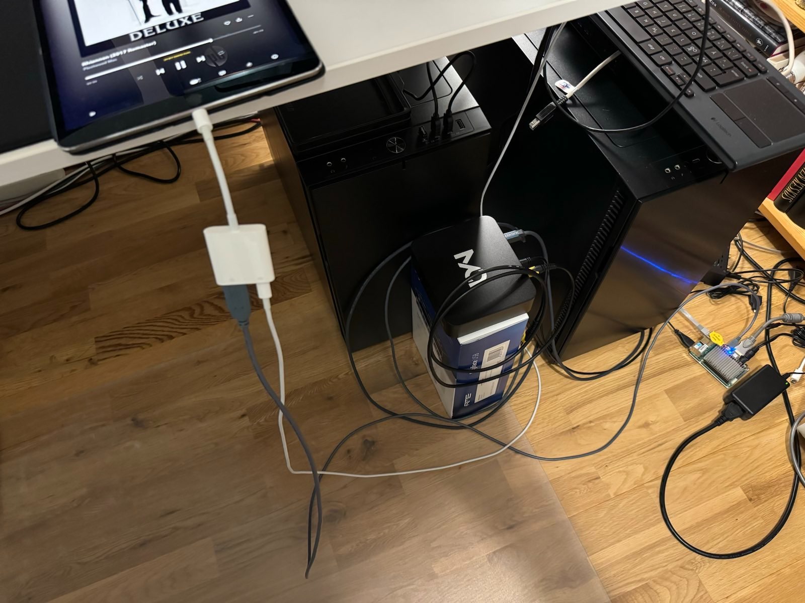

At the moment I’m playing from Tidal app on my iPad to UP Gateway as input NAA. HQPlayer running on this MacBook Pro, output through another NAA to Holo Spring 2 at DSD512.
And automatic rate switching is working just fine for me.
I couldn’t use RPi4 as input NAA in this case, because the Apple Lightning-USB3 dongle adapter is not supplying enough power to RPi4 and it gets into reboot loop because of that. And I don’t (yet) have a suitable Type-C USB hub that would provide “charging” current to RPi4. UP Gateway doesn’t have such challenges because it is powered separately.
That little thing on the floor is UP-Board aka UP Gateway acting as input NAA.
