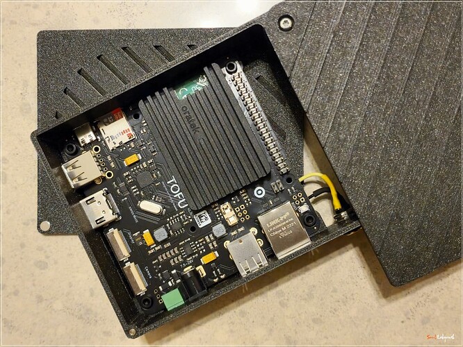

I have 2 Raspberry Pi CM4s installed on 2 TOFU carrier boards. Both of them are using as NAA function on NAA OS.
For both of them I set force turbo to manually fix their CPU to run at only 800MHz (severe underclocking) without any issue (even at DSD1024 for the output NAA).
For the NAA input CM4, running at this 800MHz, connect its USB-C port (use for both data and power supply) to my Surface Pro 5 standard USB3 port also works without issue. This USB3 port can provide only 900mA by standard, BTW.

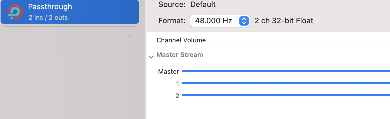

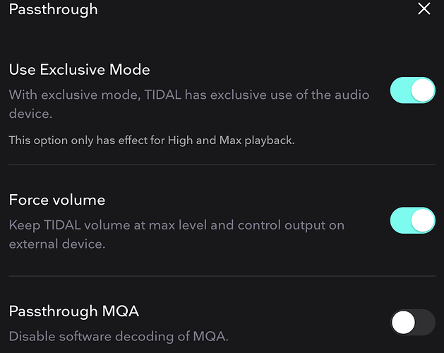

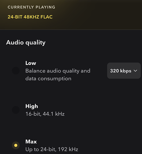

I just tested out with Tidal (in exclusive mode) and Rogue Amoeba Loopback is auto changing the sample rate based on the song, if you disable passthrough MQA decoding. In which case, Loopback gets fixed at 192k.
I started NAA on the same macbook pro and used that Loopback as the NAA Input in HQP.

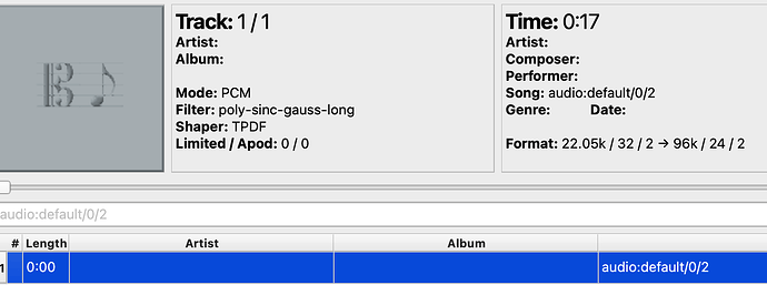

When I enter audio:default/0/2 in the URI field, and hit play, the input sampling rate gets to 22.05 khz and there’s no sound from the output set to Core Audio MBP Speaker

So will the Apple Music approach work with Tidal by modifying the HQP control script? The situation is better apparently with Tidal as it does change the core audio sampling in exclusive mode.
