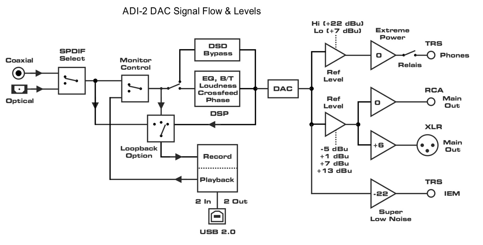

@dabassgoesboomboom IIRC, RME announced at some point a loopback feature for ADI-2 DAC. Have you tried this with yours? It could be one additional way to do inputs.

In some cases you could replace need for any other external hardware for feeding audio from application X to HQPlayer, you could have both on the same machine with audio routed locally through the loopback.

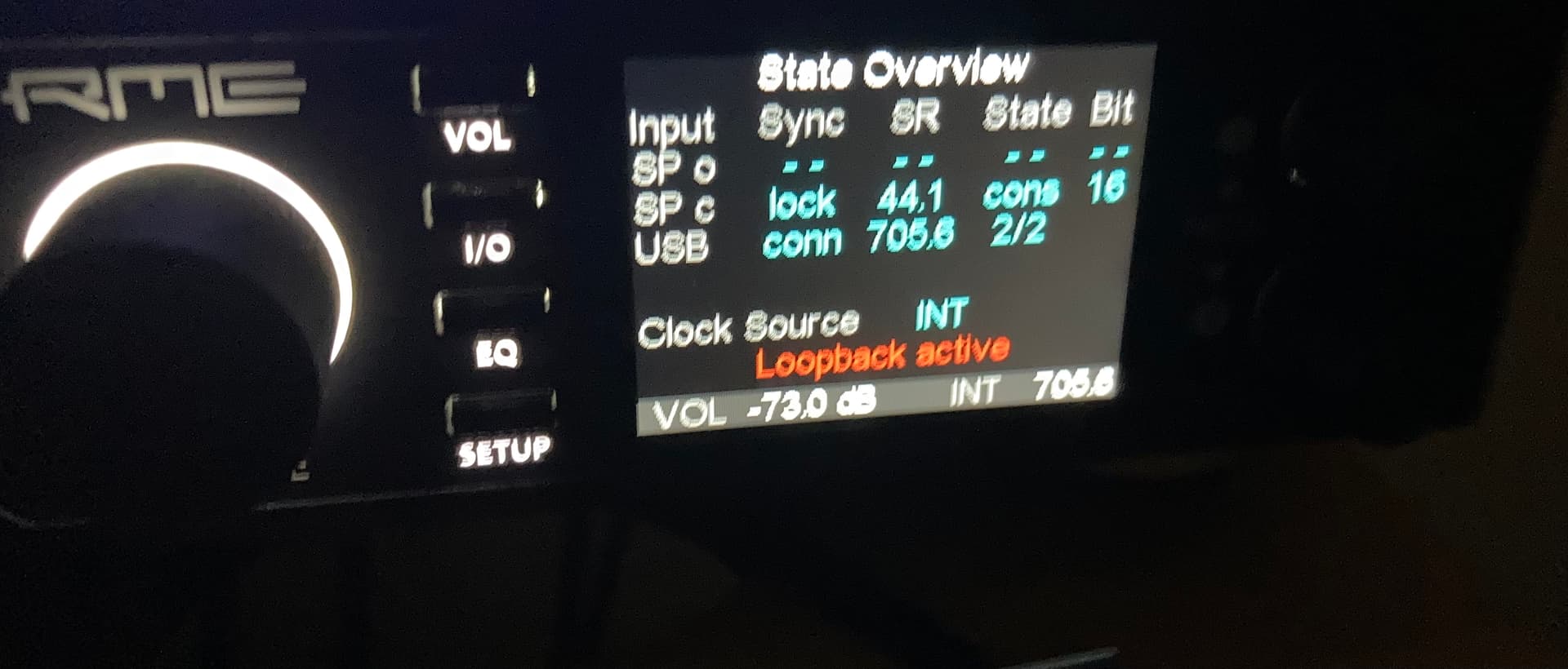

Ok so I plugged in headphones to test this out.
When I select the ADI-2 input, itās not working. HQP output is set to PCM705kHz, so that is showing.

If the manual says coax/optical is then no longer available for recording, then this is to be expected?

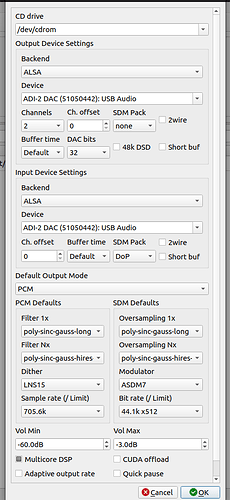

@jussi_laako - Unless you mean, play a USB source to ADI-2 and try to output from HQPlayer back to ADI-2 ?
I would need to make a change to hqplayerd.xml though to input from USB? Currently its setup to input from digital coax / TOSlink
Because the manual says coax/optical is then no longer available for recording, with loopback to USB

For example play from some other application on Linux to the ADI-2 USB output, and then attach HQPlayer to the ADI-2 input. You may need to either use ā0ā as sampling rate in HQPlayer URI, or match the output rate. Both input and output need to be same rate naturally, otherwise it wonāt work.
There are two ALSA devices, one input and one output. So this should work.
It is likely the āSPDIF Rateā one, so the āopticalā input. But you can check with alsamixer which one shows correctly.
I fiddled with everything and canāt get it to work. Also fiddled with channel offset, from 0 to 4 (nothing in the ADI-2 DAC manual about which is what)
Source is 44.1kHz (Soundcloud in Firefox browswer on same Ubuntu Desktop machine)

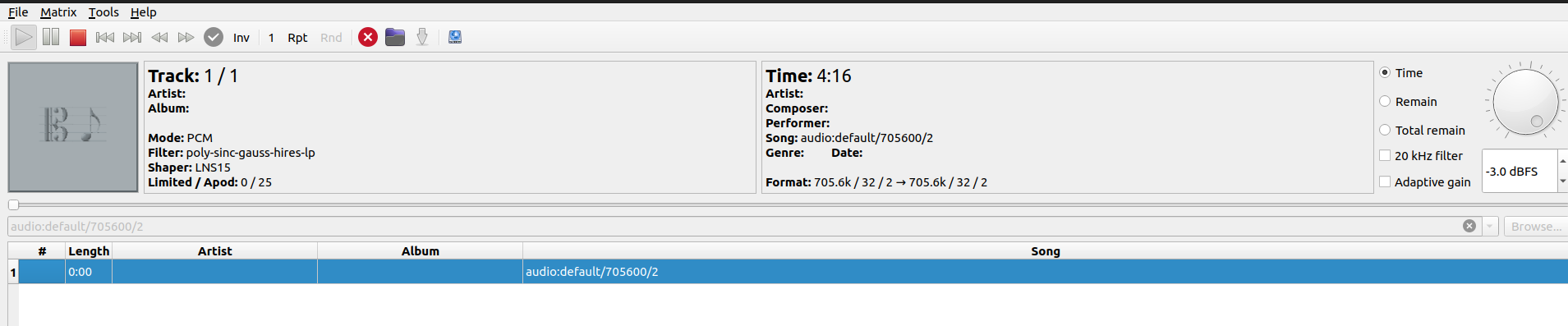

I select 44.1kHz under URL in HQP Desktop and it fails.
I select 705kHz and it starts running but no sound
I am selected USB source on the ADI-2 itself but no sound

Problem is here, you have the ADI-2 selected as output device too. So Ubuntu cannot play to it. Only select it as input device and something else as output. Then Ubuntu should be able to play to the ADI-2 output side.
Just in case, first start playback to the ADI-2 from Firefox for example. And only then try to start playback from HQPlayer, using the same rate as the output is going.
