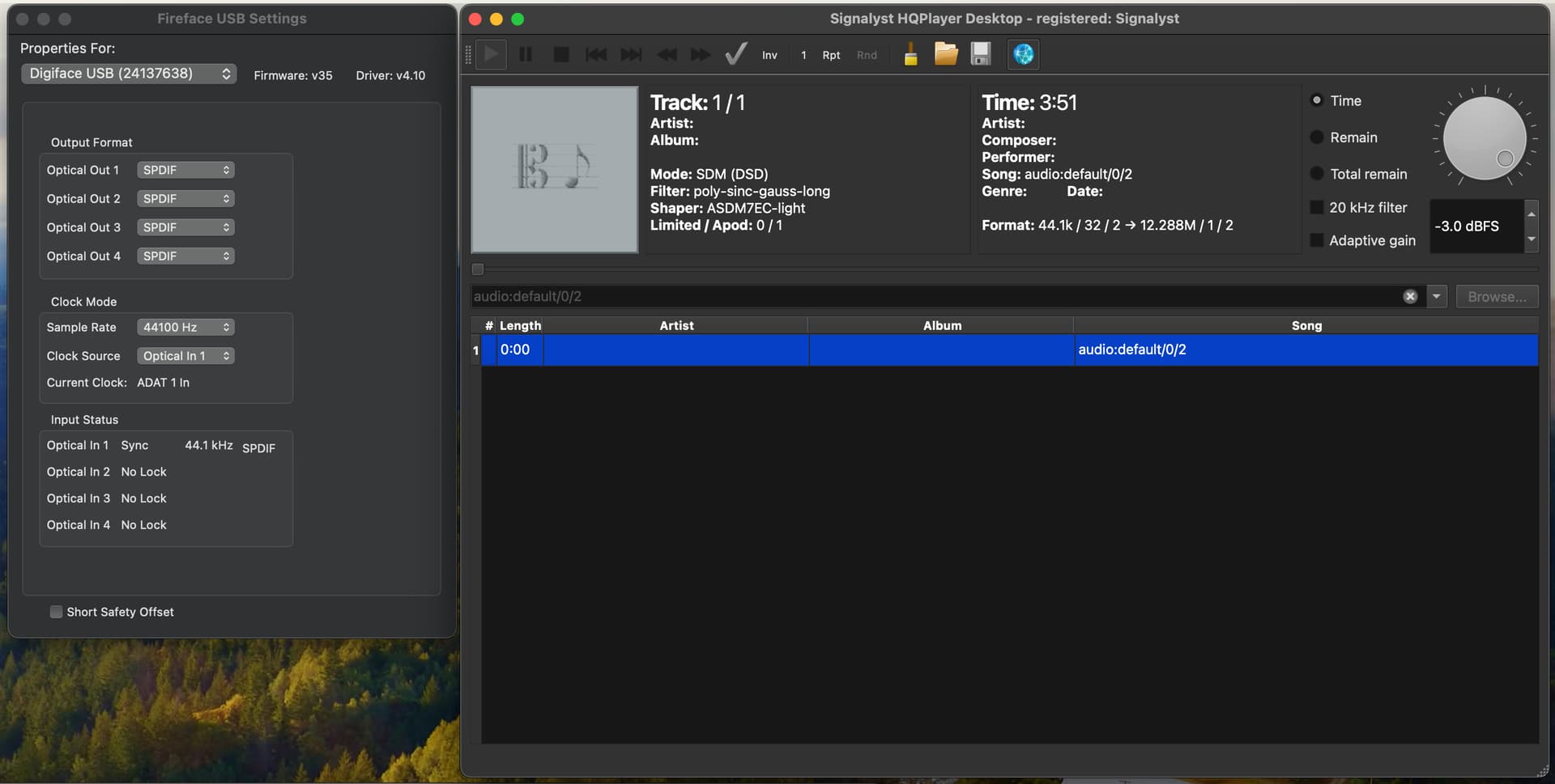

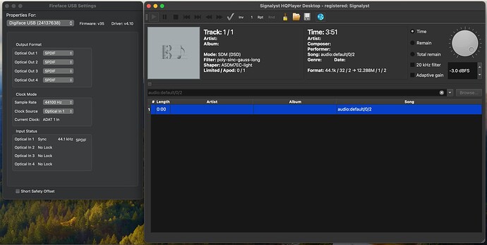

Iâm happy to report another success for Mac users! In latest HQPlayer Desktop, I managed to figure out how to make automatic rate switching work on macOS with suitable input device.
As result, I can report that automatic input rate switching seems to be working with RME Digiface USB on macOS! On Windows, this is still partially broken due to a bug/issue with ASIO driver. But with macOS DriverKit driver, it seems to be working on macOS!

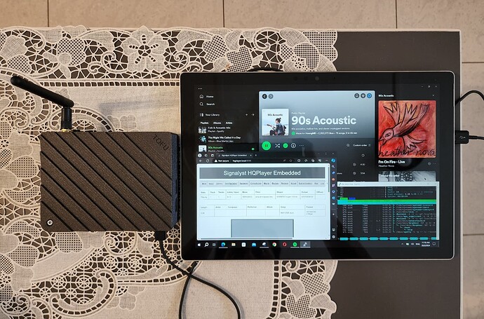

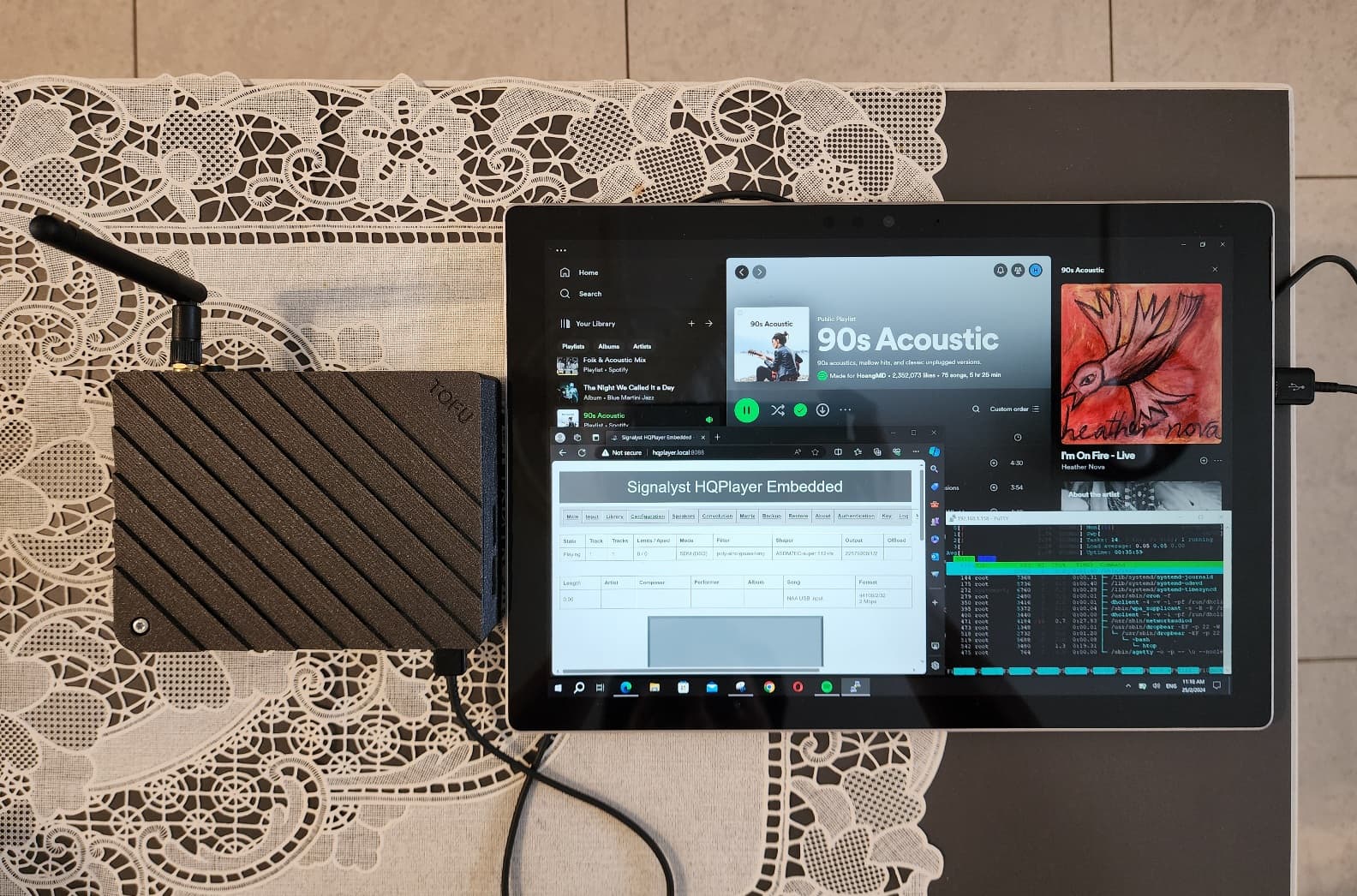

Finally got DietPi NAA input works smoothly via WIFI by switching to 5GHz instead of 2.4GHz!
Thank you all for the great suggestions and inputs!
Look much cleaner on the desk now.

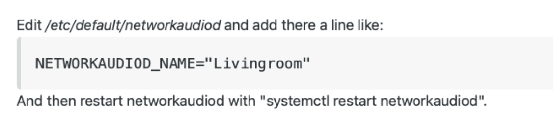

With DietPi NAA i can still change my NAA name using same process:

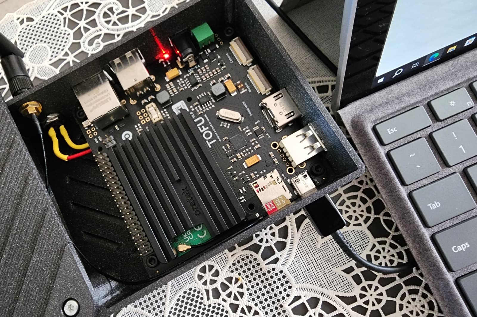

This is cheap and the USB-C power in , is also USB slave. Which I assume means peripheral mode.
And comes in fanless case and is well supported by DietPi.
I have a thread somewhere with USB-to-WiFi adapters that work âout of the boxâ with DietPi. So can use the USB-A port for that. I know MT7612U chipset USB to wifi adapters work with DietPi because I tested.
I might give it a try, it is so cheap.

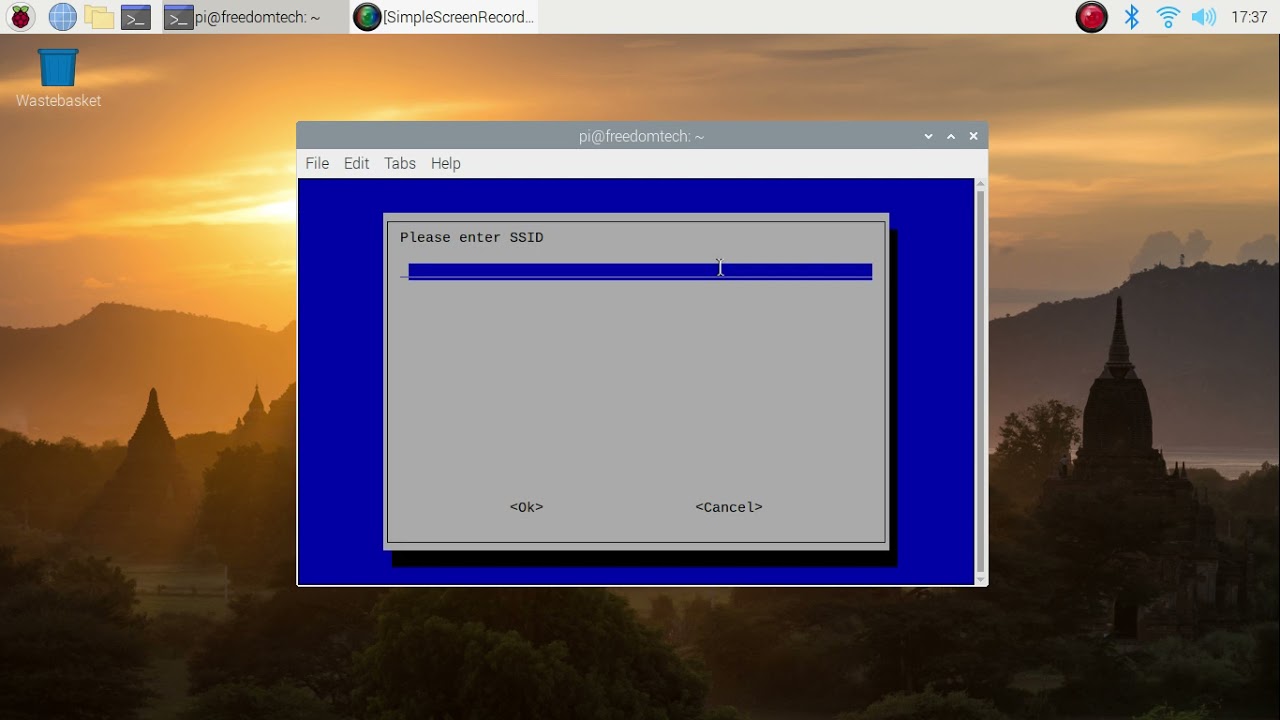

Can you explain a bit more what you mean?
I donât know the UI technical term but the way you configure Raspi-Config or Dietpi-Config is like in the video below.
Itâs not a bloated web GUI like ropieee but some terminal prompt looking thing.
From here you can very easily setup WiFi.
You can do it with HDMI and USB keyboard directly connected or if user enables SSH (like can choose to do with NAA OS) can do it over SSH
if NAA OS could do this , no need to use anything else. At least for now DietPi is nice and very minimalist. No bloat
That is ncurses-based text mode âGUIâ.
