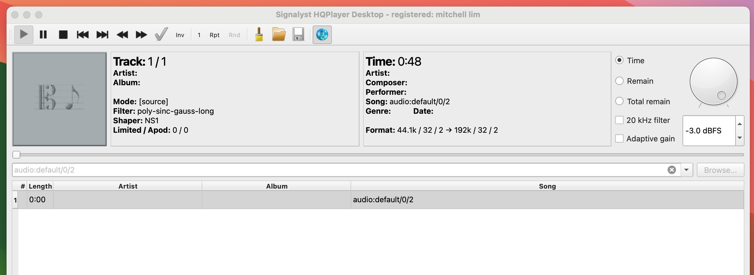

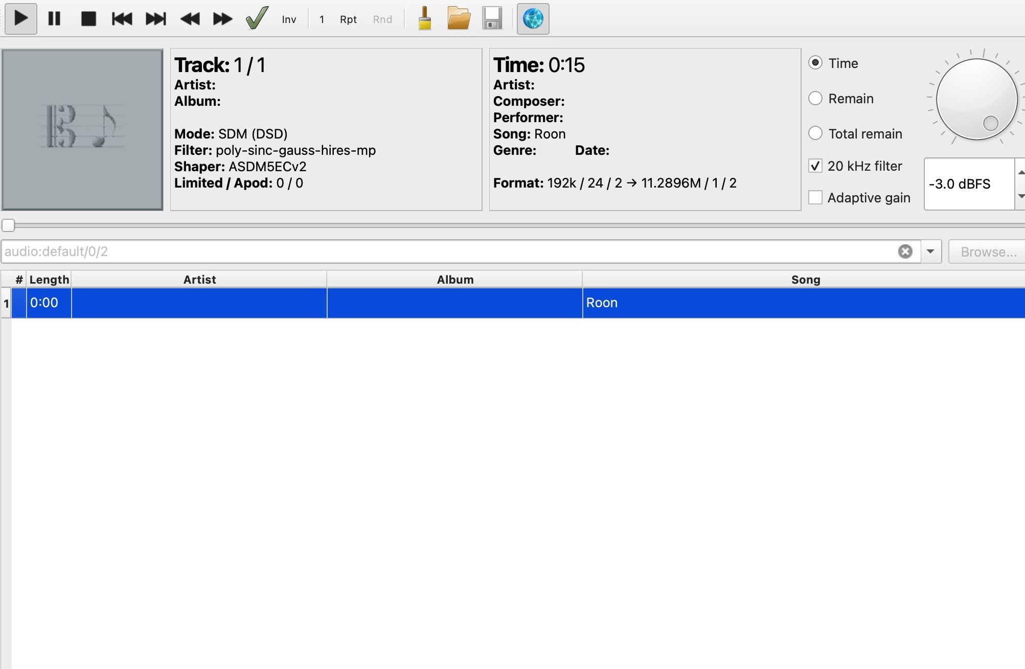

I have just tried the new lease of HQP Desktop 5.5 (with Pi4 HQP NAA 4.6), I can see Mac’s sound input “Plackback Inactive” and can play from my Music app via HQP NAA to my Dac, however, the auto sampling rate does not work, it just stick the source as 44.1 … even the Music app source is 192kHz.

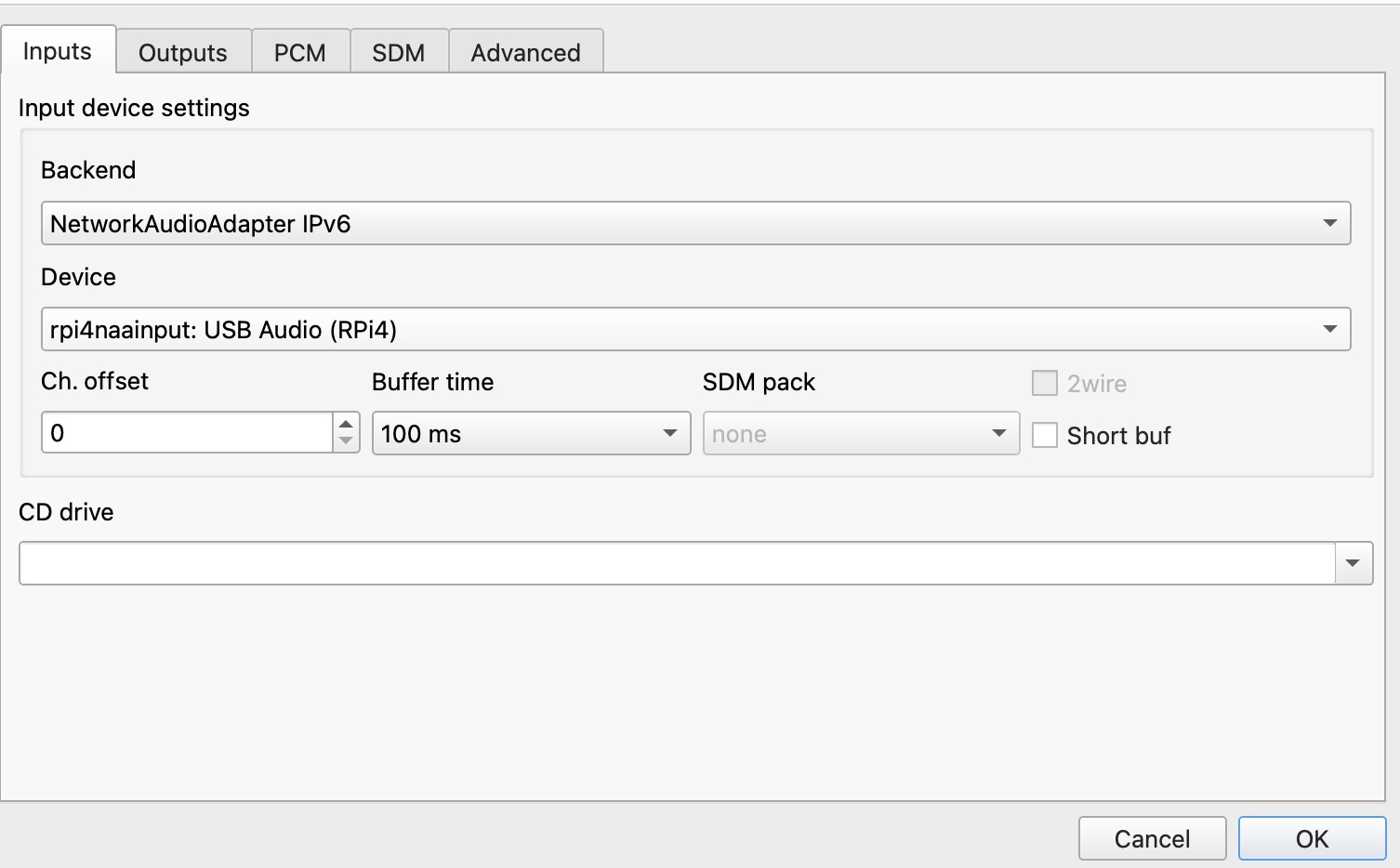

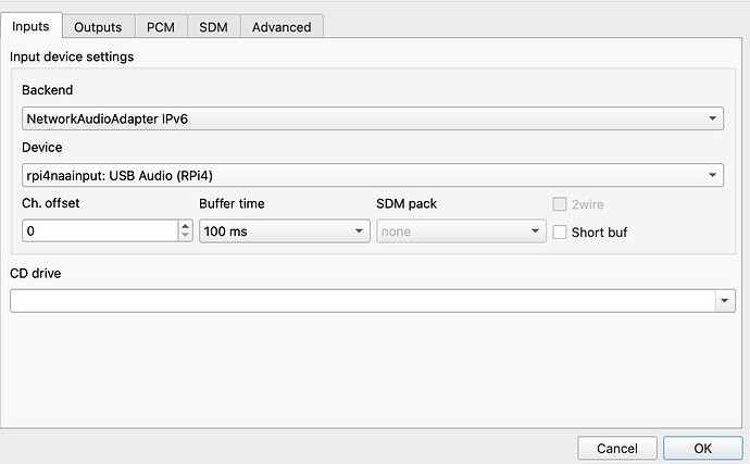

Have been dealing with HQP Desktop 5.5 and HQP NAA 5 (with Pi4) , at first I could see the NAA5 show up as one of the Inputs, however, I could not to make it play , as the “Playback Inactive” did not show up on Output (no issue for NAA 4.6), and I realised that I should edit the config.txt as I did for 4.6.
After the edit, it successfully showed up on Mac’s output (Playback Inactive), and also manages to play, however the automatic rate switching does not work, and I have to open the Lossless Switcher to make the sample rate change according to the source.
Am I right that the latest version of HQP Desktop / NAA still need to work with Lossless Switcher app for automatic rate switching, or did I do something wrong ?
For the Mac it is normal to need Lossless Switcher, if you are talking about Apple Music of course. This has always been the case

Did you select the “USB Audio Class (RPi4)” as input device?
Apple Music on macOS doesn’t support rate switching without LosslessSwitcher, because the Apple Music application on macOS uses CoreAudio in shared mode and thus it goes through the CoreAudio rate conversion, volume control and mixer always.
You can try for example with Qobuz application on macOS if you set Qobuz to use exclusive mode.

Yes I did select the “USB Audio Class (RPi4)” as input device

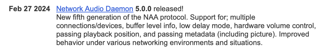

Speaking of v5 NAA new feature:

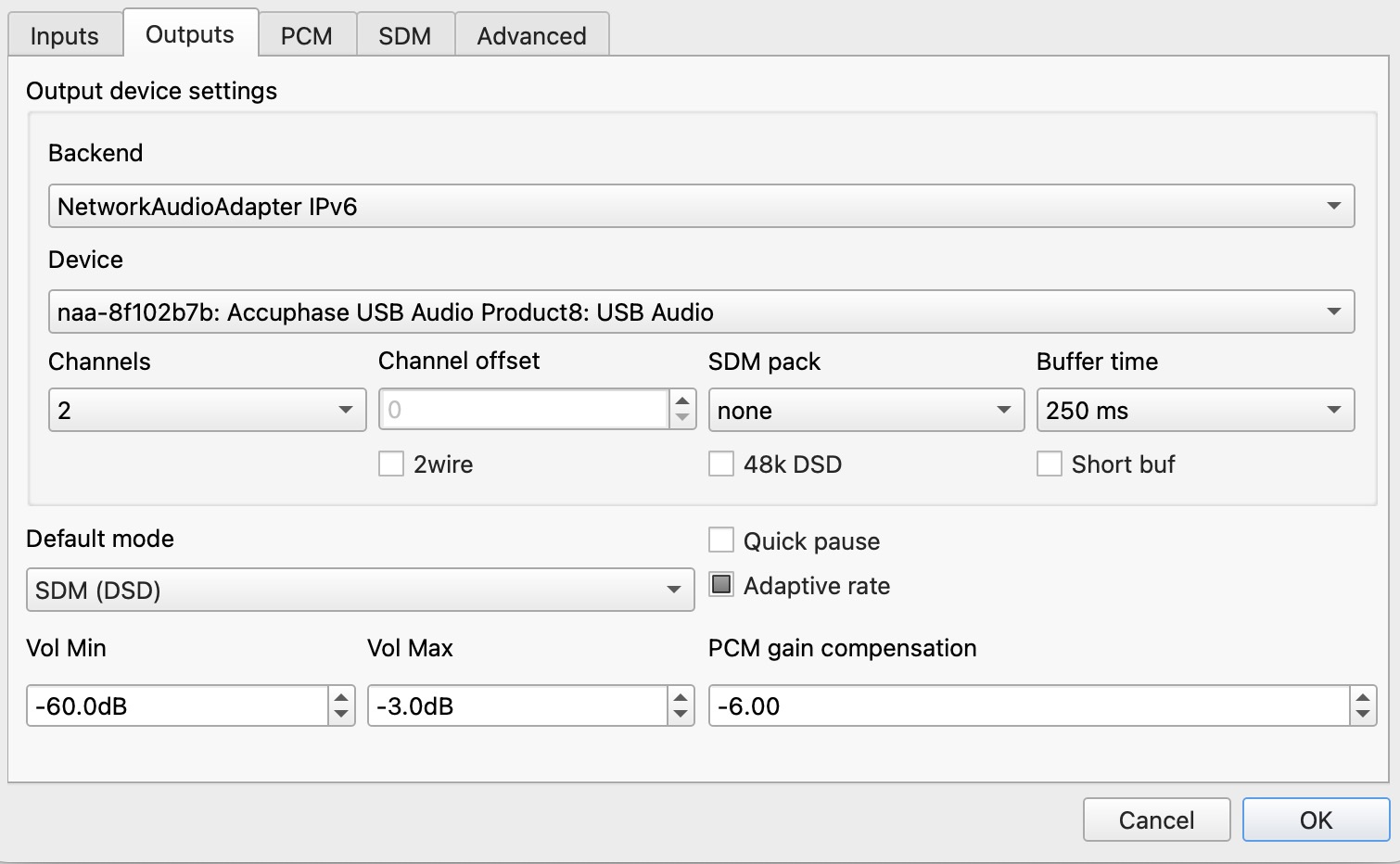

I am currently using UpBoard Gateway for both NAA input and NAA output at the same time :grinning:
Input = PCM96kHz from Apple Music Hires
Output = DSD256 to Holo Cyan 2
Great for my office system, one less PSU, lower energy waste
Working flawlessly

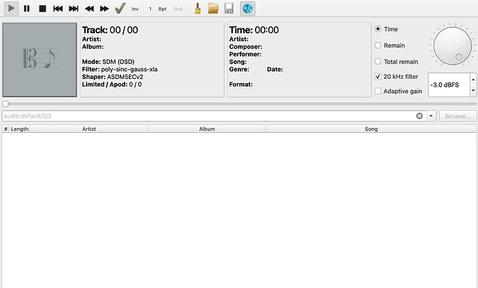

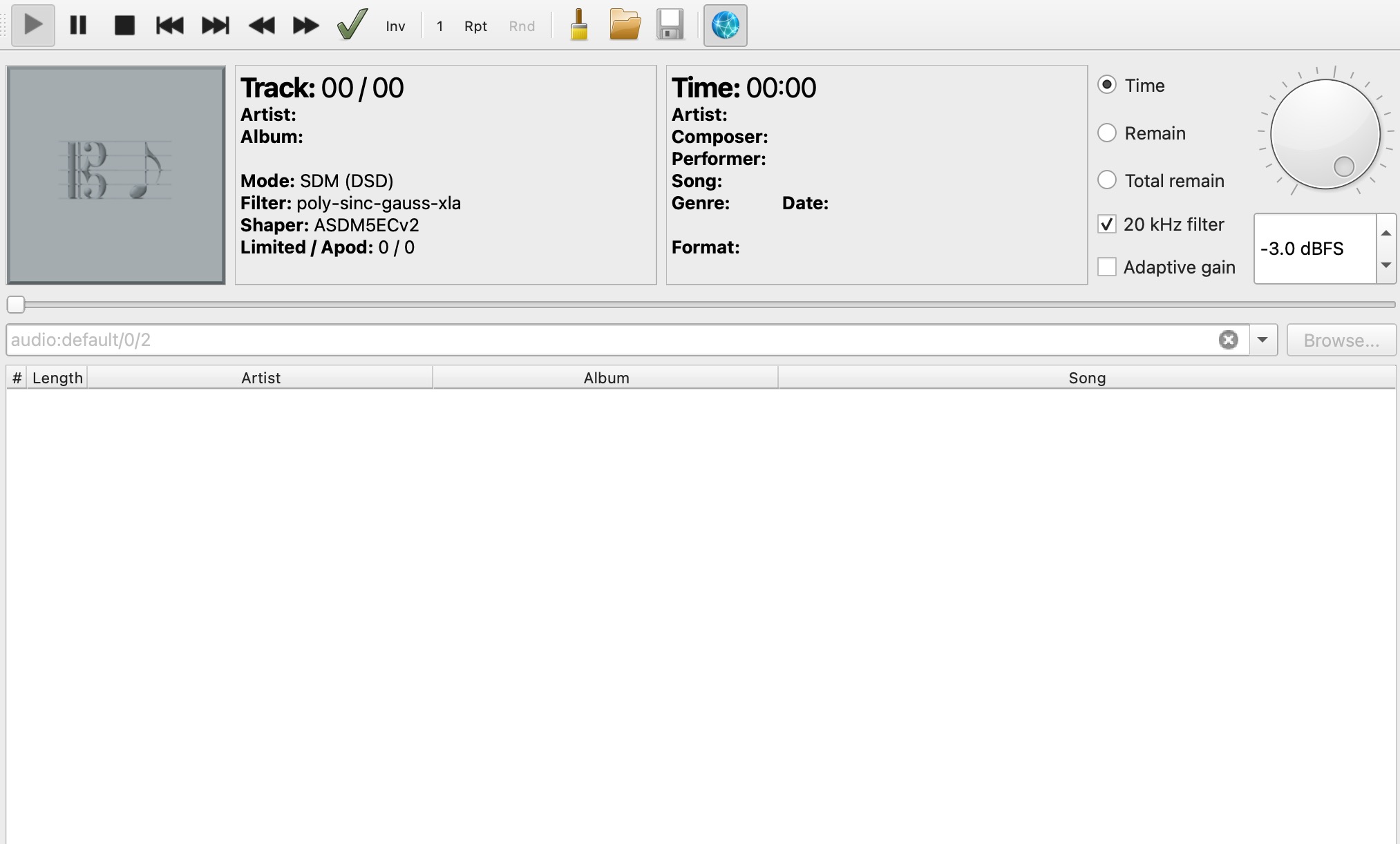

# 2024/02/28 23:38:05 clMainWindow::startPlay(): clHQPlayerEngine::Play(): Transport == NULL
Don’t know what happened, just not longer playing.
Only updated NAA 5.0 to Rpi4 to DAC-60, input NAA is same as before.
Roon no problem
How to do this?
According to screenshot and log, the playlist/playback queue is empty.

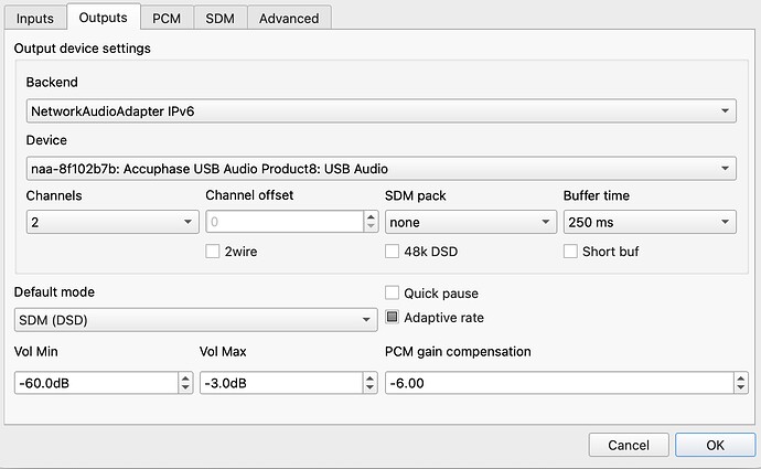

If your NAA is regular RPi4, it’s name should have been changed as result of update, so the output device setting needs to be updated. Be it input or output.
Now with NAA v5 and HQPlayer >= 5.5.0 you can use single RPi4 for both input and output at the same time.
I only updated HQplayer Desktop 5.5.0 and output Rpi4 to 5.0 NAA
To use NAA 5.0 as I/O with HQplayer 5.5.0 we need to edit the config file as well like before right?
YES, we must edit the config.txt
Default config.txt is something that will work out of the box with Holo Red for example. To use RPi4 as a USB input, you need to edit config.txt every time you flash the image to a card. No other changes needed.
