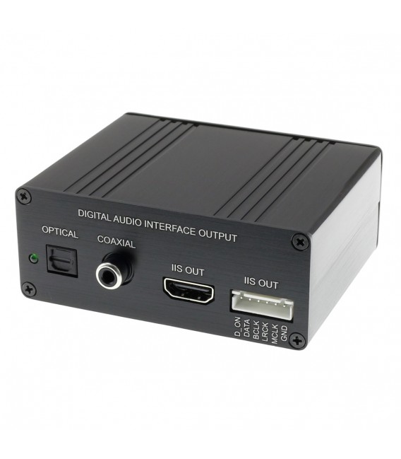

And this extractor, that can split HDMI into I2S, etc…
If this link can work the question remains how to route its stream into HQP. So I really wonder how your solution with Digi+ would work.

What I’m trying to unserdtand is how to connect SDM stream to NAA/HQP.
I seemingly am missing a piece of a puzzle here between this device Audio extractor HDMI / MHL to I2S / Coaxial / Optical 4K 60Hz - Audiophonics (assuming that it can output SDM over its Toslink or Coaxial or I2S) and NAA/HQP Server.
