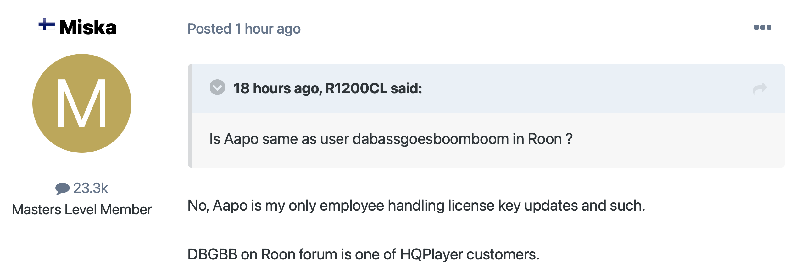

I would think that you are also HQplayer staff ![]()
I’m just the 3rd most advanced HQP user, behind Jussi and then @Chunhao_Lee ![]()
