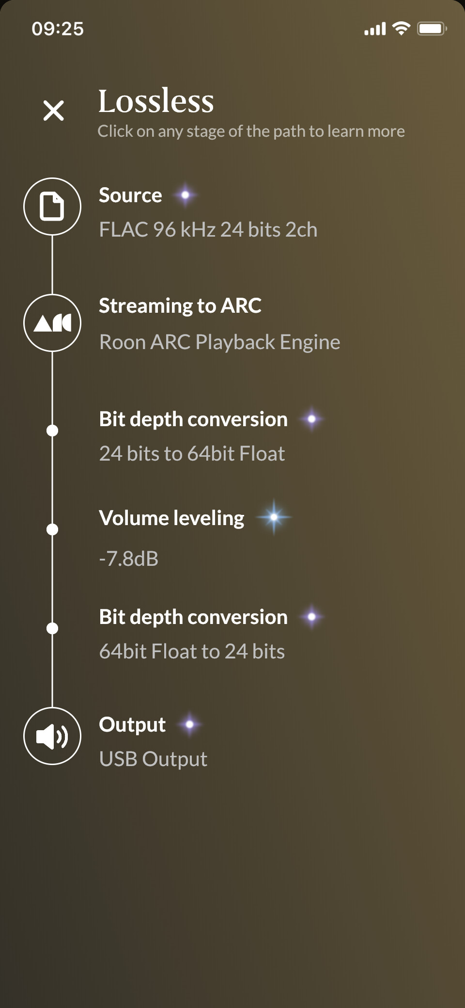

There’s no need for a portable DAC in this situation; use a powered USB DAC with an Apple Camera Adapter for bit-perfect audio to your amp via an RCA input.
All you need to do then is connect the Lightning cable to iPhone, and you can listen to music and charge the phone.
I use ARC with my Chord Mojo when away from home, but for a permanent setup I’d use something like a Qutest.
