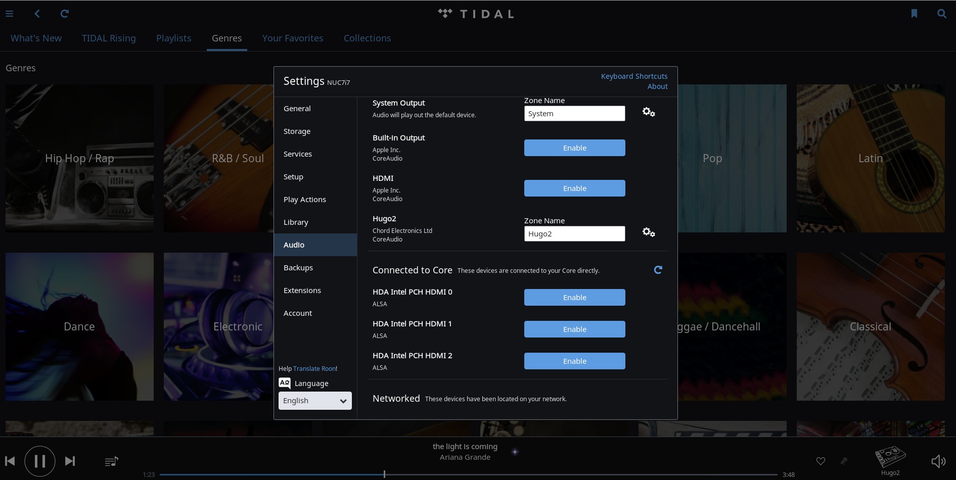

Then in Roon Settings, under Audio, youāre see a section called āNetworkedā.
If all goes well⦠youāll see your G2 there in the networked section. Then you just āenableā that zone, like you would have already done with existing zones and play to that zone.

@Grahame_Miller When you enabled streaming on the Vega G2 did you also enable the G2 in Roon in the settings, audio tab?
When you enable Streaming on the G2 the USB input will be disabled so you would expect to no longer see the usb attached MAC.
