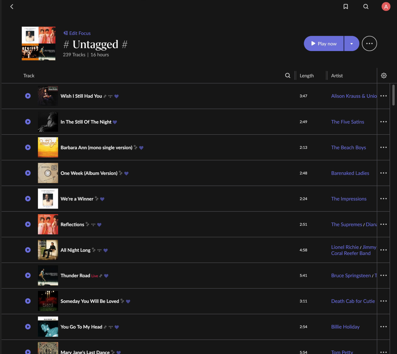

I use tags to organize my library, and I use smart playlists to identify which tracks I still need to tag. The primary list I use for this purpose had about 250 tracks on it yesterday. Version 2.53 (Build 1544) installed last night, and I noticed this morning that the list had about 690 tracks on it.

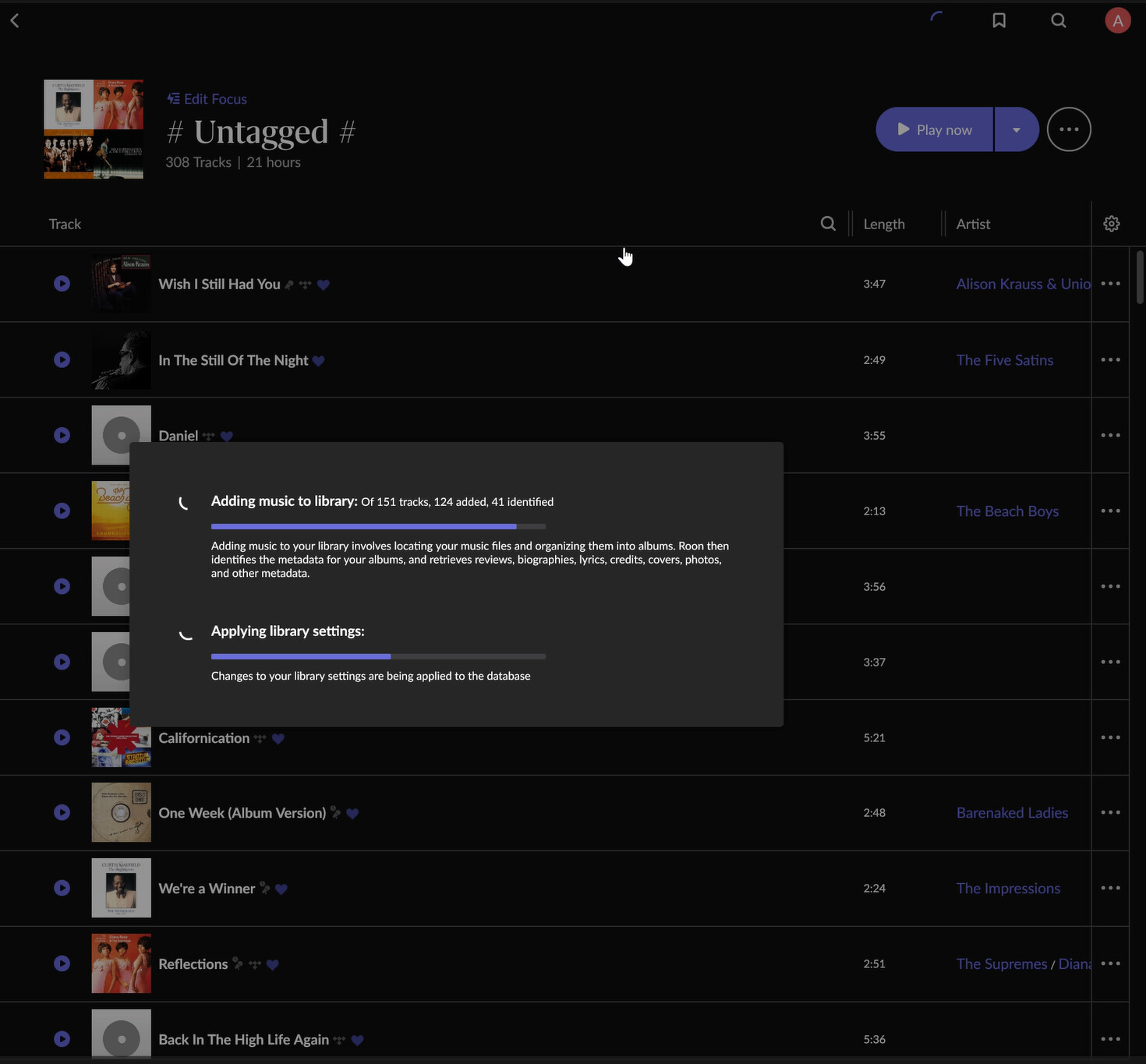

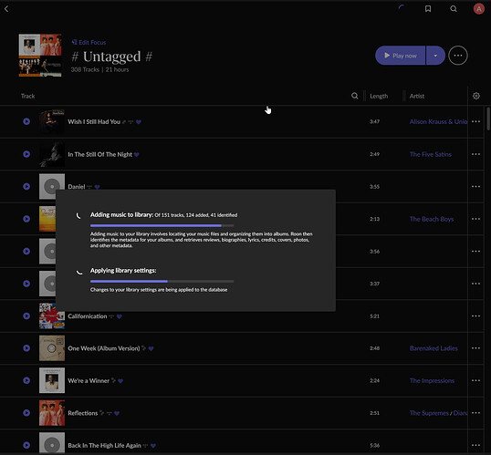

I restored a backup from night before last (under the version 2.52), and before I opened this Smart Playlist, Roon indicated that it had 159 tracks. When I opened the smart playlist, it immediately showed 239 tracks, but then Roon started adding tracks to the list. I clicked the spinny thing at the top, and it shows progress indicators for “Adding music to library” and periodically for “Applying library settings.” The number of tracks on this list went up to 714 and eventually came back down to about 700. About 550 of these are from Tidal (way more than the total number of tracks that was on the list yesterday).
I took some videos that I can link, but here are the screen shots.
