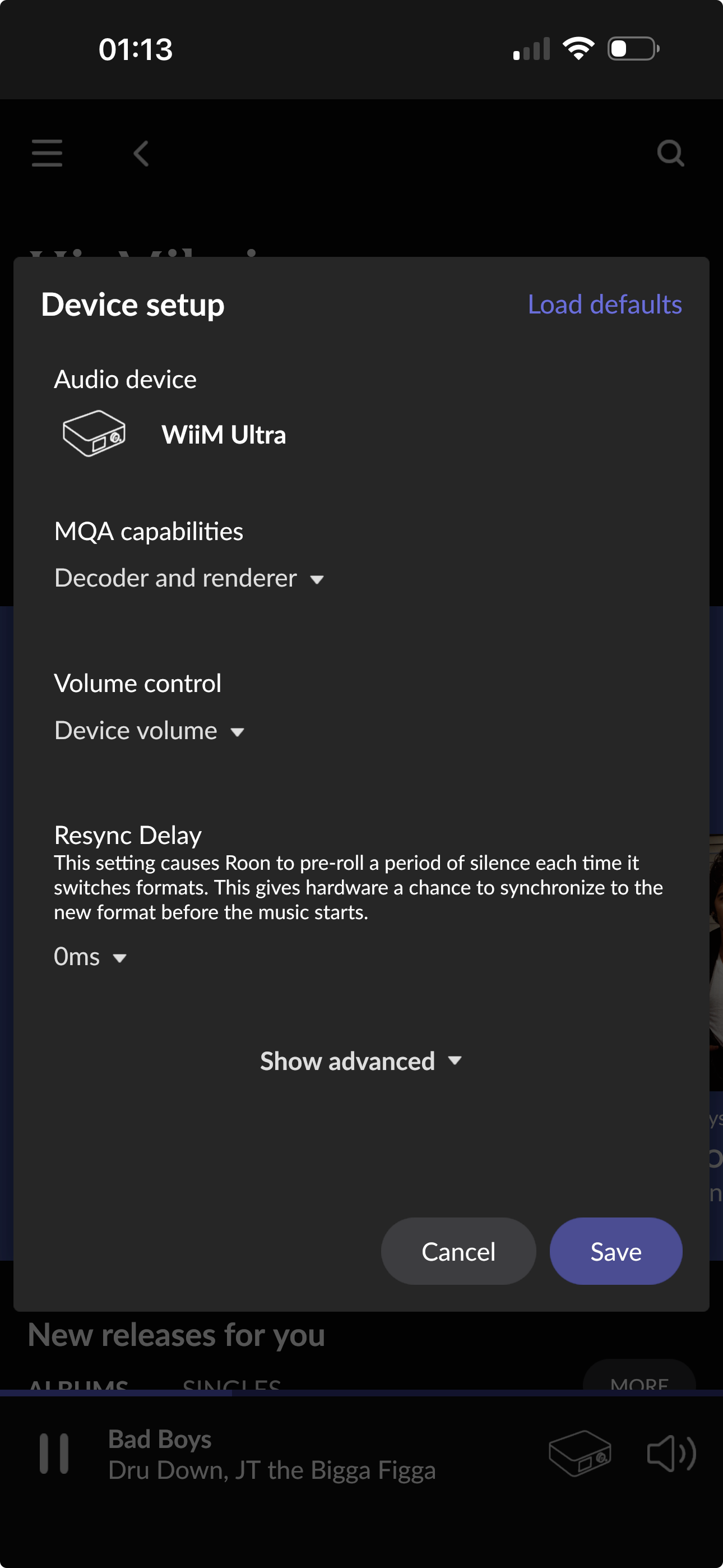

McIntosh 53 preamp (Roon Tested) connected to Wiim Ultra streamer (Roon Tested) via USB
Volume is set to device volume but it doesn't control the preamp's volume

Can you please share a screenshot of the Signal Path within Roon? We’d like to take a look at the digital chain.
Also share a screenshot of the Device Setup page for the Wiim Zone in Settings → Audio.
Keep in mind - RoonTested here refers to the McIntosh’s ability to function as a stand-alone Zone in Roon, not as an endpoint driven through a streamer. Roon doesn’t have the ability to control device volume on an arbitrary external device.

The fixed or device volume is from the streamer device setup in Roon.

It won’t you controlling the Wiims internal volume control. Roon has no control over the preamp at all in this scenario.

In this scenario the Wiim Pro is a Roon Ready device that receives the stream over the network. Roon has no idea if you’re using its internal DAC, or an external DAC via USB as the device does not communicate this back. It will assume it’s using it inbuilt DAC. Preamps over USB rarely can be controlled remotely as they don’t expose this using USB control but even if it could Roon cannot as it’s connected to the Wiim not the preamp.
