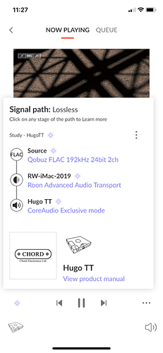

However, when I use the Weiss DAC, Roon shows the signal path as Lossy. When I play the Chord DAC it shows the signal path as Lossless. With the Weiss DAC I can control the volume via the app as well as on the DAC itself. With the Chord DAC I can only change the volume on the device.
What is going on? Obviously, I would like the signal path to be Lossless in both cases but cannot see how to arrange that.

Above are the screenshots, if anyone can advise. Thanks
As I expected, in the Weiss case there is DSP on the device after Roon handed over the data to the Weiss. Roon just reports what the Weiss is doing.
Roon applies a lights color and label to every combination in the signal path, but don’t put too much emphasis on it. If you want the Weiss to apply DSP volume, then it’s just fine if it does, whatever Roon calls it. Because of the DSP, the path is simply not “Lossless”. It is still shown as green with “high quality”.

Yes. But the Chord also controls the volume by applying a DSP (digital) volume control. The volume control is not analog there either. But Roon does not detect that.
Also, why is the volume control changeable by Roon for the Weiss but not for the Chord (or vice-versa). That would imply that the volume control itself is being applied by Roon, before it reaches the Weiss, if you see what I mean.
Whether a device implements volume through Roon, and what it reports to Roon that it is doing, is up to the device.
Hugo TT is Roon tested ˋonly´ as opposed to the Weiss which is Roon ready.
So, Hugo TT can‘t talk back to the server, thus Roon is oblivious to what‘s done by the DAC and can‘t report the ˋmanipulation´.
With the Weiss, it’s the Roon ready integration that lets the server know what going on in the DAC, (edit: thus also allows for controlling it‘s internal volume adjustment).
Thanks. It’s convenient that the volume can be controlled by the Roon App as long as the volume adjustment is still done in the Weiss, which is specifically adjusted to ensure no real-world loss of precision.
Roon‘s 64 bit floating point math ensures no loss of ˋreal-world´ precision either, so no sweat … also see our member‘s @DrCWO measurements regarding Roon DSP volume control.
