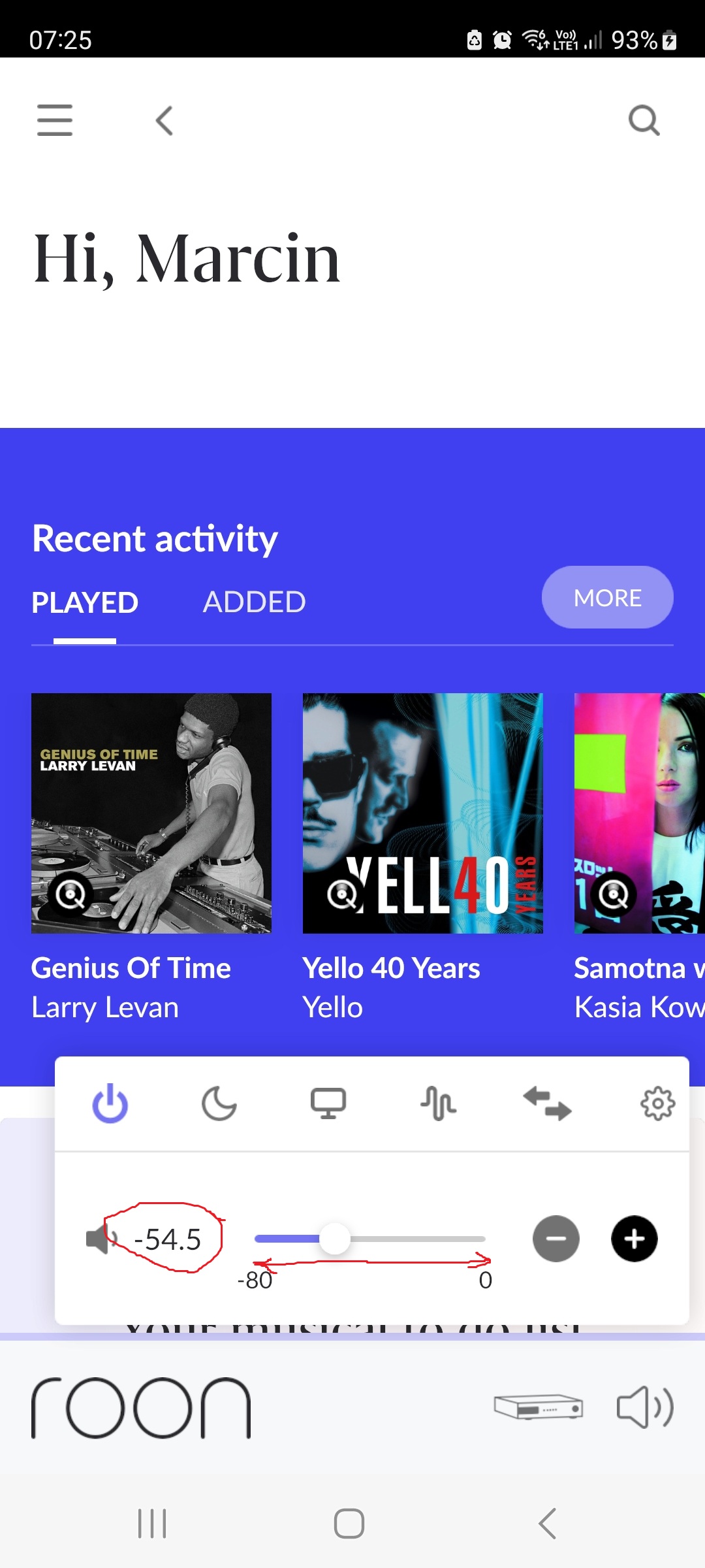

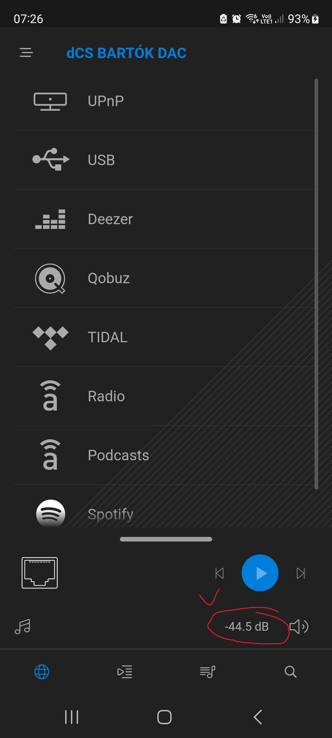

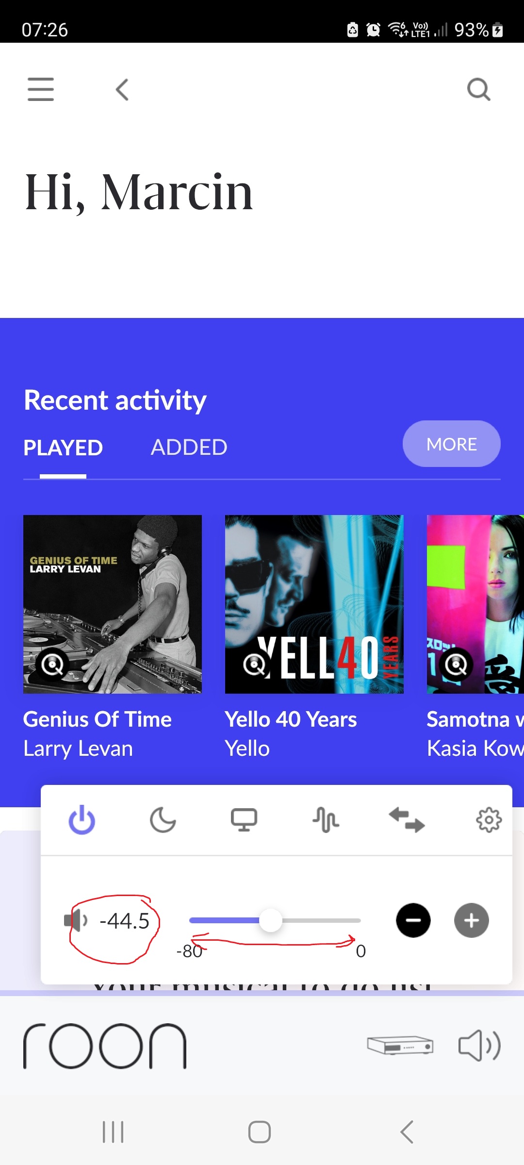

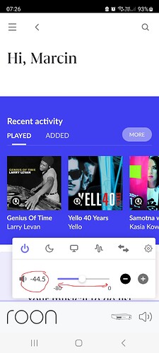

In the Roon application, if you only use + or - in the volume setup, every change is made in 1dB steps. If you are below -50dB on the dCS Bartok, it is not possible to set 0.5dB steps. In the Roon application, if you use only the volume bar directly (without + or -) in the volume setup, each change is made in 0.5 dB steps (in full volume), but if you are above -50 dB on the dCS Bartok, you will not see -55.5, but only -55 (because between -50 dB and -80 dB: 1 dB steps). If you are below -50 dB on the dCS Bartok, everything is correct (0.5 dB steps).

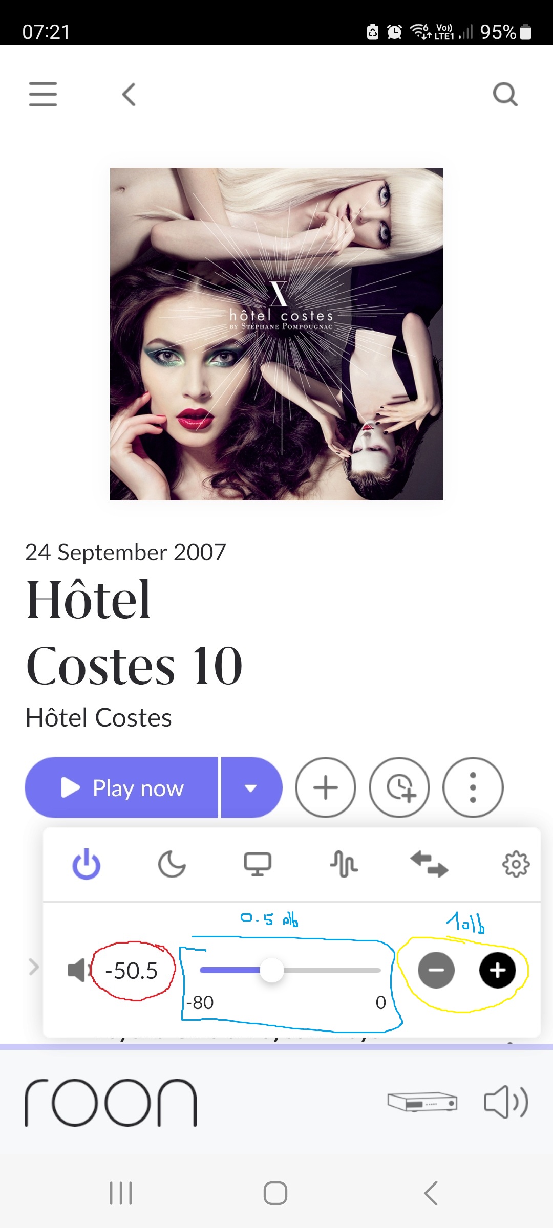

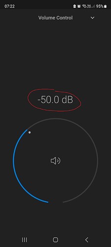

The “problem” is the volume setting “slide bar” itself in the Roon application. In the dCS application there is only a “slide bar” (without + and -) (fig. 1) and this works 1:1 like the knob on the front of the unit (always as described in the dCS documentation). In the Roon application you have “slide bar” and + and -. If you only use + or - in the volume setup, any change will be made in 1dB steps. If you use only the volume directly (without + or -) in the volume setup, each change is made in 0.5dB steps (fig. 2a).

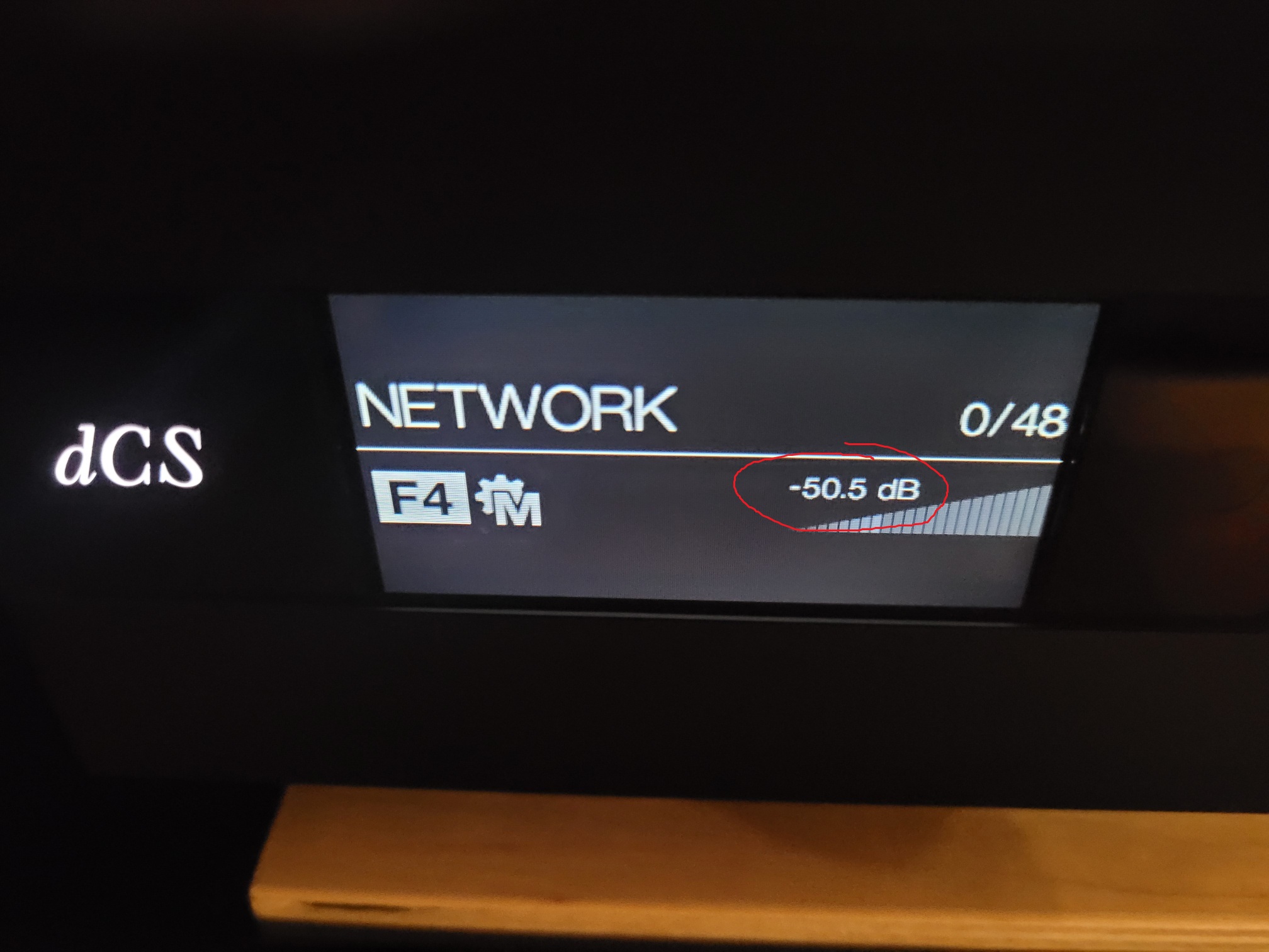

This means that I can set the volume in the Roon application (with a “silde bar”) to -50.5 dB (shouldn’t be possible if you read the dCS documentation) and this will be set in dCS Bartok (fig. 2b) and in the dCS application you will still see -50.0 dB (fig. 1).
It all depends on what you are doing in the Roon application: “slide bar”: 0.5 dB steps" and “+ and -”: 1 dB steps. In dCS Bartok it will be the same setting as in the Roon application (should not be possible if you read the dCS documentation), but it will not be the same dCS application.
