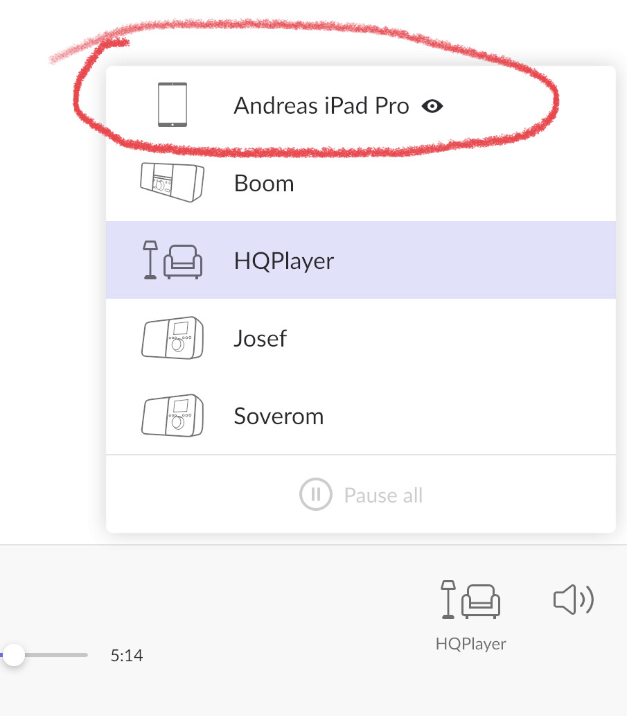

However, now the picture below isn’t available when in remotely connected.
Which means I can’t access it as a zone. (Privat Zone on/off didn’t help).
Doesn’t matter if enabled or not.
So is this a bug ?

Below is picture with and without VPN enabled. (VPN over cellular). So i can play to all other devices using VPN.

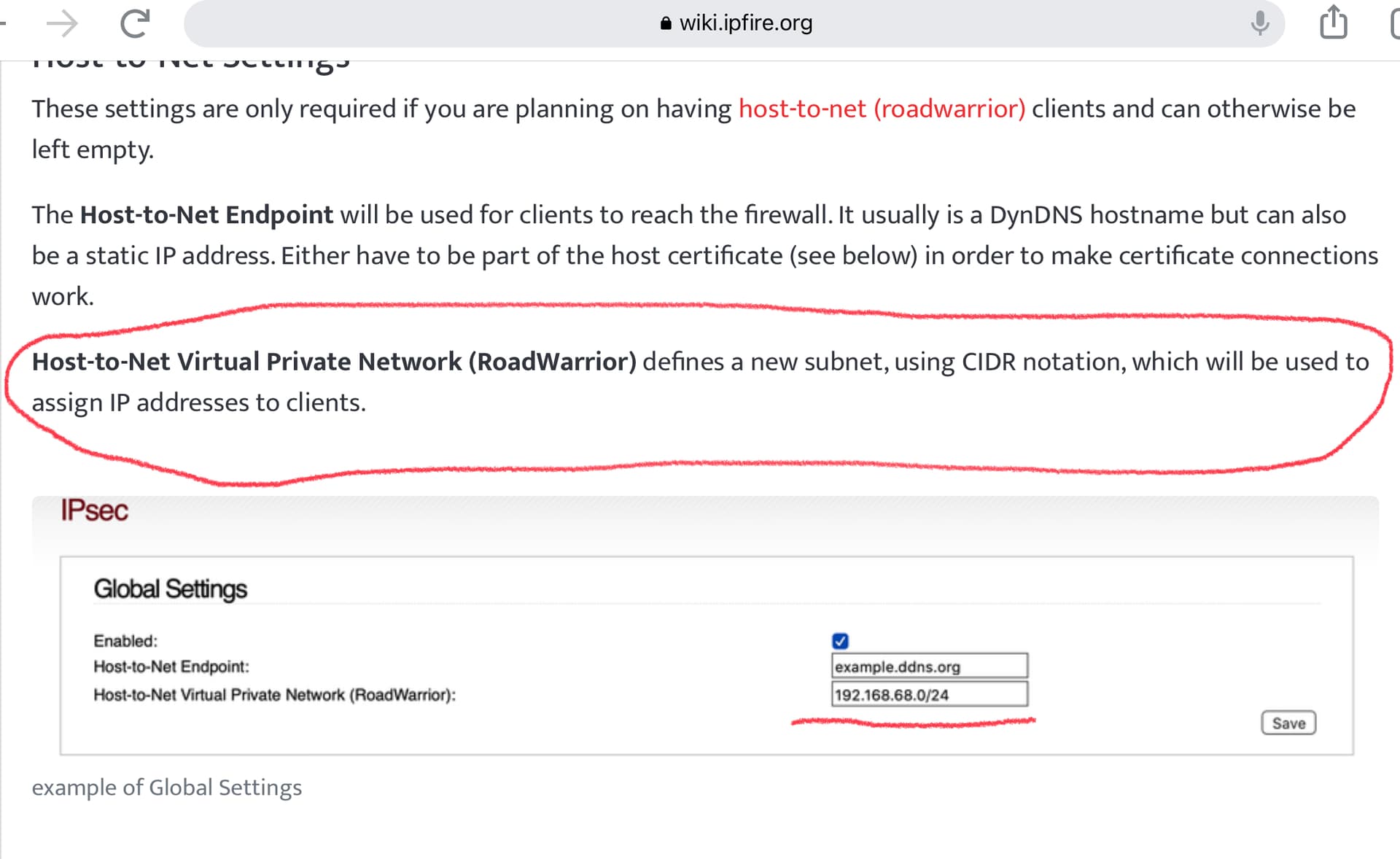

I think maybe the source to the problem is here wiki.ipfire.org - Global Configuration
I also asked over at iPfire community:
