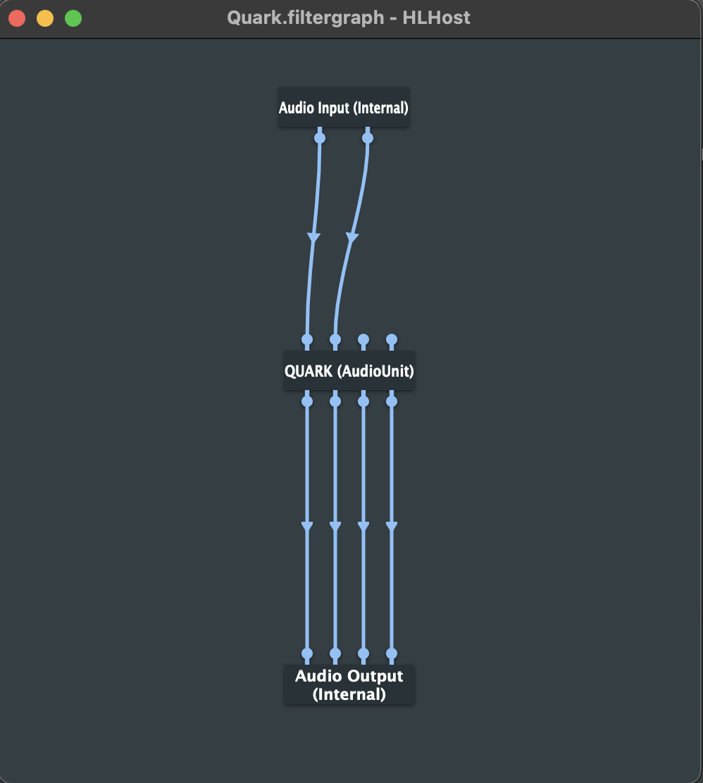

The two screenshots I’ve uploaded here show Mitch’s app with, in one case, the use of a cross talk cancellation plug-in, where the number of inputs and output are both two.
In the other case a decoding of Quad QS, whereby two input channels result in 4 output channels. In this case the input device is BlackHole (where Roon is set up to send its output). The output device is a multi-channel DAC.
