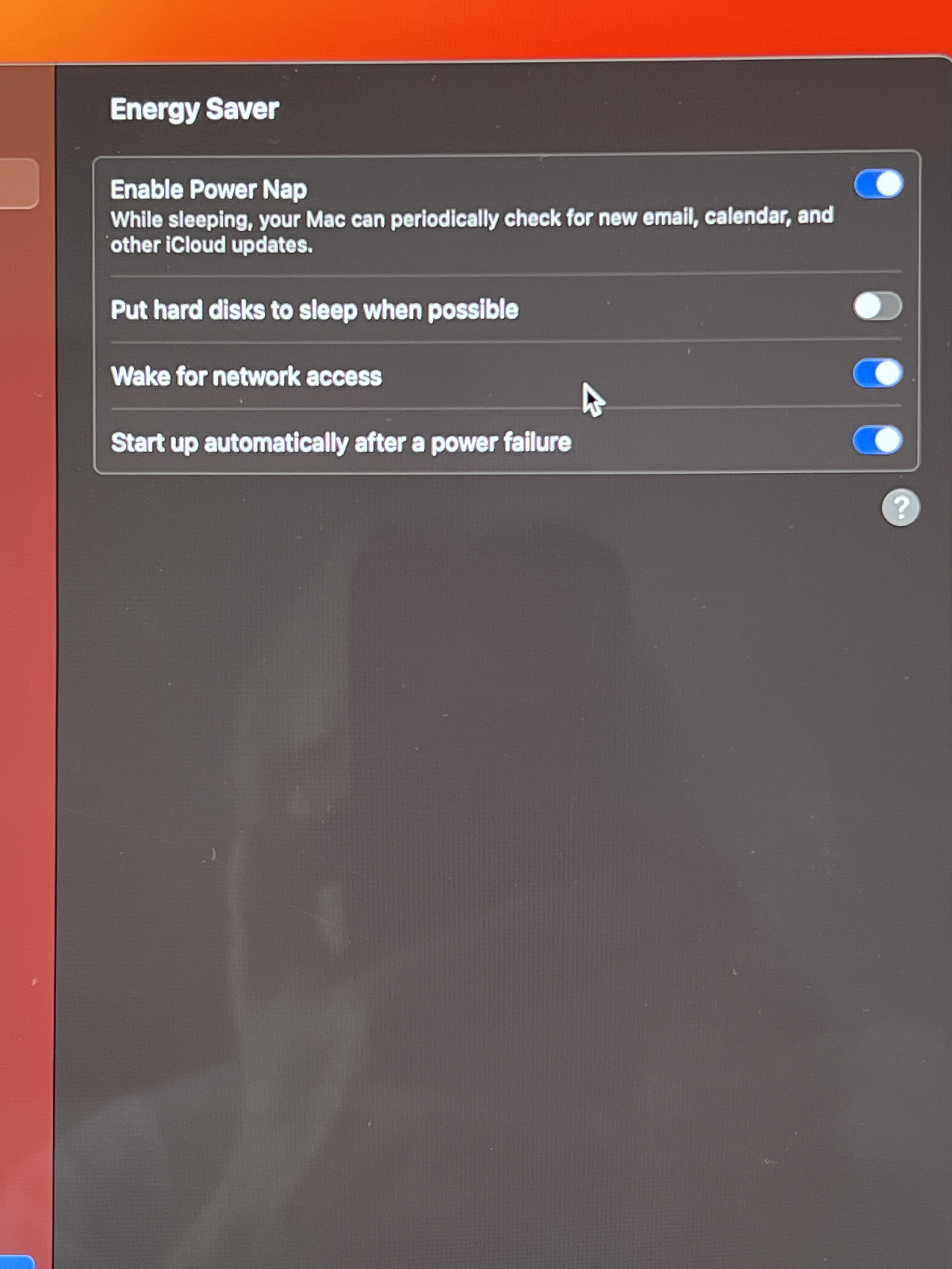

This may be off the mark, but have you looked at the Energy Saver settings on your iMac? Reason I’m asking is that Apple updates sometimes “helpfully” change these to a more energy-efficient configuration, which is fine for interactive use but not for a server that has to be always on. Here’s how I set up my Mac Mini M1 server (for HQPlayer, my Roon servers are on Linux):
Screenshot 2024-03-04 at 7.04.48 PM
Thx for the tip. I take it the blue settings are “on”?
I’ll see if there is something similar on my iMac.
Love easy-to-implement-and-test suggestions like this!
Bruce
Yes, blue is “on”.
Made a few Energy Saver iMac adjustments. Let me know if you see anything else here that might help.
