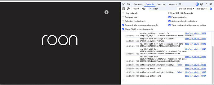

Thanks for your effort. I have reproduced the issue again, this time on a machine where the display never renders.
Timestamp:
2026-03-24 15:15:05 CET (UTC+1) — 3:15:05 PM local time
Test:
Started Roon and opened Web Display in Chrome on a Mac (M1). The page loads but remains on a grey screen with the Roon logo and no UI is rendered.
I have attached a screenshot of the Chrome Developer Tools console from this test.
Hope that helps!
Hello @dwi,
Thank you for the precise timestamp and the excellent screenshot! This is incredibly helpful.
Since this specific test was performed on an M1 Mac, a very common culprit for this exact behavior is macOS’s strict Local Network privacy permissions. Even if the apps are already granted access, the underlying permission state in macOS can sometimes become desynchronized, partially blocking web socket communication (which the Web Display relies on).
Let’s try forcing macOS to refresh these permissions by re-toggling them:
  1. Open System Settings on your Mac.
  2. Navigate to Privacy & Security > Local Network.
  3. Look for both Roon and Google Chrome in the list of applications.
  4. Toggle the switch OFF for both of them, wait a few seconds, and then toggle them back ON.
  5. Completely quit and restart both the Roon app and Google Chrome, and reboot your laptop.
Give the Web Display another try after doing this. Does the UI finally push through and render, or does it remain stuck on the grey logo screen?
