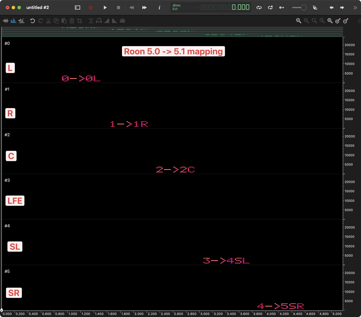

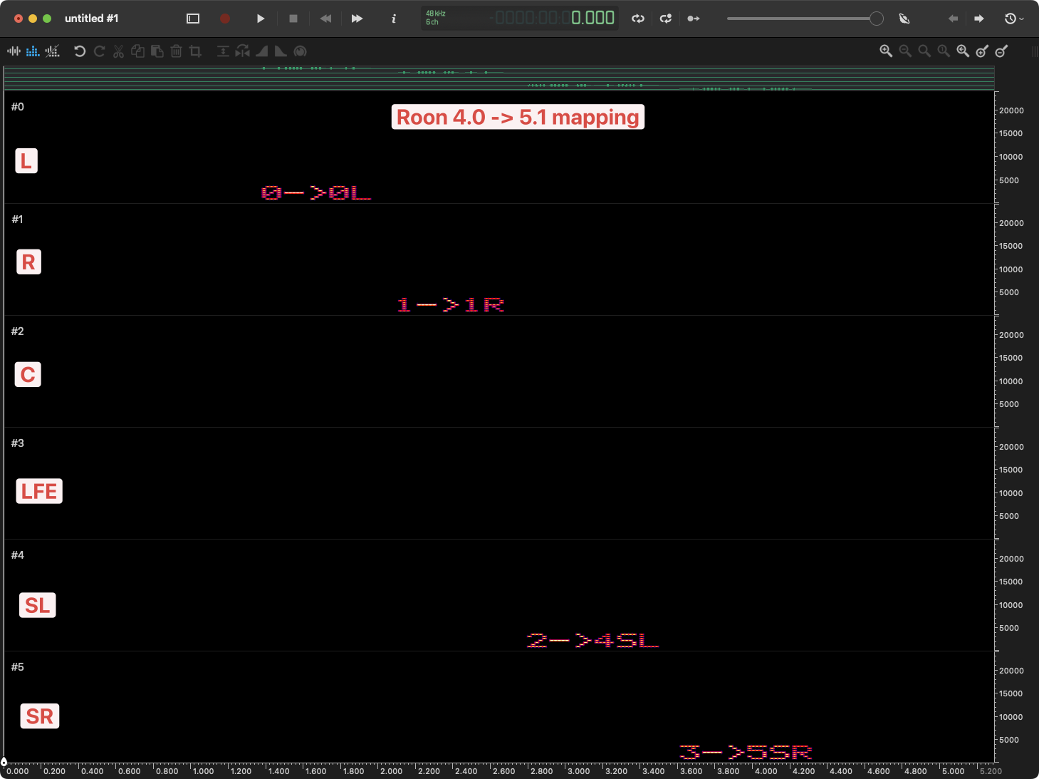

Apologies for the delay here! Roon only re-maps channels when upmixing, there is no modification happening. See the screenshots below for more info:
The main difference between the mapping of 4.0 and 5.0 to 5.1 is 5.0 includes the center channel. Hope this helps! :+1:
