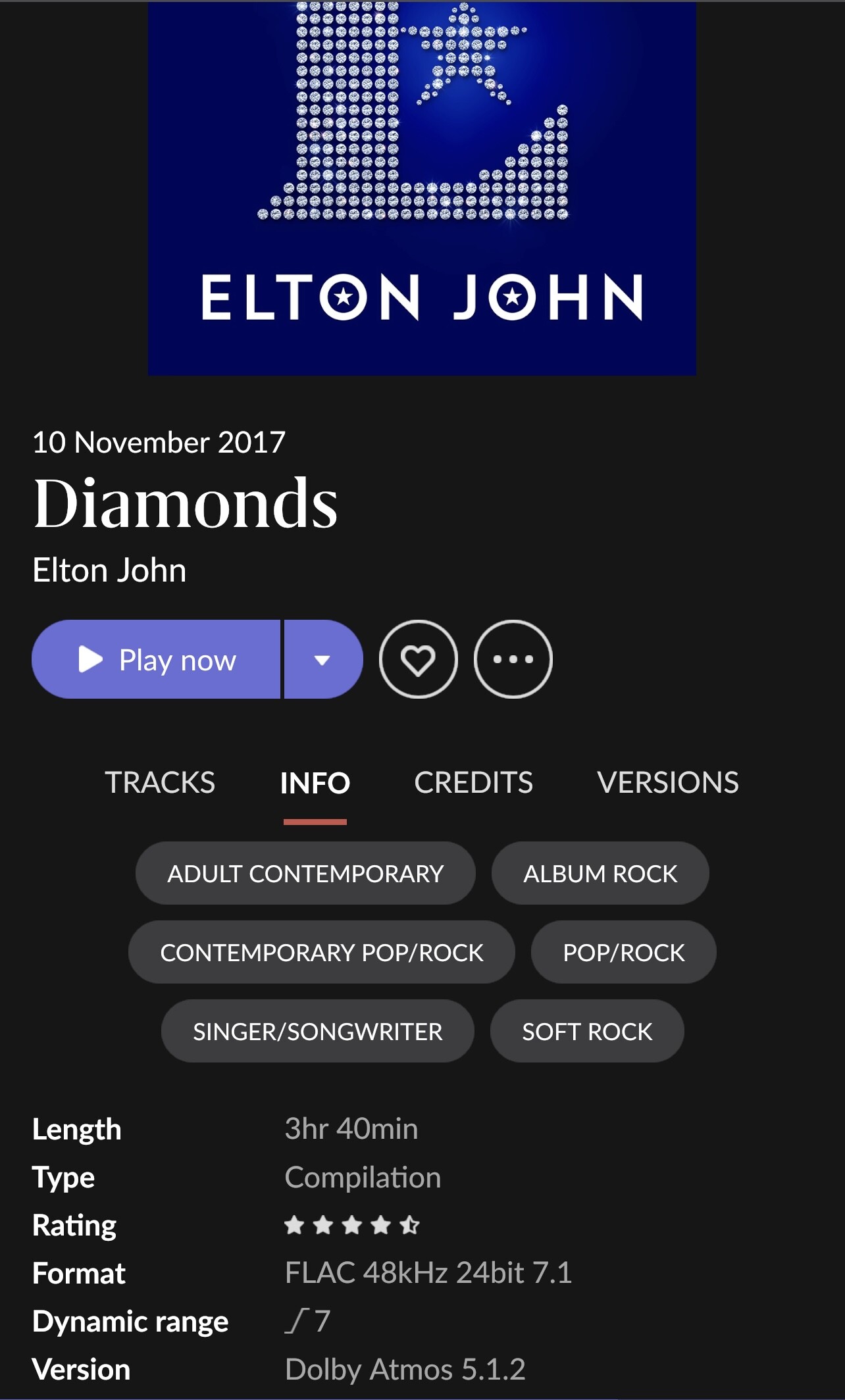

I have just over 100 Dolby Atmos albums in lossless 24/48 TrueHD from either Blu-rays (ripped to MKV files using MakeMKV) or MKV downloads. Roon can play them in a Dolby Atmos 5.1.2 array if first converted using the Dolby Reference Player (a one-time $400 or so purchase) and the shareware MMH Atmos Helper (which automates using the DRP to convert Atmos to wav files that correspond to a 5.1.2 Atmos speaker array). I elect to convert my wav output files to FLAC. More than eight channels, such as for a 7.1.4 Atmos array, won’t work in Roon.
Yes, it takes a bit of work but only one time per album.

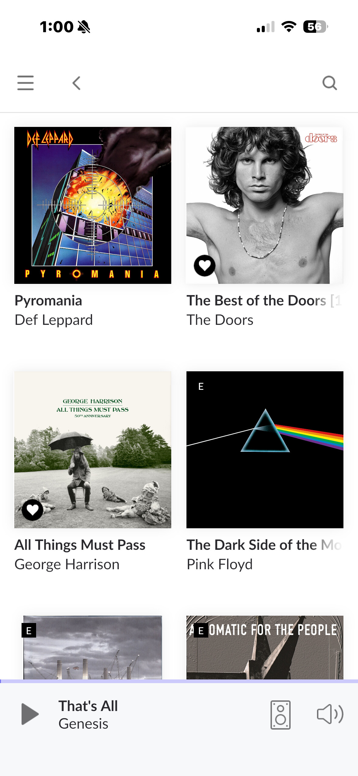

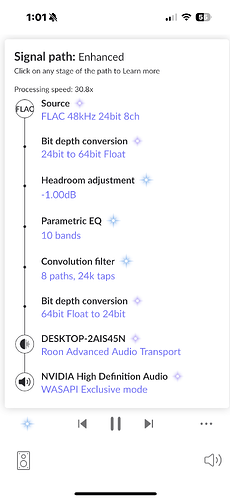

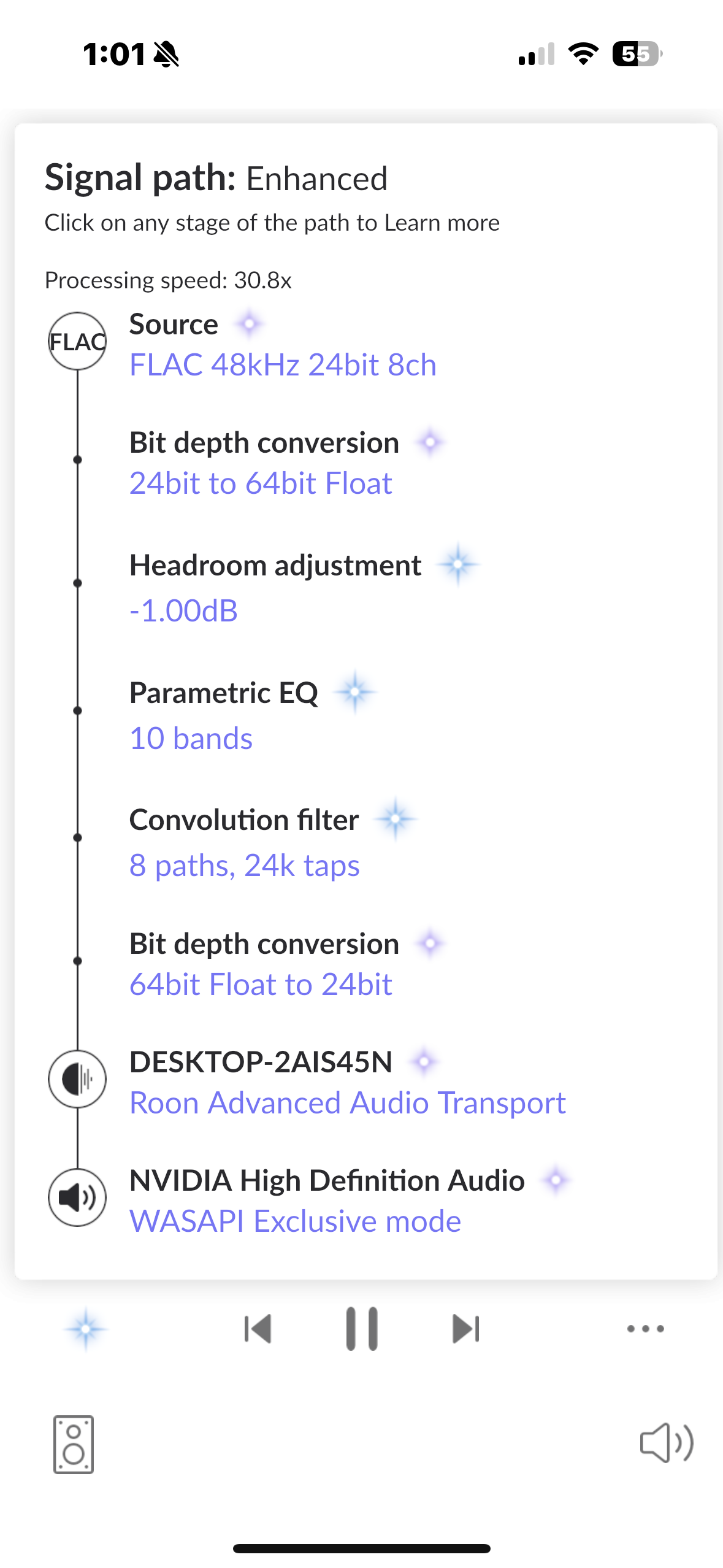

I just wanna comment on this. Roon will play Atmos files. I have ripped several of my Blu-ray. Atmos, audio, albums, and ruin plays them great. Rush Signals and the new Doors Greatest Hits, for example, are great and my
Denon receiver plays them just fine. They sound so much better through Roon than from my Blu-Ray player.
Roon path shows 8CH which means it plays only the discrete channel base layer of Atmos ditching all immersive information (which anyways get lost the moment you transcode it to FLAC). I agree it can sound great but it is not Atmos but 7.1 downmix.
To play native Atmos retaining the immersive information you need a file format such as .MKV or Atmos embedded in .m4a which roon would not handle.
I hope this answers your question. When I play Atmos material, I set the Advanced Device Setup for “Swap Rear and Surround Channels” to “No”. For all other material — 4.0, 5.0, 5.1, 7.1 — I select “Yes” for that setting. JCR
