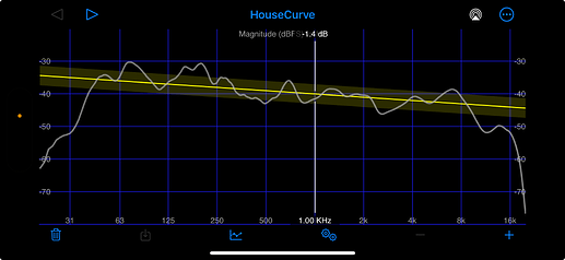

Also, if the OP has an iPhone he can try HouseCurve and measure what’s going on in his room.

Here is a recent measurement from HouseCurve:

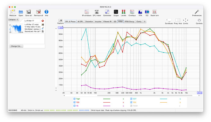

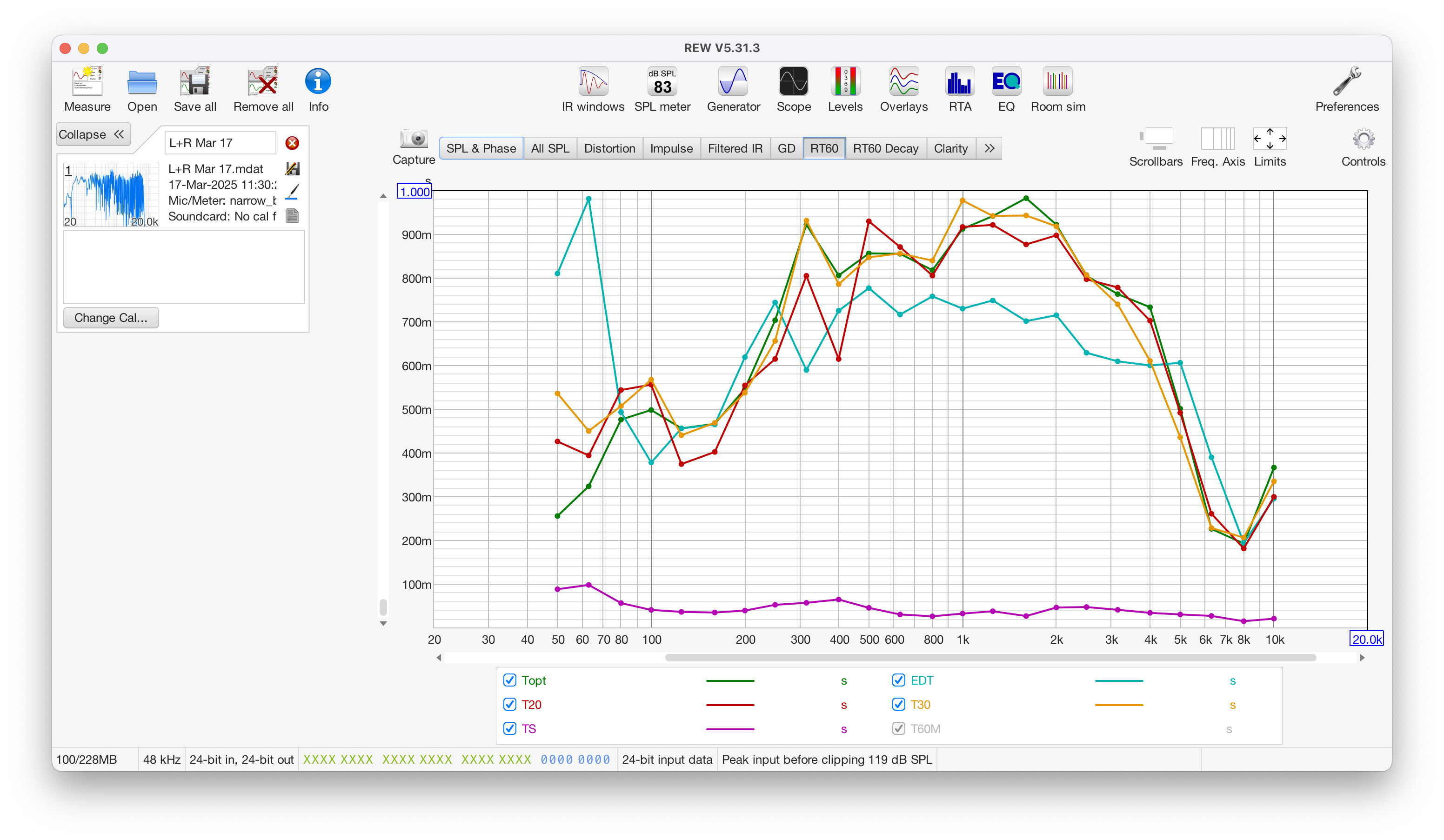

got out my umik-1 and rew and oof this is quite the reverb situation
I think this is telling me the living room is not the right room in which to enjoy my hifi !
time for a man cave I guess lol

Very unusual RT60 which might also result from REW´s time windowing combined with uneven D.I. and some cancellation resulting from room modes, so to know more measuring with designated omnidirectional speaker in a fully diffuse field would be more precise. Room acoustics are definitely on the difficult side when it comes to finding matching speakers and listening distance.
There are speakers to handle such situations if the listening distance is not extremely high. Something like fullrange horns, line sources or cardiods might do.
