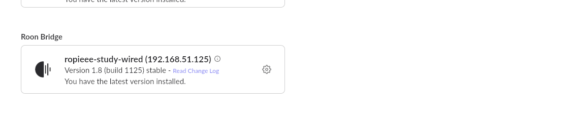

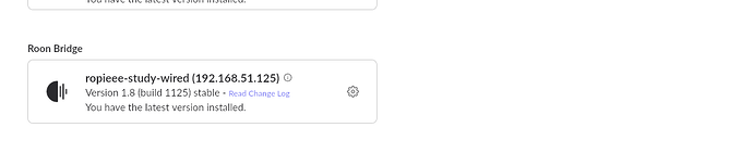

Roon Bridge installed …

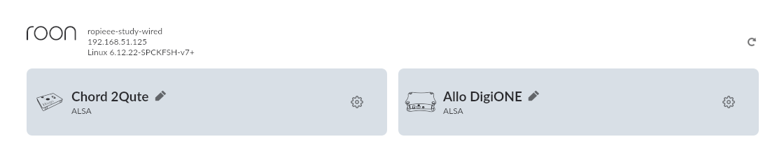

USB connected DAC plus DAC hat on same RPi …
My Chord Qutest has been connected to Ropieee for years … after a lightning strike this week I had to replace to Raspberry Pi 4 as the ethernet port was fried …
New R Pi … recognized as a bridge but no Qutest seen distal …
Previously the ropieee would show in the audio devices tab when it was connected to my Oppo.
