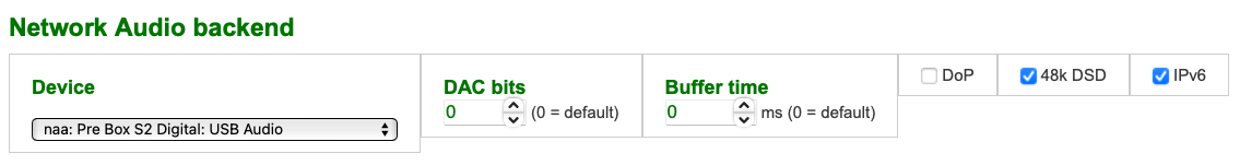

can anyone tell me what to set for dac bits in hqplayer? or just leave it at default?
thanks!
Since Modius uses AKM DAC chip (AK4493), you can just leave DAC Bits to Default.

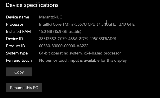

What kind of CPU do you have if ext2 doesn’t work for you?
I changed other items and have ext2 working.
