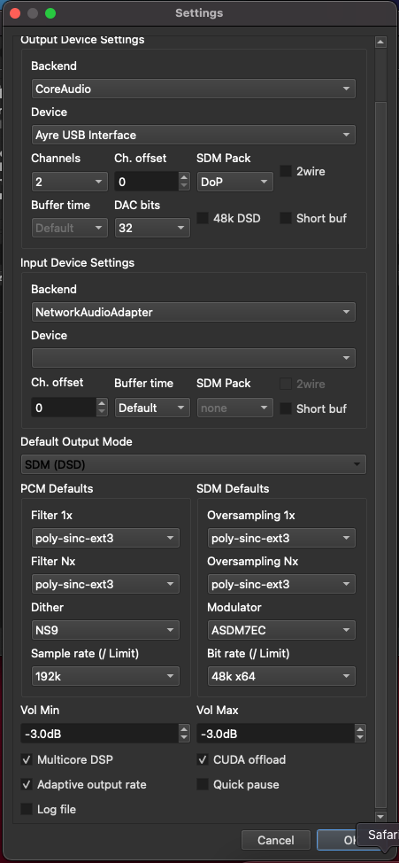

Hi Guys, have a question. I had been using HQPlayer 4 under Windows Server 2019 with intel nuc however its power not enough to process new ext3 and ASDM7ec especially case of Nx. So I thought that the new mac mini m1 will be a good choice, and yesterday did a try however PCM → DSD upscaling didn’t work for Nx.
It could do upscaling 44.1 to DSD64, however, didn’t work if I select 96 or 192/24 songs. Also, I’m using Roon as a separate server.
I tried different ways, like using my old nuc as an NAA and M1 as an HQPlayer desktop but the results were the same. My DAC is Ayre QB-9 DSD.
Kindly need support or suggestion, have a great day guys!
Tried with CUDA offload checked and it does seem to work now. :slight_smile:
Thanks for an answer man now it’s working however not for ext3 :(. I restarted the app after the config change. it’s frequently pausing the song every second.

I can’t see anything wrong with your settings. You could try greying out adaptive output rate but I don’t think that will make a big difference to processor load.
We’re all finding out what the CPU/GPU requirements are for ext3. It seems to be quite demanding, particularly with the EC modulators and higher fx source material.
Thanks, Andrew, I just saw your message, so it’s a general issue then, we don’t know the ext3 process demand yet. Also, the stutter is an issue with ext3 even I select a non-EC emulator. However, I’m pretty sure that M1 is enough to process Ext3 and ASDM7ec.
I think of investing in a more powerful graphic card. This might be needed seeing Jussis direction with HQPlayer. Hope prices come down for the newest generation.
