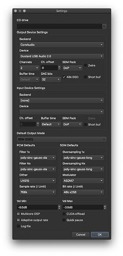

Pulled the trigger on HQP the other day. I settled on poly-sinc-gauss-long using the ASDM7 modulator to upsample to DSD256x48 into my Gustard X16. So far impressed with the overall increase in SQ versus Roon’s upsampling.

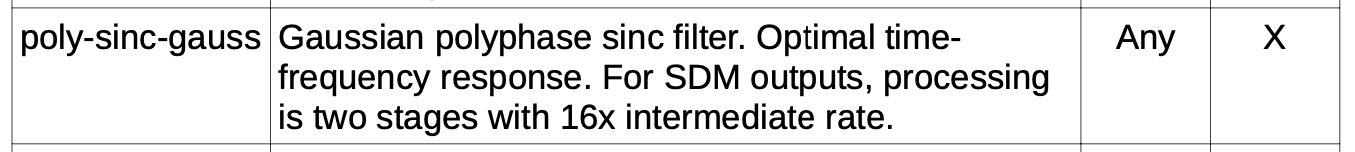

I’ve been using standard poly-sinc-gauss for a few weeks now and not had any interest in changing or trying something different.
