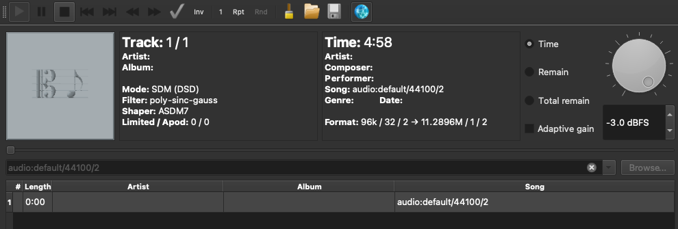

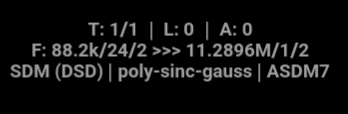

I know you said EC modulators have better transient response. And when I upgrade Mac I will use EC modulators because I will feel better inside knowing it is technically better.
But comparing ASDM7 and ASDM7EC I don’t here any different with this track at the moment.
Of course ASDM7 is already high quality!

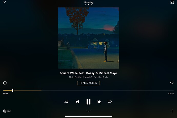

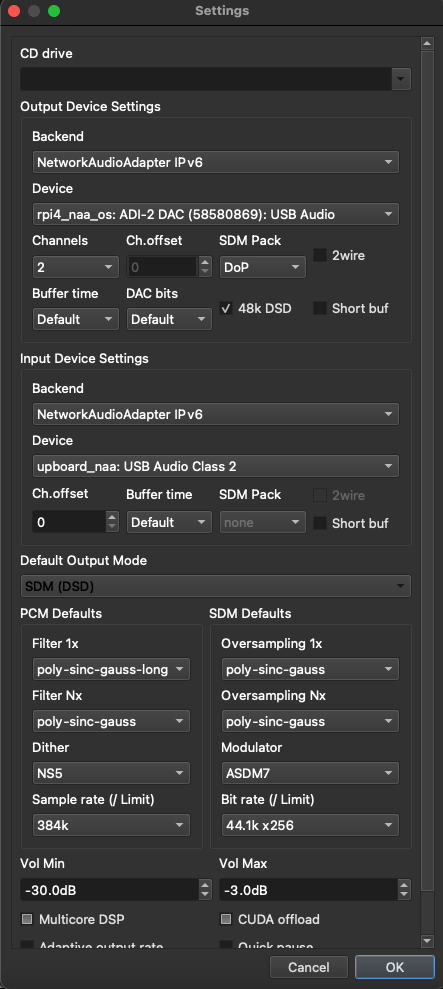

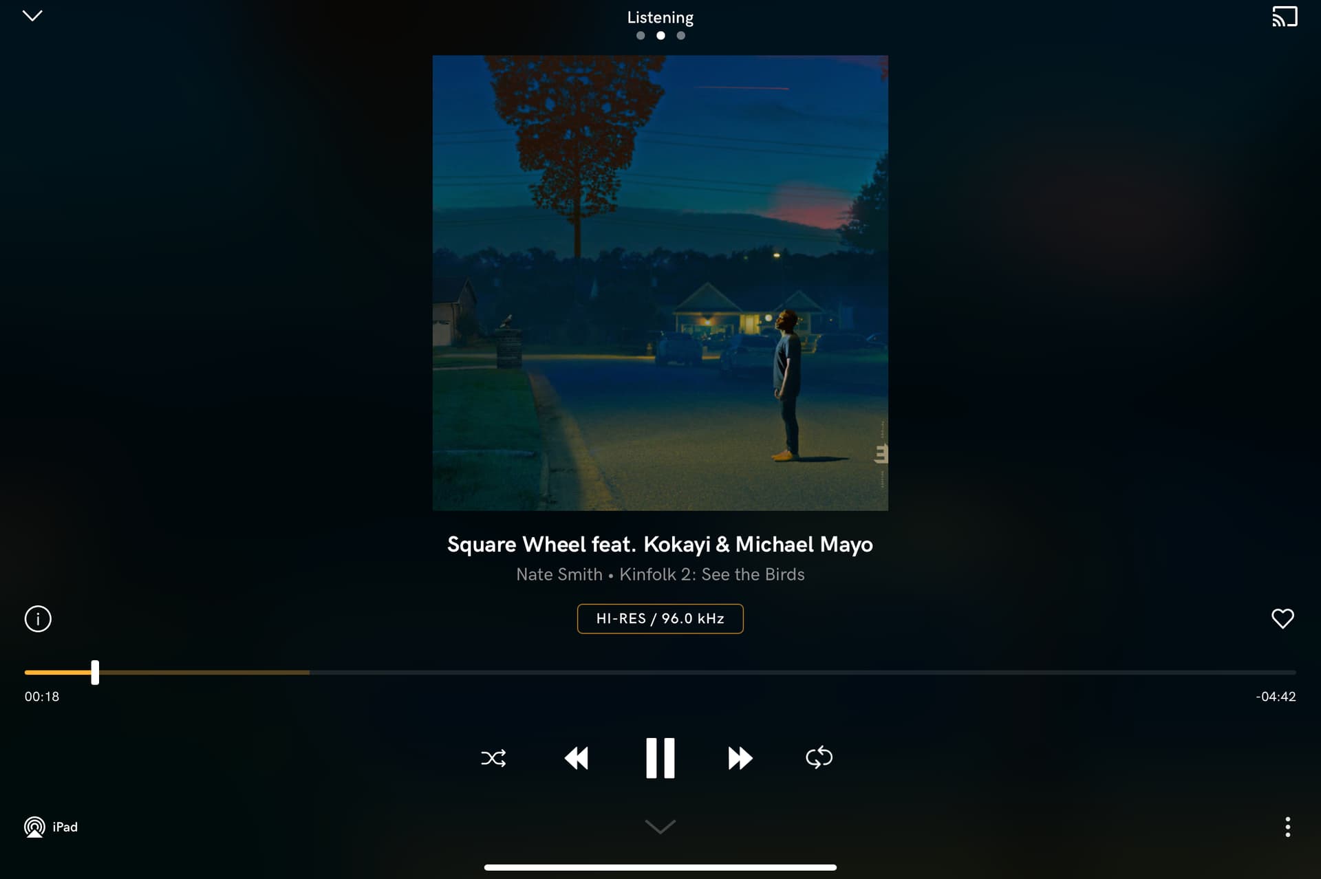

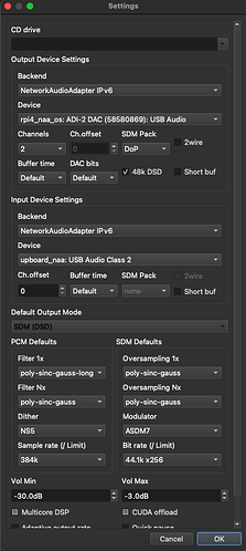

Qobuz official app on iPad 4 → 24bit/96kHz UAC2 input of UpBoard Gateway → HQPlayer DSD256 poly-sinc-gauss → RPi4 NAA OS → RME ADI-2 DSD Direct → SMSL SP400 THX AAA 888 headphone amp → Focal Utopia Headphones
Both sound fantastic !
Is this music not punchy enough to demonstrate the difference?
I too have been having positive results with the poly-sinc-gauss, ASDM7, DSD 256 as well.
What’s best is that my 6 year old laptop, i5, 8 gb ram running the HQPlayerEmbeded USB image handles it just fine.
Great use of previously unused gear.

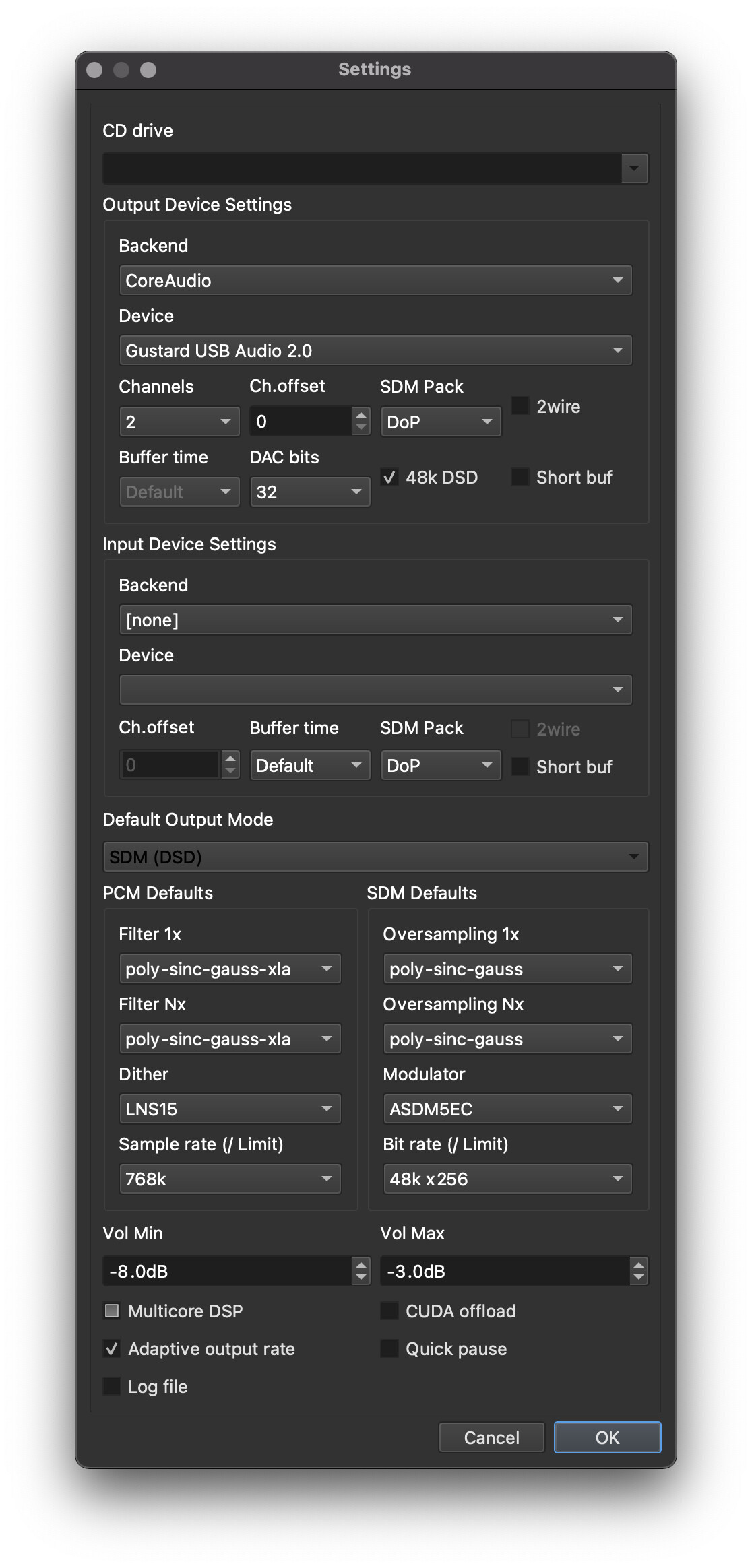

I just realized I’m able to run poly-sinc-gauss with the ASDM5EC modulator as long as adaptive output rate is checked. This is light years better than ASDM7 (and ASDM7EC is not an option on my 4 GHz Core i7-4790K - Devil’s Canyon). I’ve settled on the following for now, which is already pushing the limits of what my CPU can handle.
At present I am using HQPlayer as an alternate sound engine for roon. I have the filters and shaping set to none. It is a definite improvement. If I go back to filters it will probably be pcm and guass family.
I agree, ASDM5EC is great. Have you tried AMSDM7 512+fs with poly-sinc-gauss? For me it uses roughly the same CPU as ASDM5EC, but sounds better on my setup.
I’m only upsampling to DSD256, but I gave it a shot and its immediately more fatiguing (which is unfortunately since it takes up half the CPU of ASDM5EC on my setup).
I think you have to use at DSD512 to get the fully benefit. But like most settings with HQPlayer it’s all about synergy with your setup.
I went back and re-tried ASDM5EC and really enjoyed it. I may split time between these setups and see which one is more enjoyable long term.
