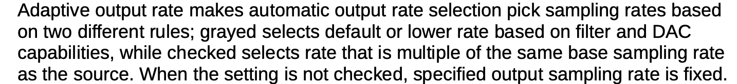

Do you have Adaptive Output Rate checked?
yes, checked, not grayed. Grayed will result in conversion between clock base frequency, which is more CPU intensive.

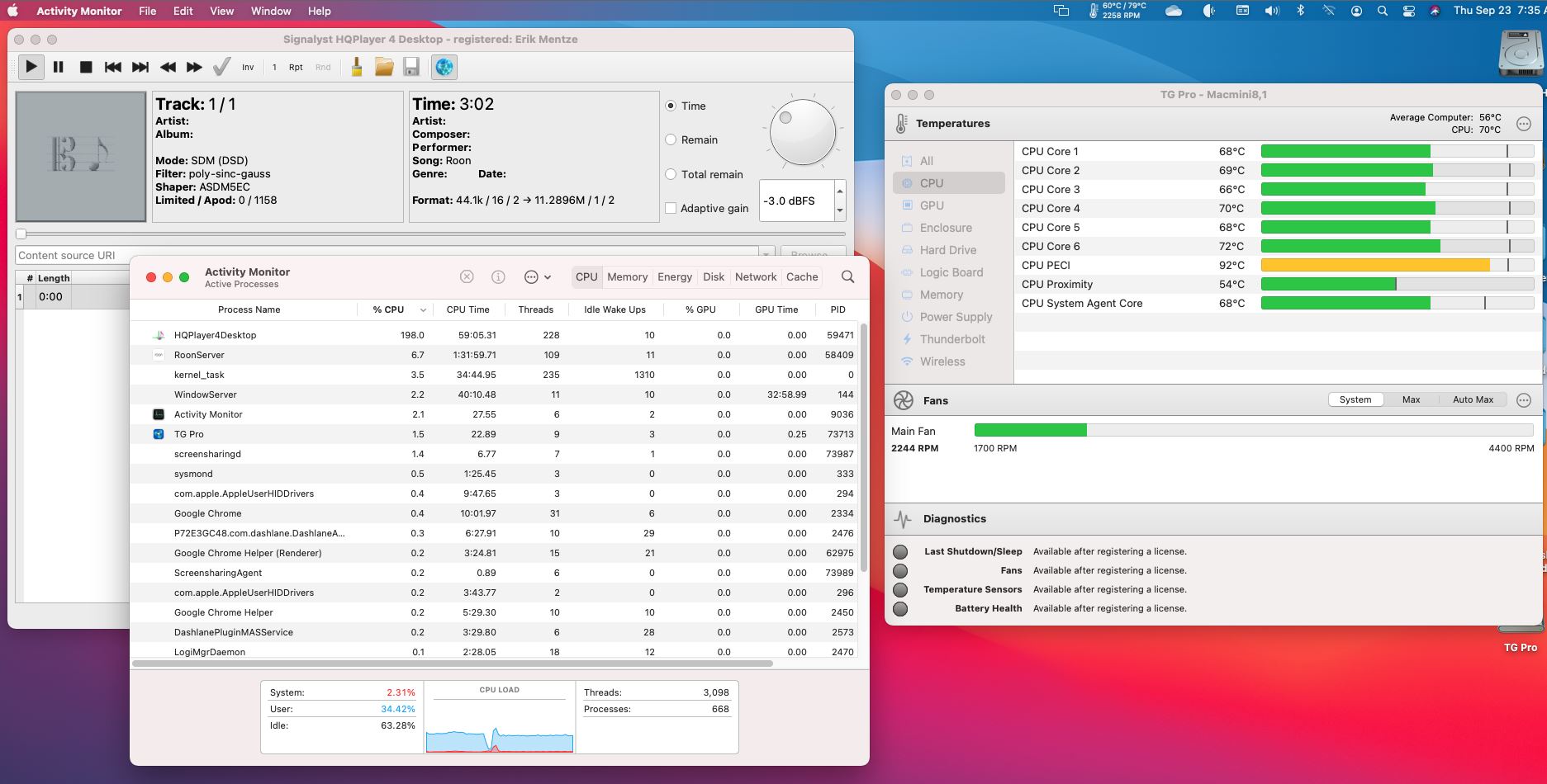

I have the same Mac. One thing to be careful is even if it works and fan noise seems quiet, I see some CPU cores running over 90 deg C continuously with EC modulators.
For long term CPU life, this may be an issue. I don’t know.
You can use an app like ‘TG Pro’ to monitor CPU core temps.
Compared with my i9-9900K machine with Noctua fan in Fractal Design case, CPU temps never go above 65 deg C.

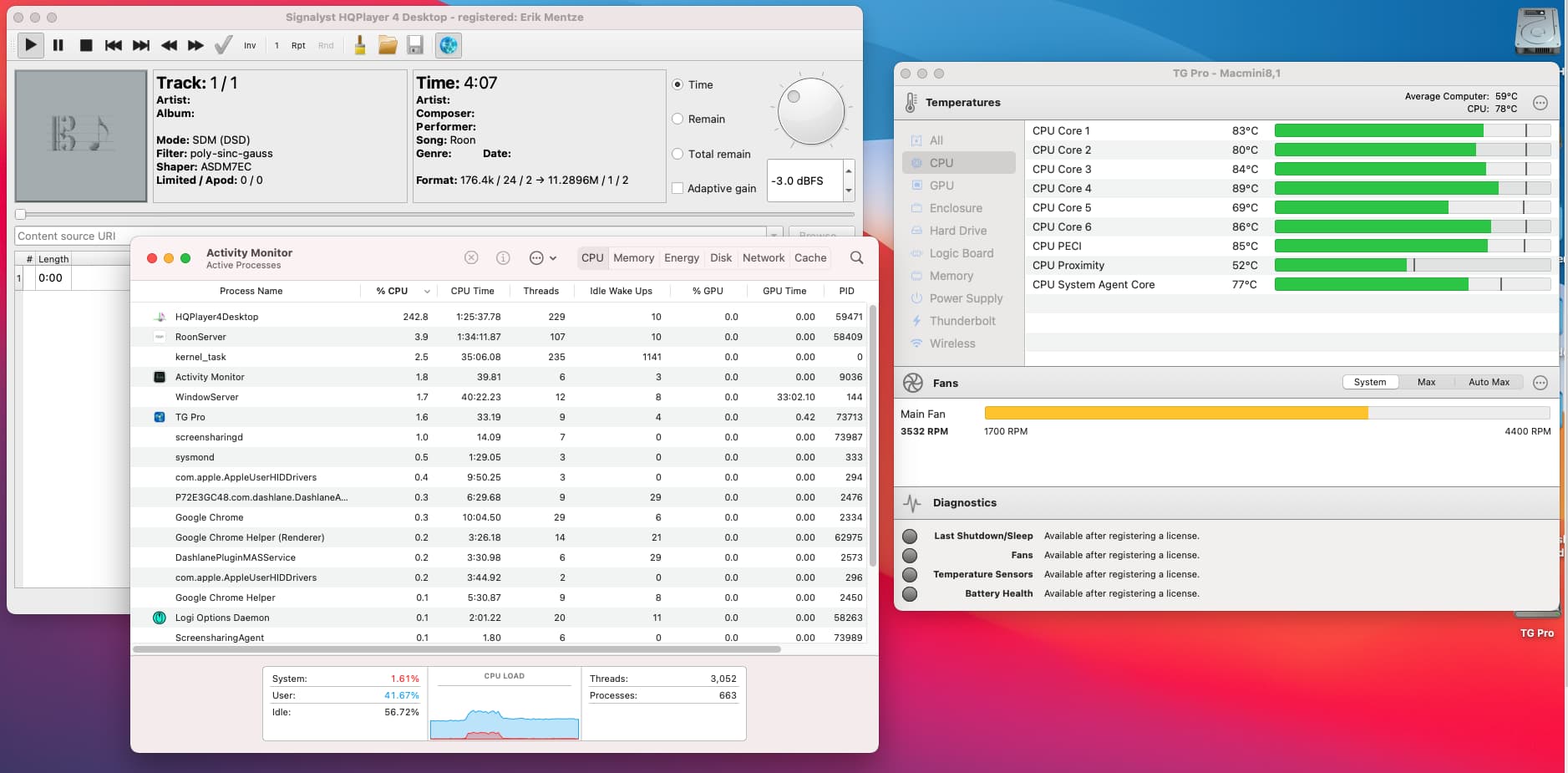

Interesting. I downloaded TG Pro this morning to look closer at this. Here’s what I get:
ASDM5EC DSD256
ASDM7EC DSD256
The system is definitely working harder with 7EC. The main fain is running much faster. But the average CPU temperature is ~70C for 5EC and ~75C for 7EC. (It bounces up and down +/- 5C around those points.) So really not much of a cpu temp difference, about 5C - 10C warmer with 7EC.
That said, I have external fans blowing over the mac mini to help keep the case temperature down. I noticed my case temp go from 35C with 5EC to 39C with 7EC. So I am dissipating more power for sure.

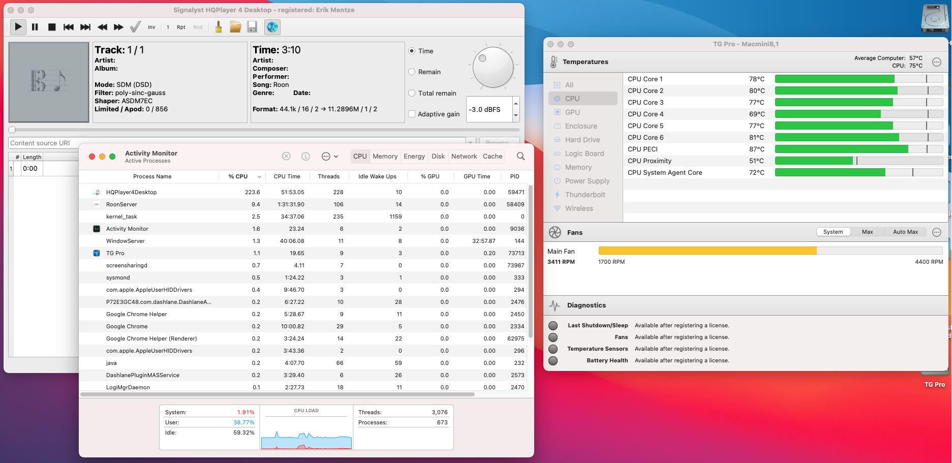

Of course this is all for 16/44.1 content. If I up it to 16X PCM with 7EC I get:
~80C +/-5C, with a case temperature staying at ~40C (maybe needs more time to settle).
On track changes the CPU temp definitely goes to 100C. And if there is any other activity the CPU temp goes to 100C.
7EC is definitely on the edge of usable for me, but as long as the mac isn’t being used by anyone else it seems reasonable.
