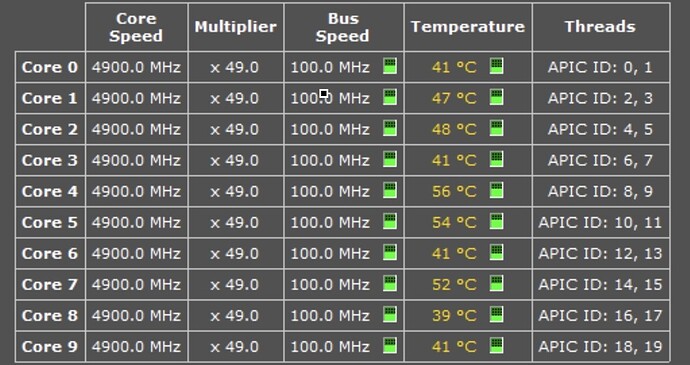

Also, what is your CPU cooling like? Can you monitor CPU temps? Not just average but individual core temps. Although with 8 channels with EC modulators, I imagine average will be high too.

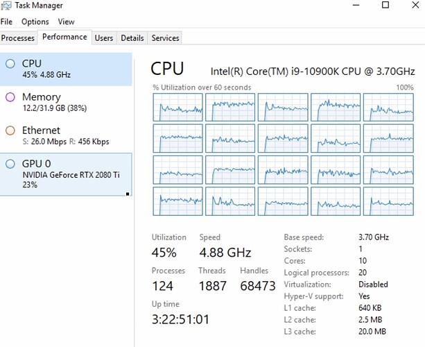

Here’s what it looks like playing the 5.1 version of DSOTM through all 8 channels:

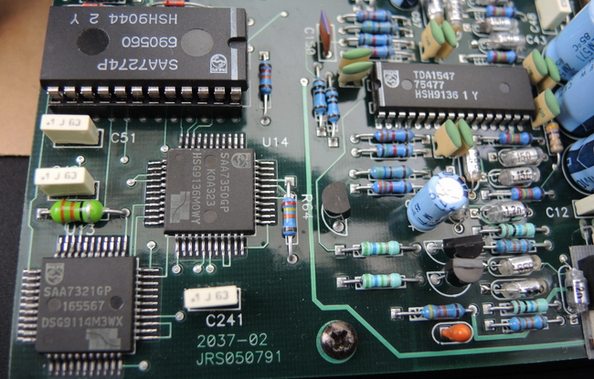

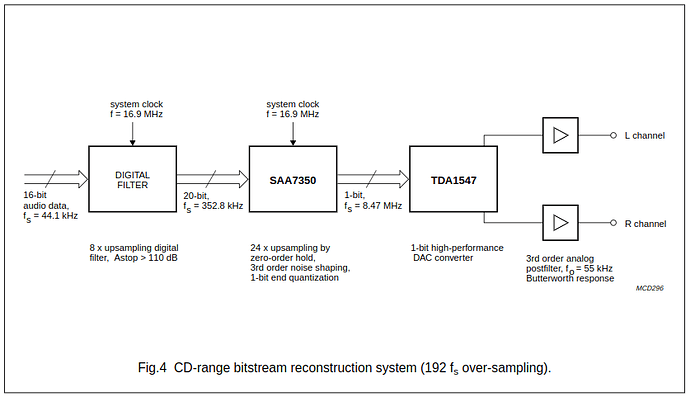

In audiophile configurations it was typically for example SAA7350 modulator chip + TDA1547 1-bit DAC chip (here I believe in a Meridian device):
TB2Ve0ldVXXXXXoXXXXXXXXXXXX_!!80118983
So this combination was running 3rd order modulator with output rate of 8.4672 MHz (44.1k x192):
