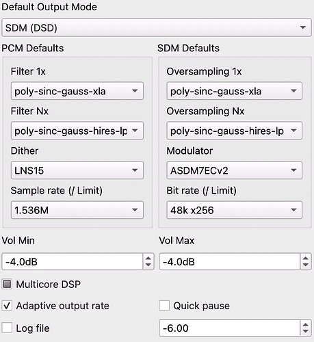

Hello @jussi_laako I have been using HQplayer with the ASDM7ECv2 modulator and my machine only allows the upsampler for DSD up to 128, at 256 it has audio crashes.
It turns out that I noticed higher CPU usage with the multicore box activated (around 50%) compared to the grayed box (around 30%), my question is, should I leave the box checked or grayed out?
[image]
It depends on which one performs better for you. Usually for lower core count machines, leaving it greyed works better.

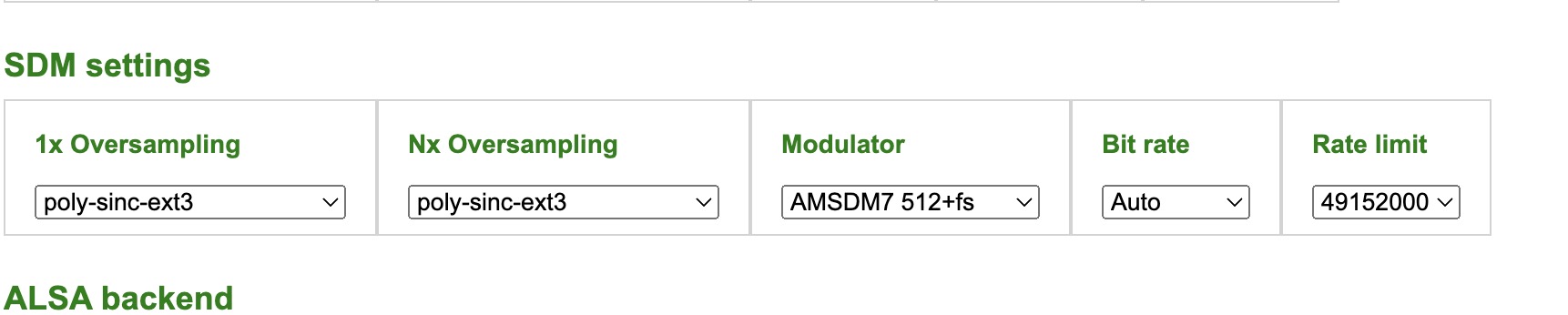

yours is different “512 + fs”, @Moy :slight_smile:
@Rugby speaks about the one with EC! :slight_smile:
AMSDM7 512+fs Special adaptive seventh order “pseudo-multi-bit” modulator optimized for rates ≥ 20 MHz vs AMSDM7EC 512+fs Special adaptive seventh order “pseudo-multi-bit” modulator with extended compensation optimized for rates ≥ 20 MHz
In your case @Moy, I wonder if this is really the modulator or the sound of ext3@1024x48 you like ! :slight_smile:

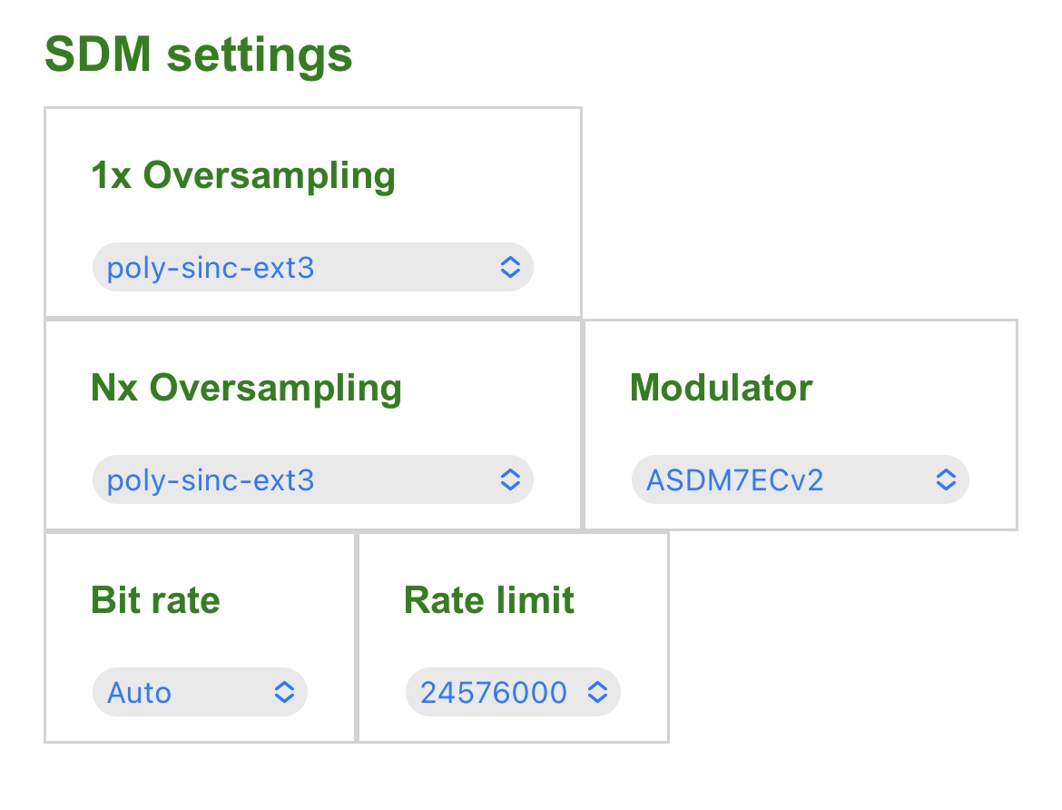

I’m exploring the DSD1024 territory :rofl:
Agreed 7ECv2 is king :prince:!
I’m looking into ext3 on higher rates, but this shaper is the best I can achieve at DSD1024

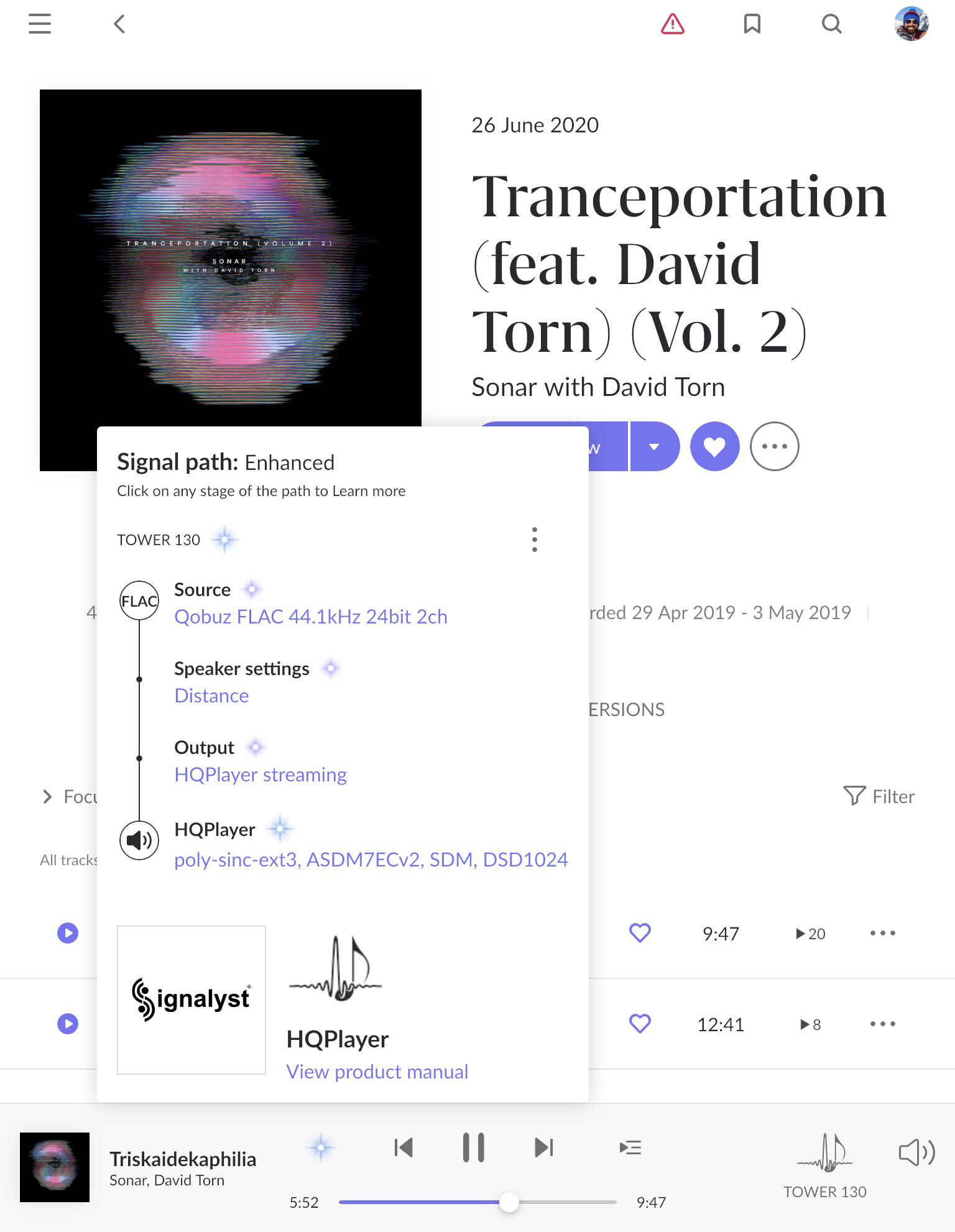

Talking about poly-sinc-ext3… I have not been with this filter for ages, honestly. Got stuck with prog at short-mp which is unbeatable, but…
This! Just knocked me off my chair. I think this record and poly-sinc-ext3 with 7ECv2 is a marriage made in heaven, oh my god!!!
I agree with you!
I have gone back and forth between Sinc-L/Ll (@16-32 million taps) and EXT3 for very different reasons, depending on what I am listening to (and still enjoy both very much). The former gives me a denser, fuller, velvety sound and a more relaxed “musical” experience, while the latter is clearer, more detailed, coherent and full-spectrum (more “analytical” without being harsh). This is in conjunction with 7ECv2 @512. (I wish my Gustard A26 could do DSD1024!)

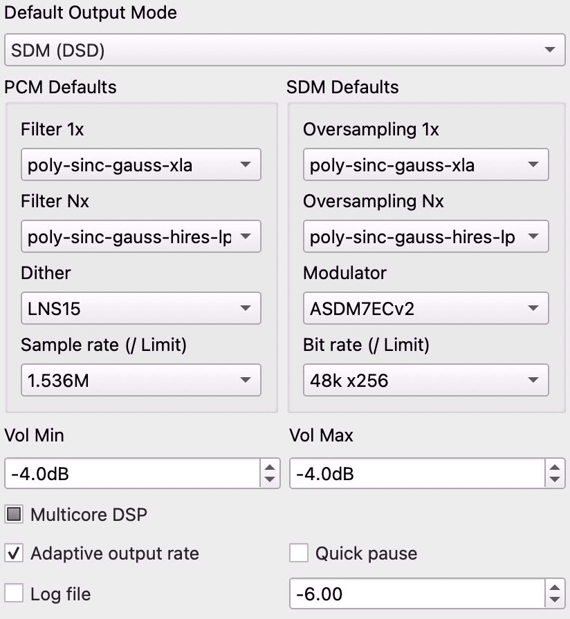

I keep coming back to these settings:
I like your settings, but why -4dB instead of just -3dB? I have always thought -3dB was sufficient.
Oh, that is an artifact from when I regularly played my rip of the Sony “Thriller” SACD. That Sony SACD exceeded SACD published specs and needed an extra dB reduction to not exceed limits. Now I play the MFSL SACD rip instead. But, I am used to that setting now…so I keep it there.
