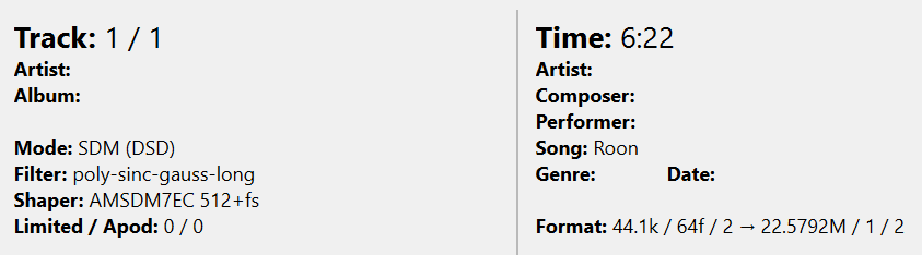

I finally got this combo working on the new version of Hqplayer.
The difference between 256 and 512 on a Holo May is much bigger than expected! For me the most noticable effect is an increase in bass definition. It’s making me consider buying a 13th gen intel to see if 1024 is even better
This is great for headphones. Thanks
Are you sure it’s the switch to DSD512 or rather the choice of the 512+fs filter (vs ECV2) ?
I could try the 512+fs filter at 256 and see how that sounds different, although that modulator is not designed for that rate. Jussi has stated that it’s better to run an EC modulator at 256 than without one at 512, but i’m not completely sure if there are significant differences between the one bit and pseudo multi bit modulators.
