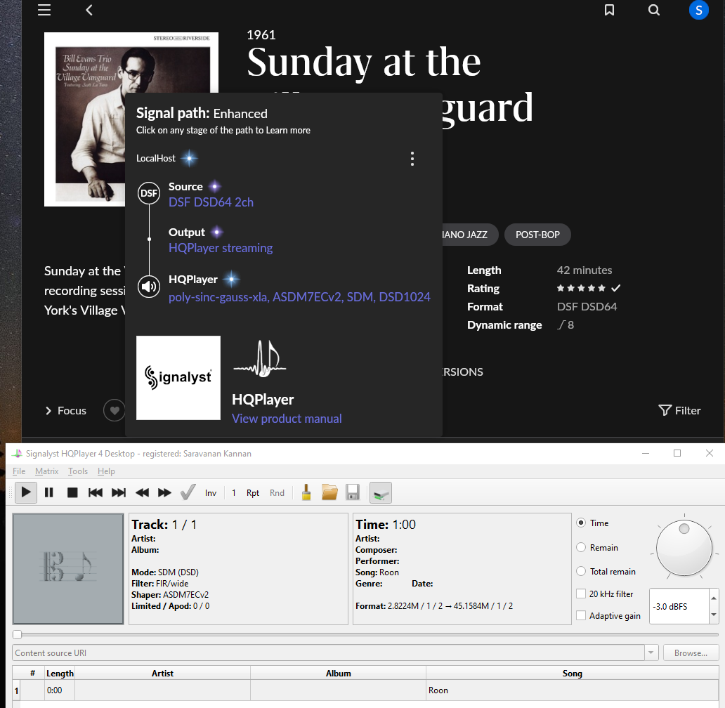

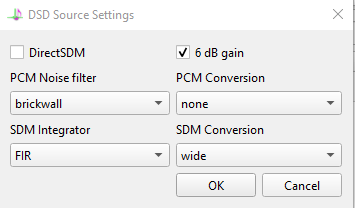

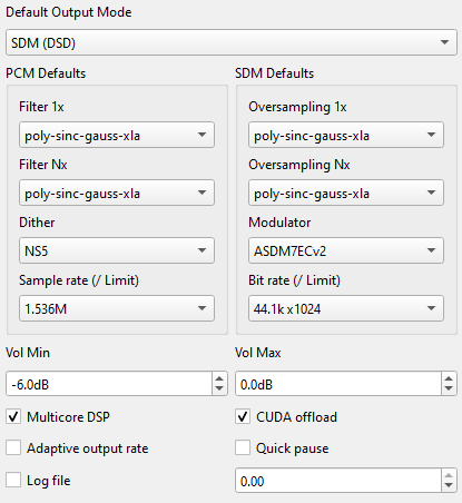

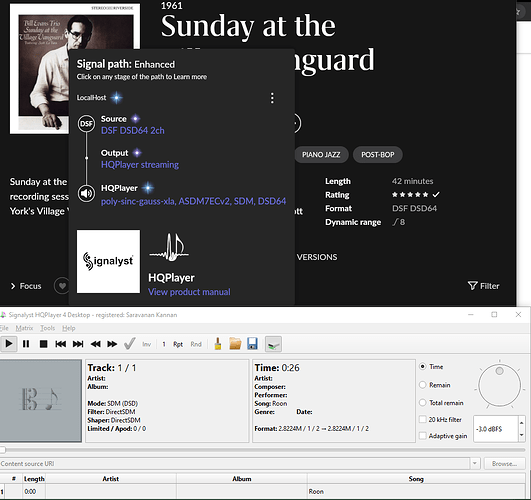

Some of the filters I chose differ from what I see HQ software employing when I play DSD files. Is that expected behavior, or should I change the settings on my computer? Please refer images for more information.
Here you don’t have DirectSDM checked, but HQPlayer main window shows DirectSDM, so those screenshots are not from the same configuration case?
But it could be that Roon doesn’t know how to correctly display status in that case.

Yes. That is correct. DirectSDM screenshot is for the previous scenario and not for this scenario. I agree Roon is reporting the filter set on the “File->settings” window and not from the “DSD Source Settings” window.
