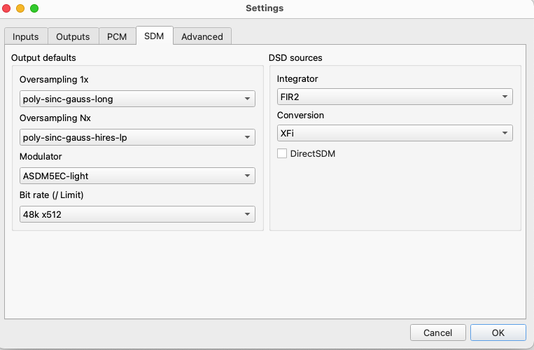

That’s what I’m using on the modulator side. I was just wondering if there would be a certain filter to use with a vinyl rip. For my other listening I’m using poly sinc gauss long and hires lp on nx
That is a good choice for vinyl rips too.
