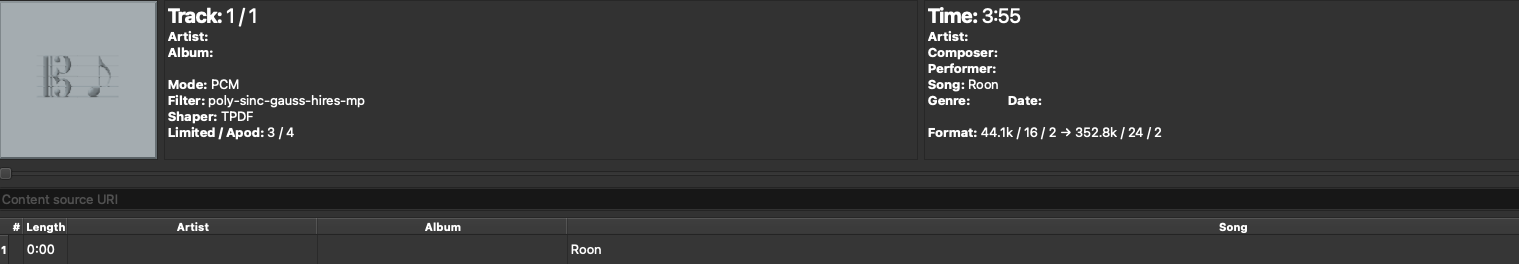

This is the one that I am using, and I think it is smashing:
