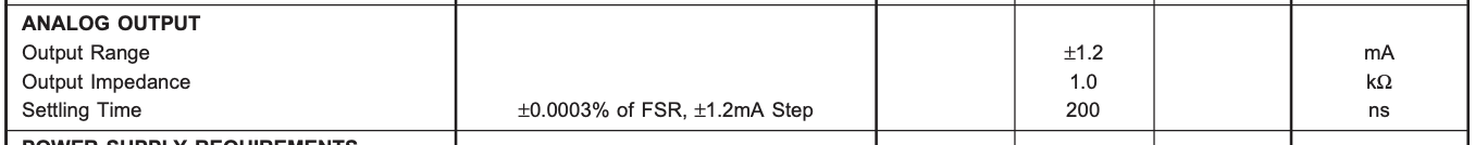

It is not in the measurement suites, because it needs to be measured from the conversion ladder output, before the analog post-filter. This means that you need to open the box and hook to the pins on PCB. But usually DAC chip manufacturers specify it, although not in any easily comparable or consistent way. Last audio PCM ladder chip manufactured was TI/BB PCM1704 and it is specified on the datasheet:
IIRC, there was DAC chip from Analog Devices that was actually accurate to 24-bit, but due to the settling time constrains, the maximum sampling rate was around 0.1 Hz or similar. So essentially designed to provide variable accurate DC reference voltages. Not for audio…

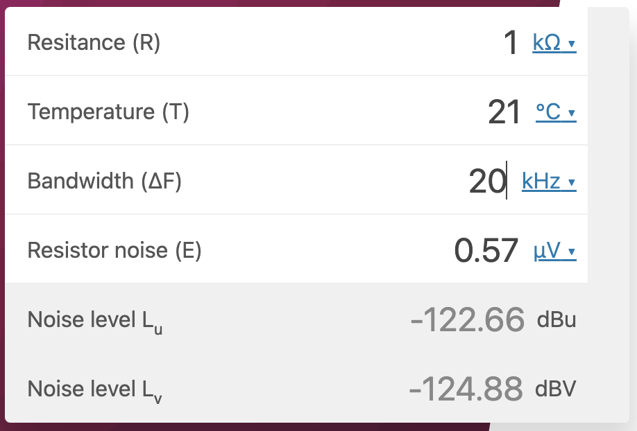

Output impedance there specifies the theoretical maximum dynamic range (level of thermal noise).

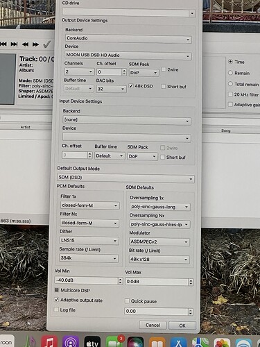

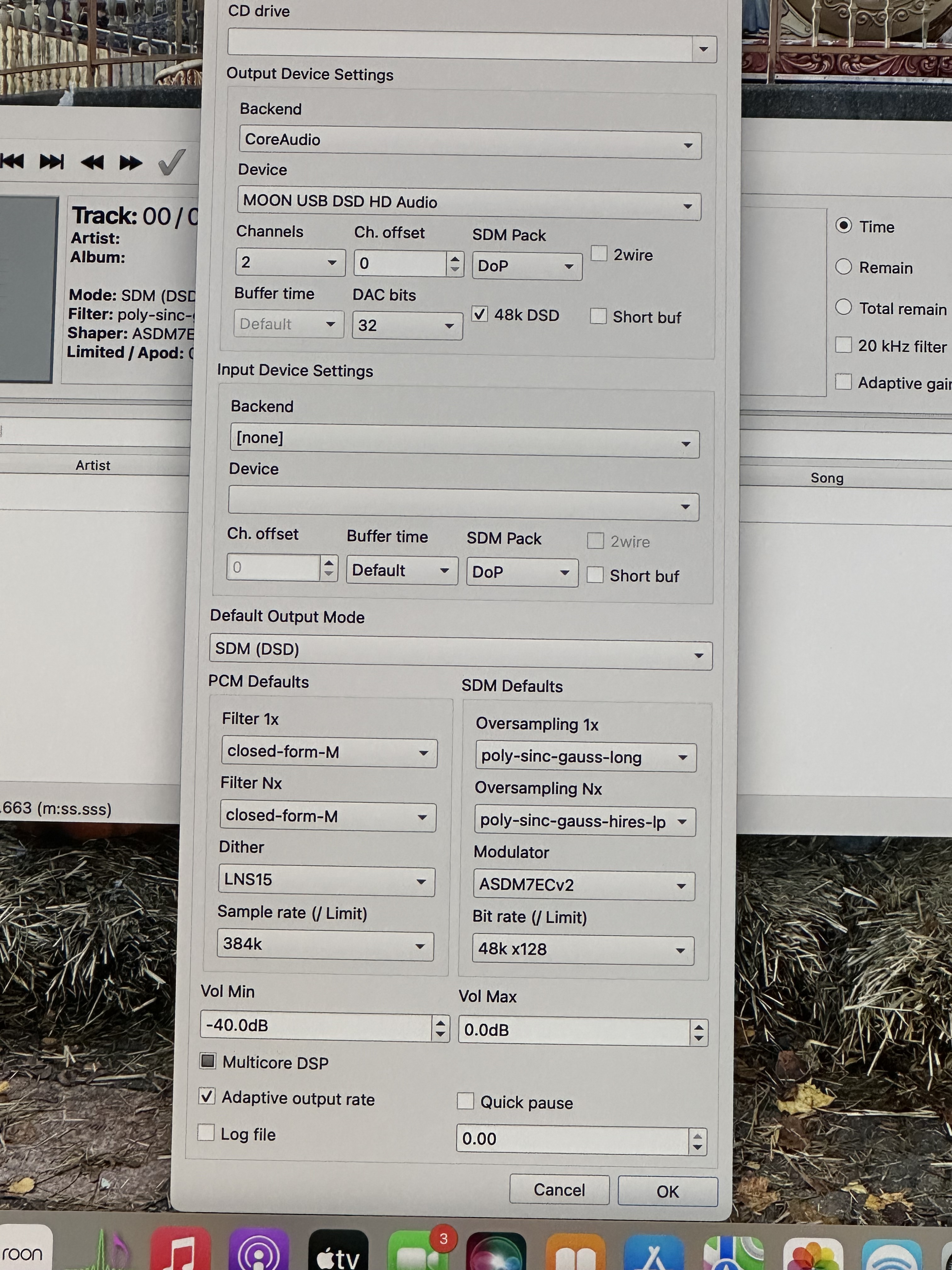

Should i set it to max and then adjust volume in hq player?
That is typical switched resistor ladder volume control. For safety reasons, you could tune the combination. First turn it down and leave HQPlayer volume at -3 dBFS. Then turn the analog volume control up as much as you would ever want to listen. And then dial down from that using HQPlayer volume to comfortable listening volume. If you ever find lacking volume while reaching -3 dBFS on HQPlayer, you can easily turn up the analog volume and then leave it there.
That way you are safe from volume accidents on computers while retaining best possible SNR.
