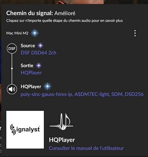

Audio Flux Roon on this song

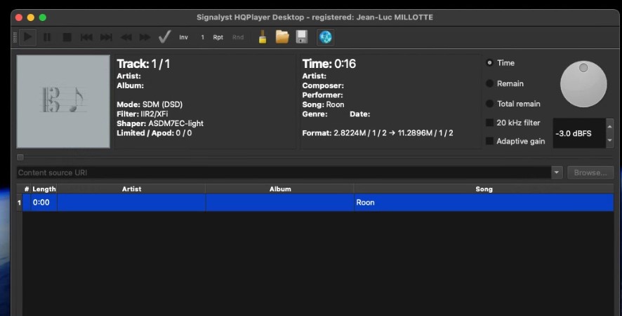

I think L is “Limited” counter. And A is “Apodizing” counter.
Essentially, if L increments, you volume is too high. If A increments, you should be using apodizing filter (if you already are, you are fine).

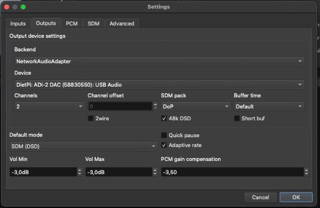

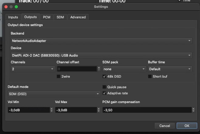

I removed this problem by changing from Dop to none.

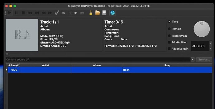

Can you explain a bit more about this, screenshot maybe?
with problem
OUTPUT DOP

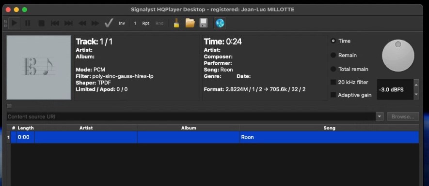

without problem
OUTPUT NONE
The latter one is with PCM output… DSD converted to PCM.

With ADI-2, you need to use DoP to do DSD output.
Indeed, I have to be in DOP for DSD.
