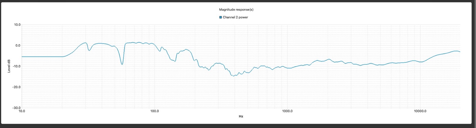

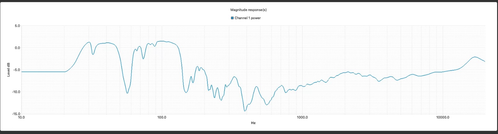

I have a problem understanding convolution curves with HQP.
I use Focus Fidelity software to calculate and generate the curves and I get the L and R curves as shown in the image.
When I put the Wav files generated by Focus Fidelity in HQP (Matrix Pipeline) and when I “plop” the curves, I get curves that are not similar…
Why these differences?
In this case, what to do and what to prioritize? :
  1. I keep the Focus Fidelity curves and I do not take into account the HQP plop curves
    Or
  2. I modify the Focus Fidelity curves manually in order to obtain the desired final curves in HQP Plop
HQPlayer plot shows response of the correction filter. To me it would seem the Focus Fidelity plot is estimated resulting average response in room, not the correction filter itself.
Please note that these have few dB positive gain, so you need to compensate for that using equivalent negative pipeline mix gain. Otherwise you will likely run into limiting.
I don’t see where and how many to see these db on the Focus Fidelity curves, how many do you see?
I did the opposite, I put it on positive otherwise the sound is really weaker otherwise
In conclusion, I understand that we must keep the result produced by Focus Fidelity, is that right?
but it’s surprising to see such big differences.
In the HQPlayer plot, see how many dB it goes over 0 dB line.
And yes, the overall volume will sound lower, because for majority of frequencies it is below 0. But for those frequencies that are above 0 dB you would get heavy limiting if you don’t compensate for that maximum gain boost. It could take a while for music to happen to have close to 0 dBFS at those peak frequencies, but it will eventually happen.
So the only option to compensate for the seemingly lower level is to just crank up your amp’s volume.
Indeed, in HQP it is the response of the correction filter, and which corresponds to the IR gain of Focus Fidelity.
And there, we have the correspondence of these curves.
And I also understood about the db :slight_smile: :slight_smile:
Thank you for the explanations, because I had a big moment of doubt.

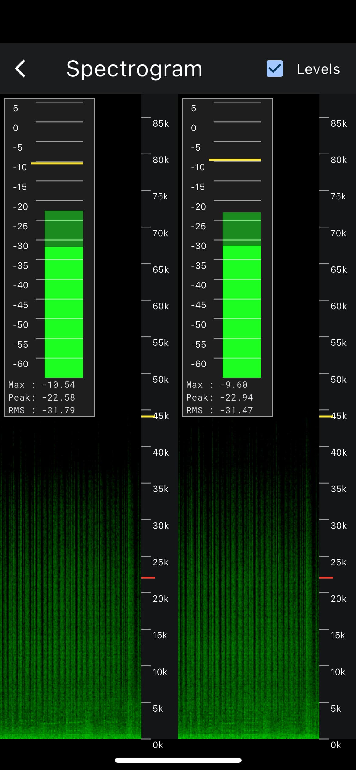

Really good and high-quality new album Trevor Horn - Echoes Modern and Ancient. 192k @ Qobuz. I just can’t get enough!
It doesn’t look like real HiRes to me. There is a hard section at approx. 22kHz, which corresponds to a CD (44.1kHz).
At about 28kHz there is a line, probably from the switching power supply of the ADC.
Dither and some peaks go up to about 48kHz, which would correspond to HiRes of 96kHz. But we’re talking 192kHz here, where the Nyquist frequency is 96kHz!
Other songs in the album are dithered up to 96kHz or not and with the same limited frequency spectrum.
Sorry for trusting fake HiRes! Glad you noticed.
More money for 192khz. I don’t think anyone could tell the difference between this 192khz file and a CD quality download or rip.
Exposed, again.

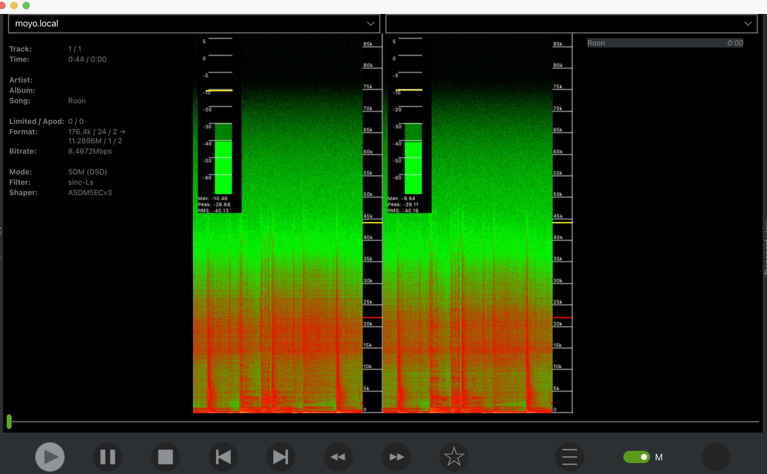

If you do get the 176.4khz file, could you post a pic of the metering output for one of the songs? Just curious. I’m listening to the 16/44 version of this album on Qobuz, sounds good.
Will do if I get it! Still deciding :+1:t2:
Hi!
Showing playing DSD 256 from DAC-60, Desktop client
This is on mobile running using Hqplayer App on higher rates on Embedded Hqplayer
