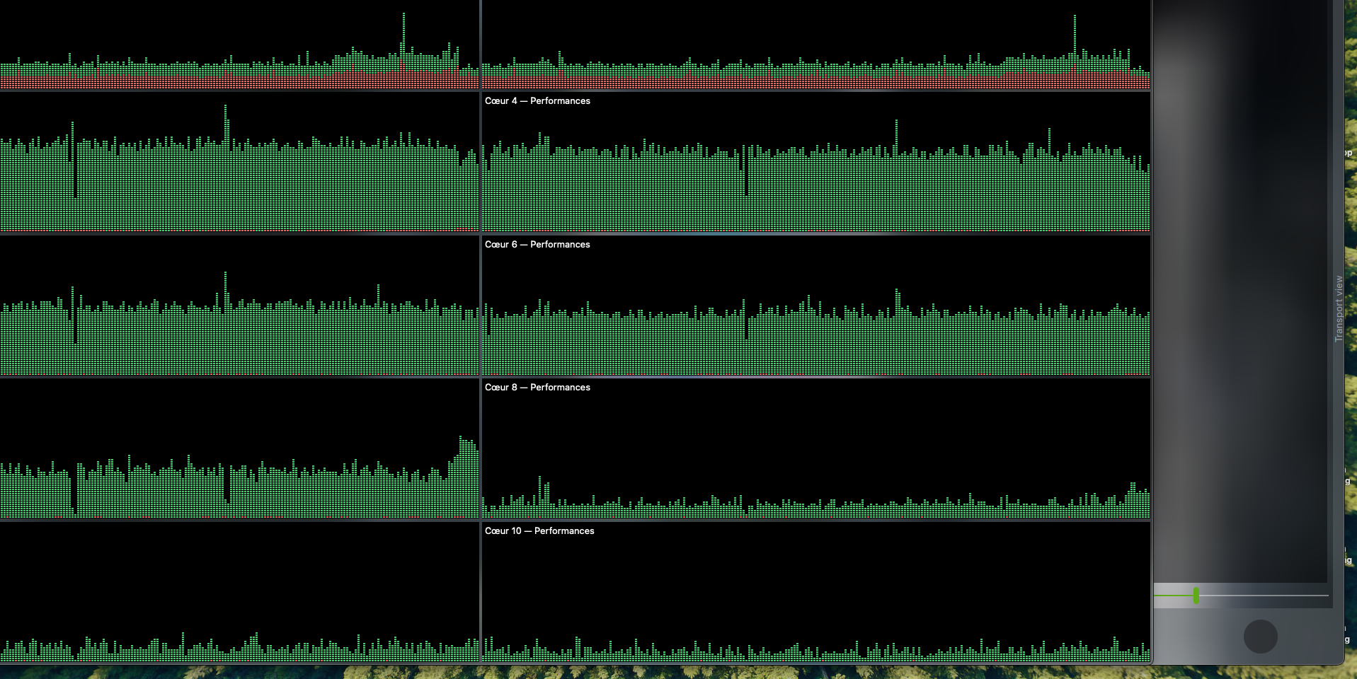

it seems from the drop in the efficiency cores load that you tweaked AHM7EC8B ; yet I still get erratic static. Sometimes I can enjoy gorgeous sound (most relaxed and natural ever) but then static again, most of the time very faint yet disturbing (to know it exists, mainly). What can I do ? number of blocks ? buffer ? etc what can I try ? could my Holo Red or Holo May show defects at that load? Tried with correction NOT enabled, quite a drop in load, in SQ too BTW, but still erratic static, like a clean vinyl that is never digital silent… Is it my Studio Max M1 that doesn’t cope ?

I’m going to try DSD1024 with the ASDM7EC shapers and report, but I’m afraid the Mac Mini won’t handle it

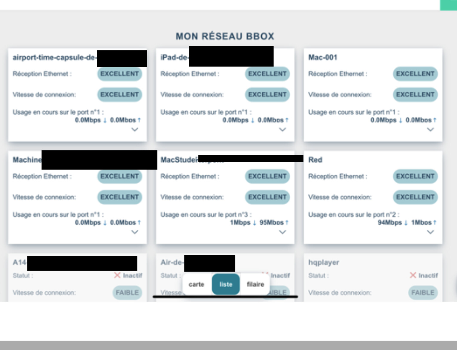

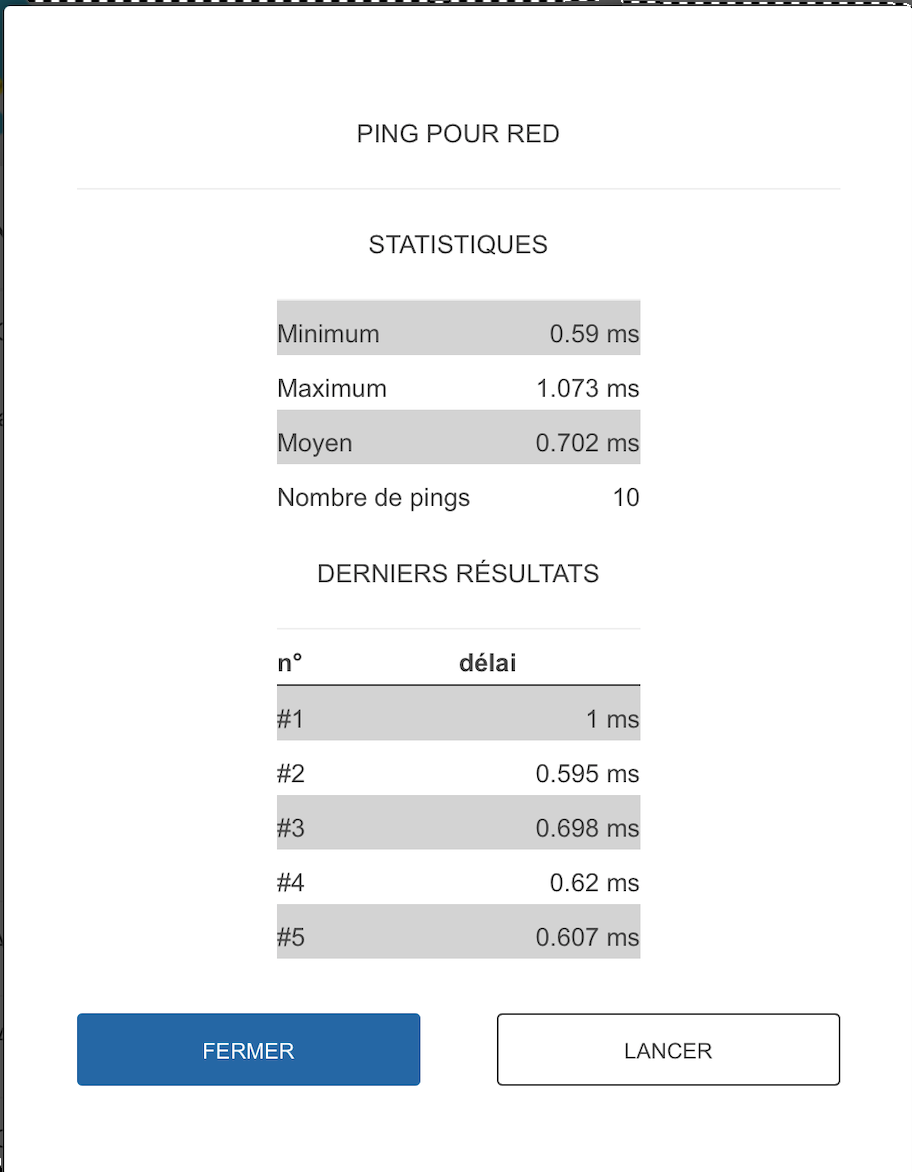

using my MBP in screen sharing I launched PINGS from Studio’s Terminal
0% loss for RED, MB Air wifi connected and behind a VPN, wifi connected iPad, Time Capsule
100% loss (timeout) for the MBP (wifi) the Studio, and a what is it “Mac”
62 % loss (a window of work amidst timeout) for my iPhone
is it enlighting (for you) ? a firewall issue ?

PS ping issues came from active stealth mode preventing pings. 0% packet loss when unchecked
HQPlayer OS appears as “hqplayer” device…

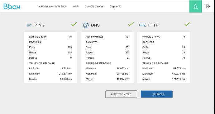

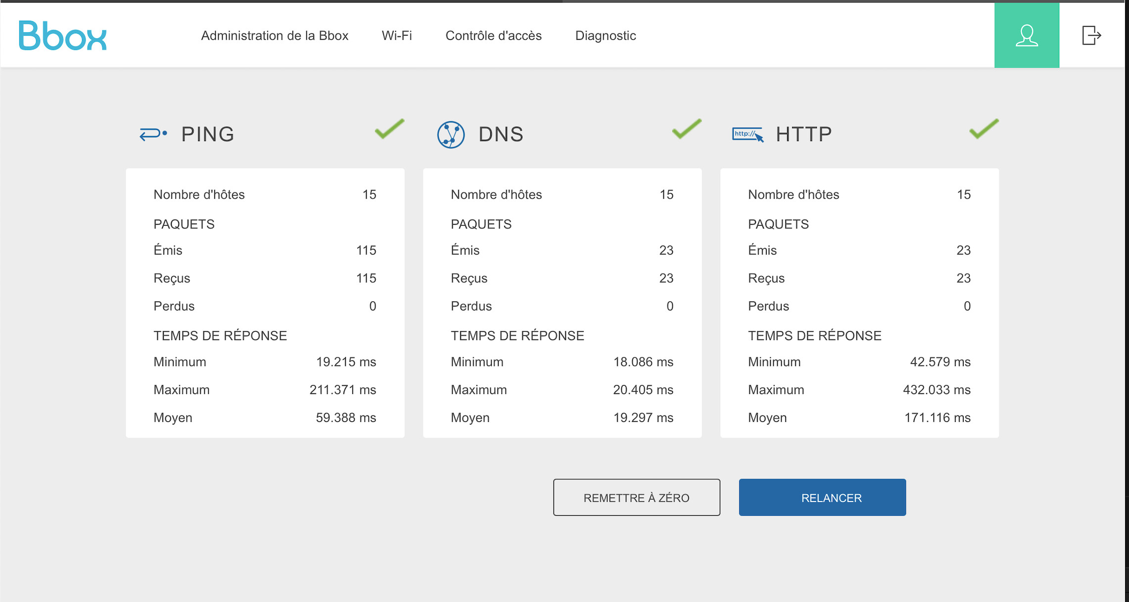

These kind of things shouldn’t exist within home network between devices. It means something more than a plain switch in the middle. But your screenshots look more like internet side things which are not important here.
