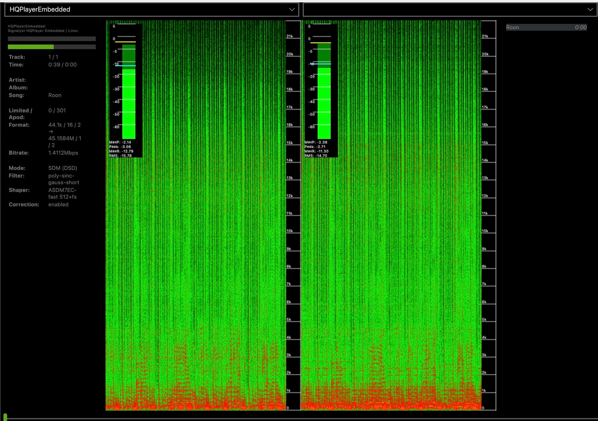

Version: 5.15.2 Embedded
poly-sinc-gauss-short
ASDM7EC-fast 512+fs
Dac Correction: Enabled
44.1k / 16 / 2 → 45.1584M / 1 /2
Amazing, able to do DSD 1024x48 option again with DAC correction enabled!

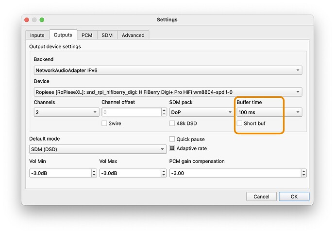

My HQP desktop 5.15.2 setup on a Mac mini M4 and NAA 5.17 on an RPI CM4
Increase buffer time to 250 ms. Check if improve the performance
